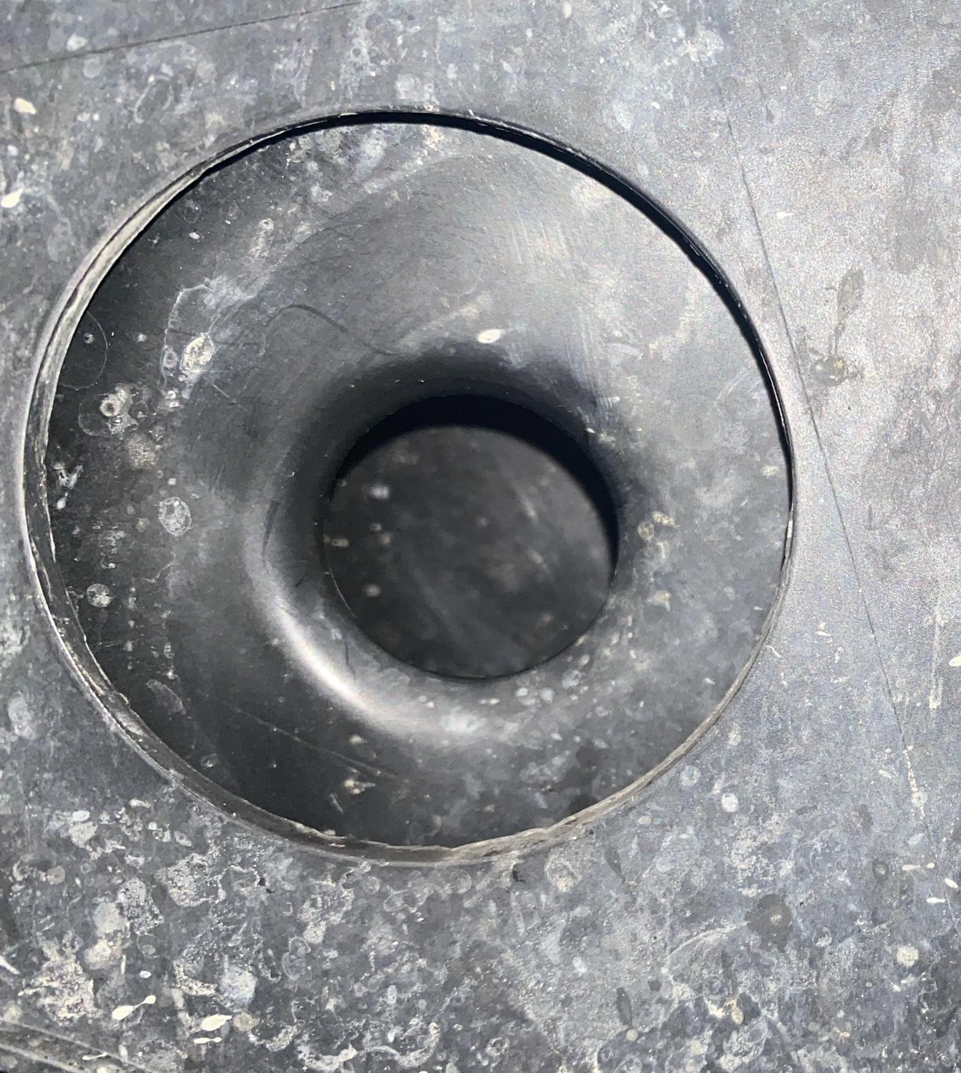

There is an older post that is closed, trying to revive the question. The pic below shows one of the 2 holes in the front (the old post had some discussion on their use but didn't answer the question). The Ford instructions tell you NOT to use chains, cables or straps "WITH METAL HOOK ENDS"!
Can anyone shed light on what is to be used, that is not metal, to tow a hybrid Maverick when stuck?

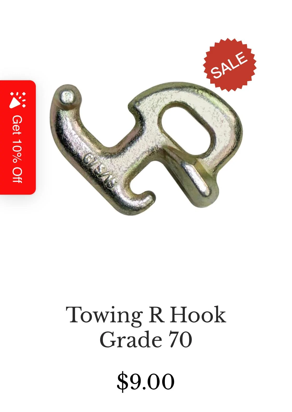

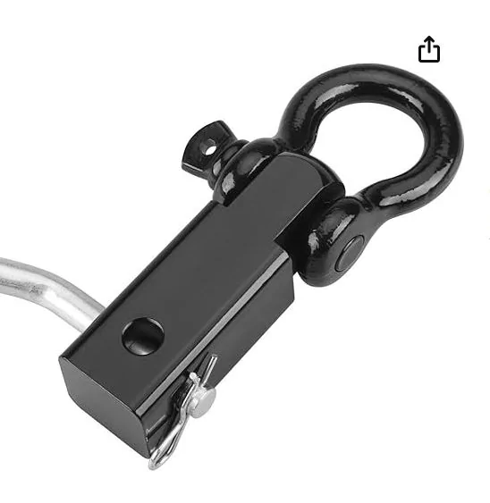

You need to get one of these shockingly inexpensive specially designed devices that goes into the specially designed hole.
EDIT: THIS EXACT ONE IS TOO LARGE.
I ORDERED AND IT DOES NOT FIT.
CLOSE, but no cigar

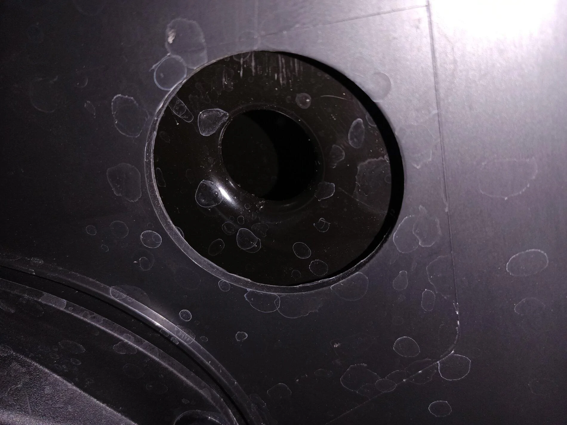

Ford Maverick Maverick Hybrid recovery points, what to do when stuck? IMG_8988
HOOK ABOVE IS TOO LARGE OR HOLE BELOW IS TOO SMALL. I STILL LIKE THIS CONCEPT.
Ford Maverick Maverick Hybrid recovery points, what to do when stuck? IMG_8987

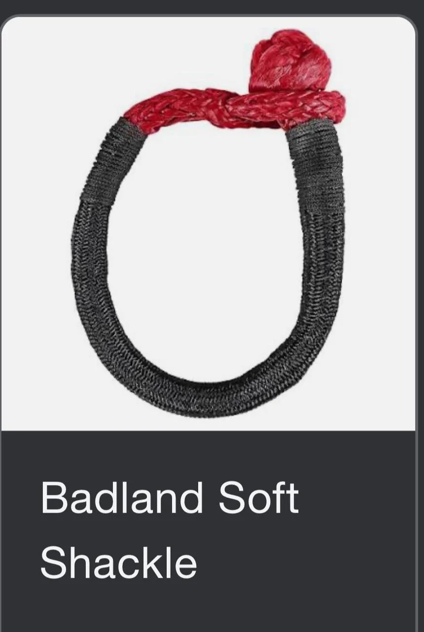

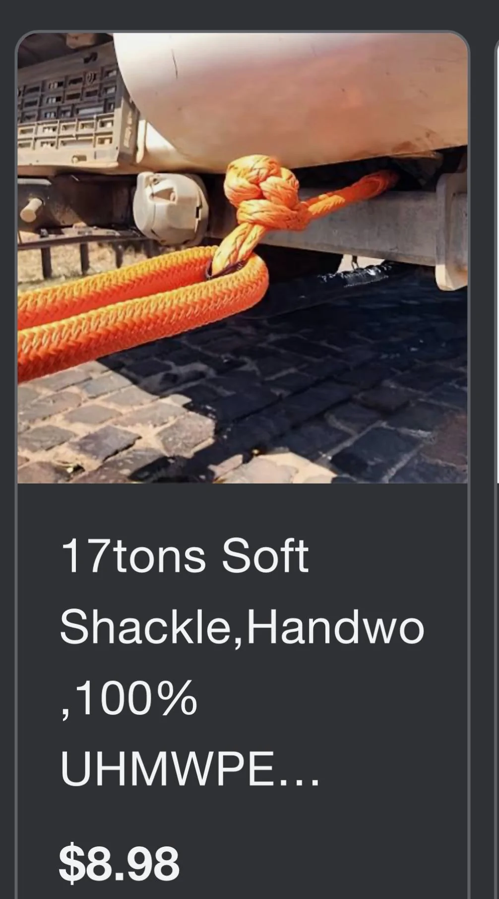

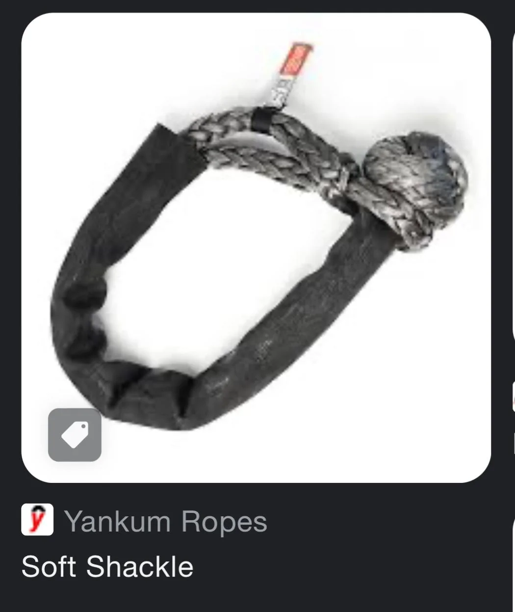

Fourth, use the "soft shackle" of your choice to attach soft tow strap of your choice.
Ford Maverick Maverick Hybrid recovery points, what to do when stuck? IMG_8992
Ford Maverick Maverick Hybrid recovery points, what to do when stuck? IMG_8989
Ford Maverick Maverick Hybrid recovery points, what to do when stuck? IMG_8990
You're welcome.
