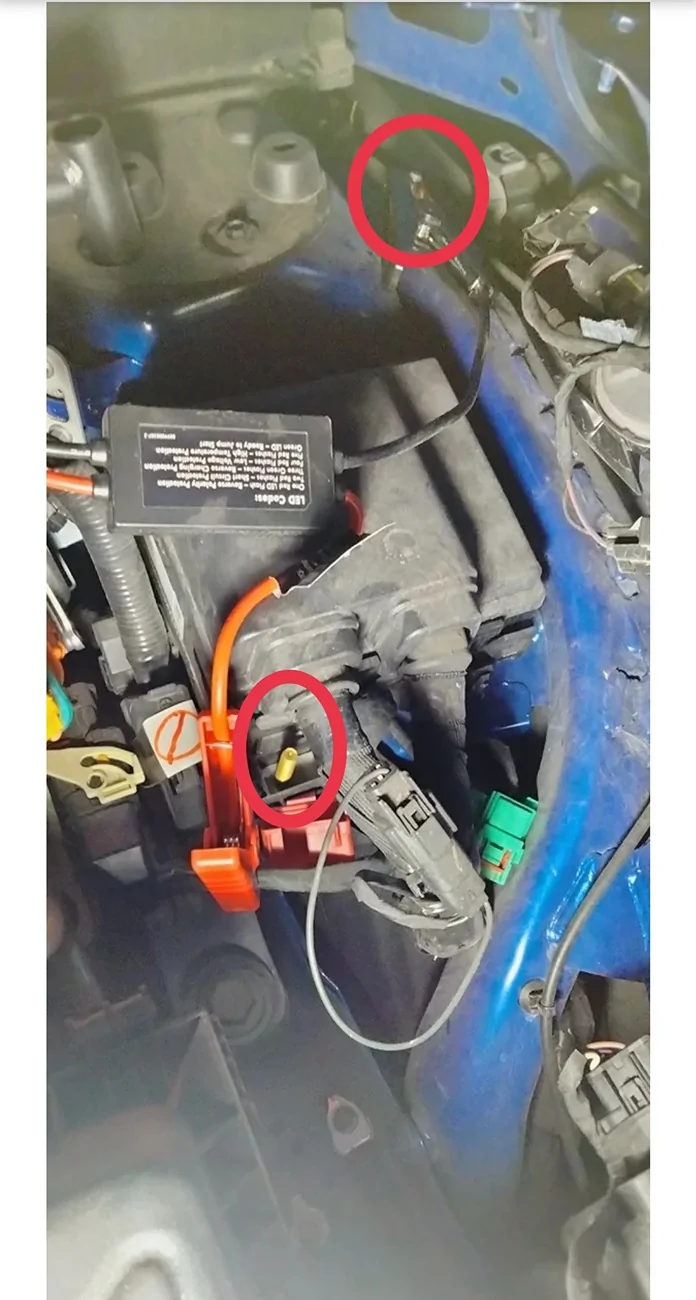

Jump points can be at the battery under the back seat passenger side, or driver side under the hood, positive is under a red plastic flap, negative is on the other side of the black box the flap is on, on the fender, looks like a tower nut.

Hybrid connection points.

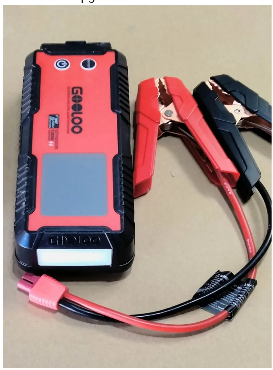

If you can afford it this is definitely a good choice👇👇
After I a bought lithium-ion jump pack. That needs to be charged occasionally. I found out about.

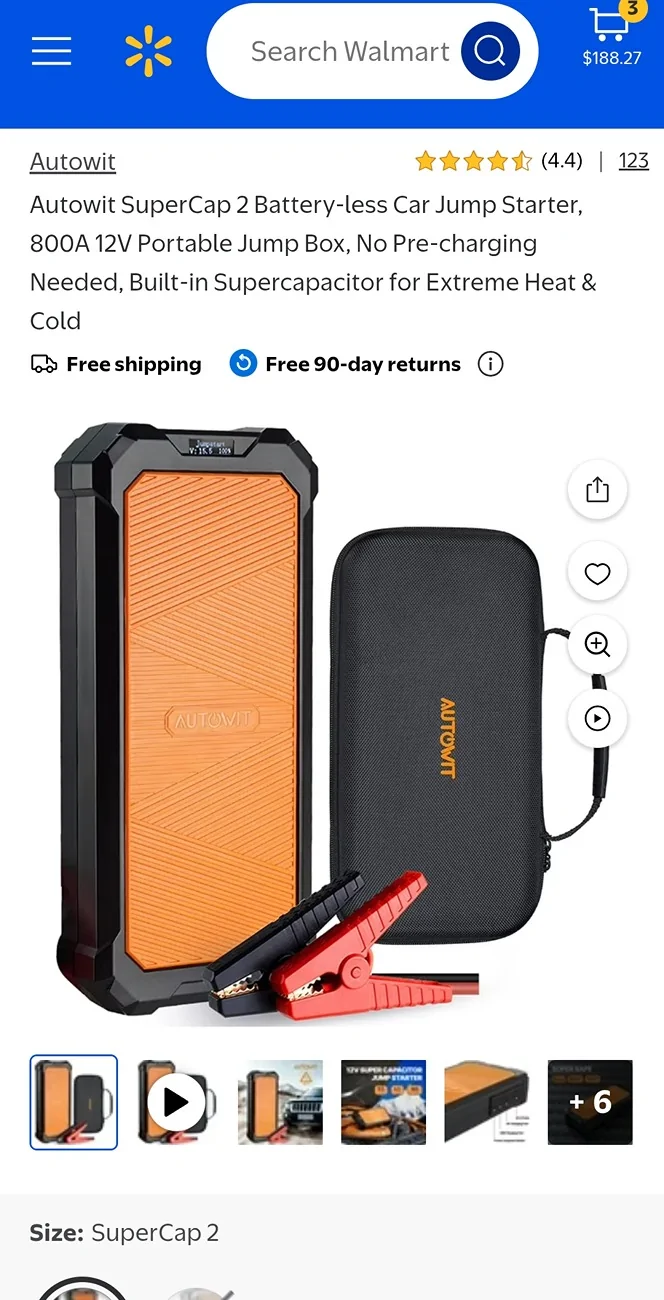

Maintenance free super capacitor jump pack.
My neighbor bought one to use on a 1987 Mercedes his wife won't sell. As long as there's a breath of power in the vehicles, battery you may have to wait 20 minutes but it'll start the car.
$109
OR
Lithium ion jump pack. $109

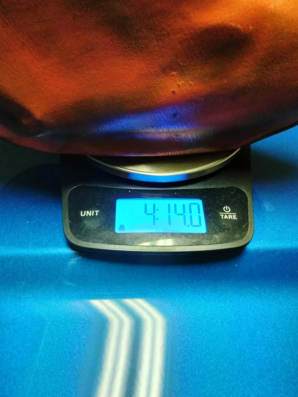

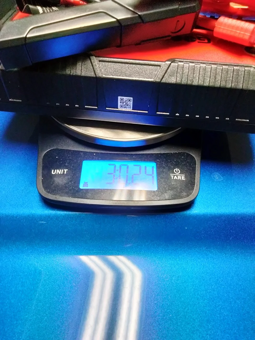

The difference between my jump pack and my jumper cables is roughly a pound. I carry both so it really doesn't save me anything 🤣🤣
Ford Maverick Maverick Hybrid as Booster Vehicle? IMG20260616190932
Ford Maverick Maverick Hybrid as Booster Vehicle? IMG20260616191053

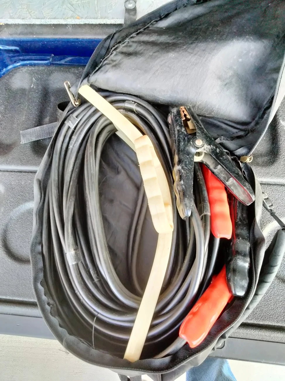

That all being said, I've got 25 ft long jumper cables, that were custom made for me. They weigh way a little bit more.
Ford Maverick Maverick Hybrid as Booster Vehicle? IMG20260616191739
