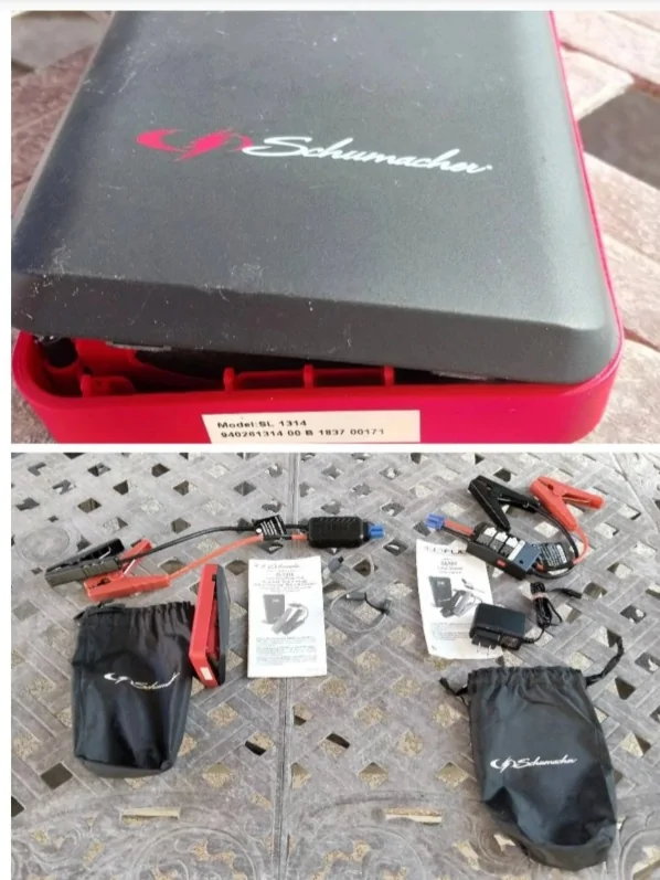

Probably a good thing you left your Schumacher out in the rain.
I quit buying Schumacher after the second one split its case when the battery expanded. I sent the first one in for warranty and I'll be darned if it didn't happen again.
