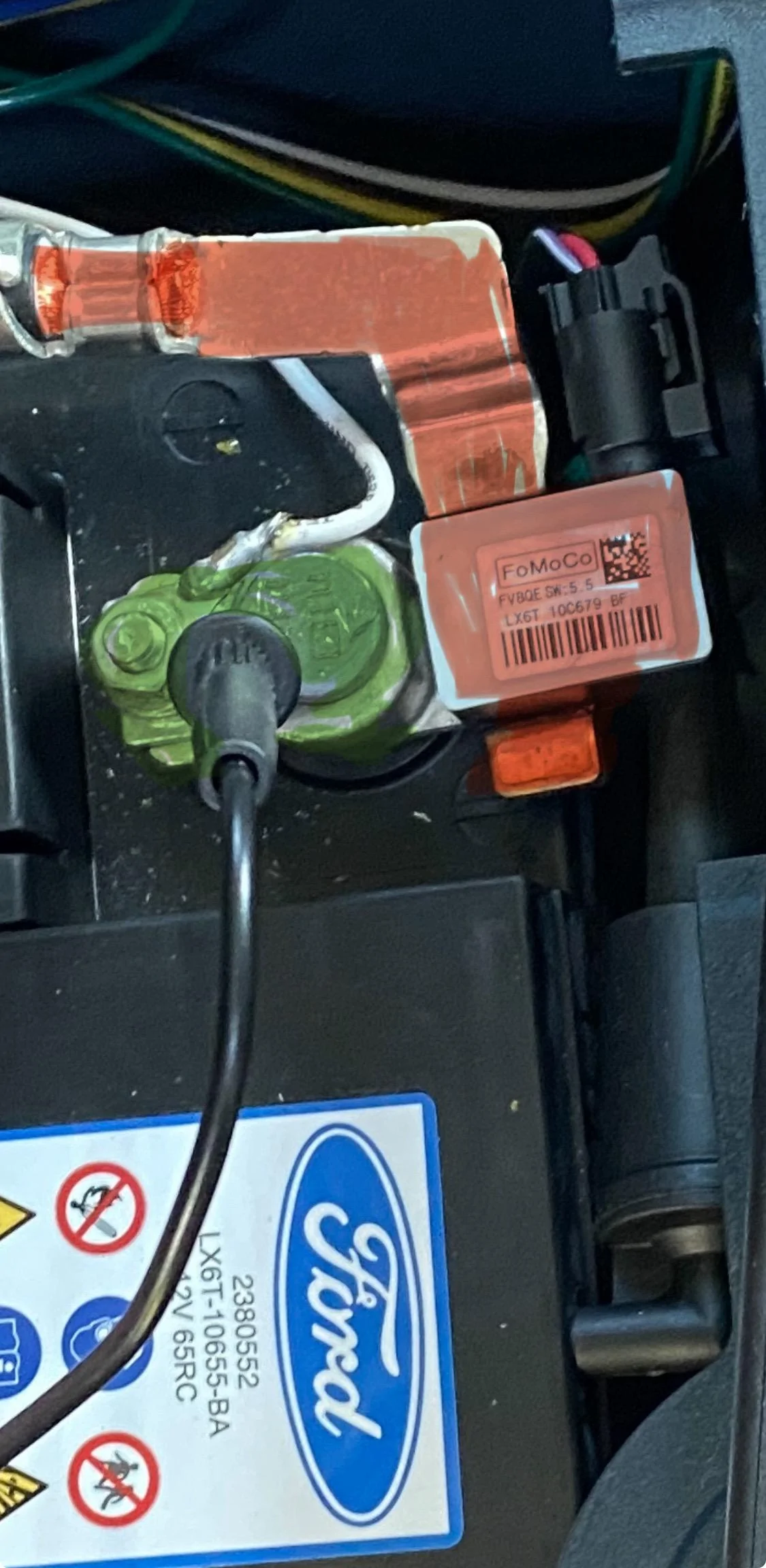

Do not jump another vehicle with your Hybrid. Get/keep a jump box for jumping other vehicles, or yours. Keep it in the storage bin under the back seat. Take it out about twice a year and charge it.
IF you need to jump your Hybrid, only do it from the Jump Point under the hood, located under the red plastic cover on the driver's side. The Negative clamp goes to the bare metal bolt on the wheelwell, also on the driver's side under the hood.
Never connect anything directly to the 12v battery under the seat.
