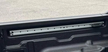

Sorry for my delay. Here are some pictures of the full rail and the two trouble spots.
Very helpful post, will be doing something similar. Thank you.
FYI, There are some sources of L-Track that don't have pre-drilled holes.
* How many holes are there on each side of the bed? There are 8mm & 6mm?
* Did you remove any fittings or were the bold holes all empty?

The pre-drilled holes weren't really the problem although it would probably look cleaner without them. The problem was needing to use the factory hole points which don't line up with the round openings along the rail.
I think it was 4 8mm holes (which were empty) and then 2 6mm holes where the factory tie down is. I removed the factory tie down and moved it to the top of the back of the bed since the XL only came with one back there on the bottom.

I just completed this, except for the eye bolts which I should receive on Saturday. I used the half depth struts instead of the square type in the video. M9 screws work for the bed itself. The hardest part was cutting the struts but it is very solid once installed.

I fit 36 of rail in without removing the stock hook, could probably get another 4-5 inches in without the factory hooks.
