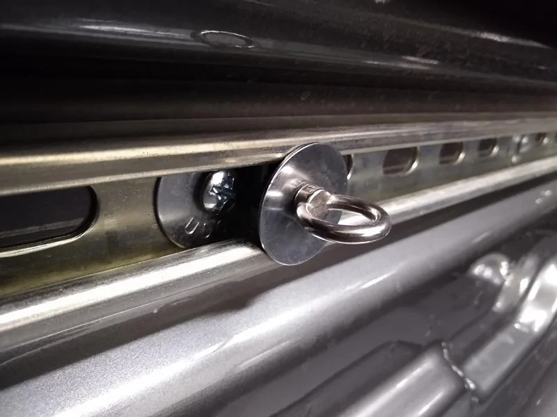

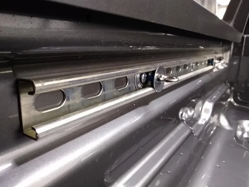

I just completed this, except for the eye bolts which I should receive on Saturday. I used the half depth struts instead of the square type in the video. M9 screws work for the bed itself. The hardest part was cutting the struts but it is very solid once installed.
Very cool, I was also looking at smaller depth unistrut (closer to the factory depth rails). If you have pictures I would love to see how it looks. I am debating removing the front tie downs to extend the rail all the way forward, and all the way rearward picking up all the M6 and M8 holes I can.

It's funny how I see unistrut sticking out of dumpsters all over the place until I want some. Anyway, it's solid and looks pretty clean.

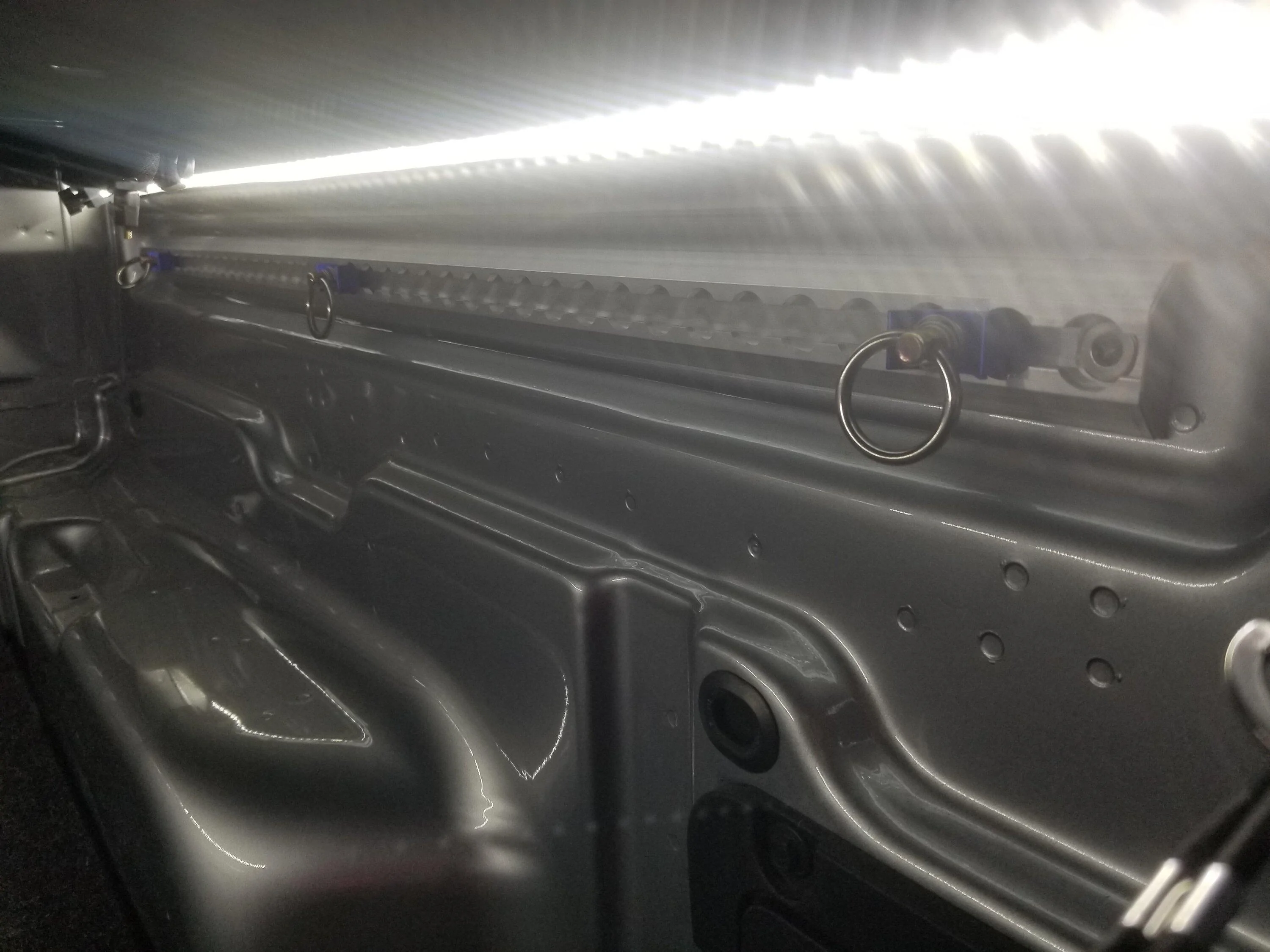

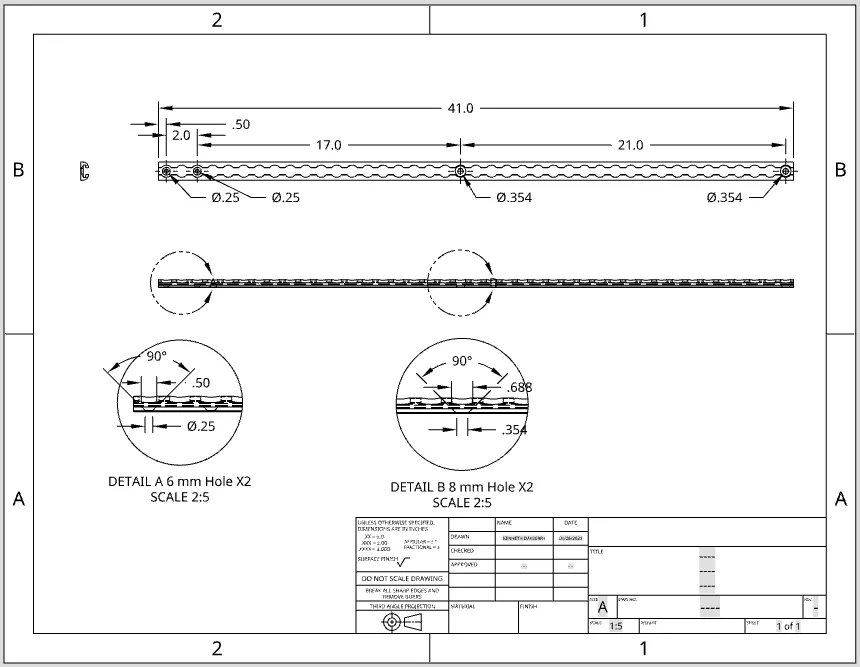

I ended up doing this setup with undrilled surface mount aircraft logistics track. I made the first logistics tracks to fit these trucks with just this spacing and ignoring the other threaded holes that arent 1" on center and not inline. Afterwards somebody came up with a nice drawing of the spacing I used. I used a 90° countersink. Front 2 holes are M6, the middle and aft hole are M8. I used stainless steel torx bolts. The tie down loops came from evilbay.
The reason for using just this bolt spacing is logistics track hole centers are 1" spacing on center. These 4 threaded holes per side are the only holes on that truck bed that offer the 1" on center hole spacing. It works fine, allows all the lugs to be used, and wont be a hacked up mess like the pic shown on the previous pages with L track.

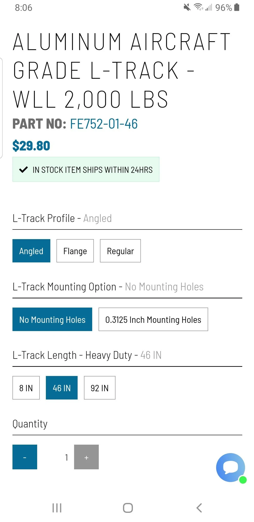

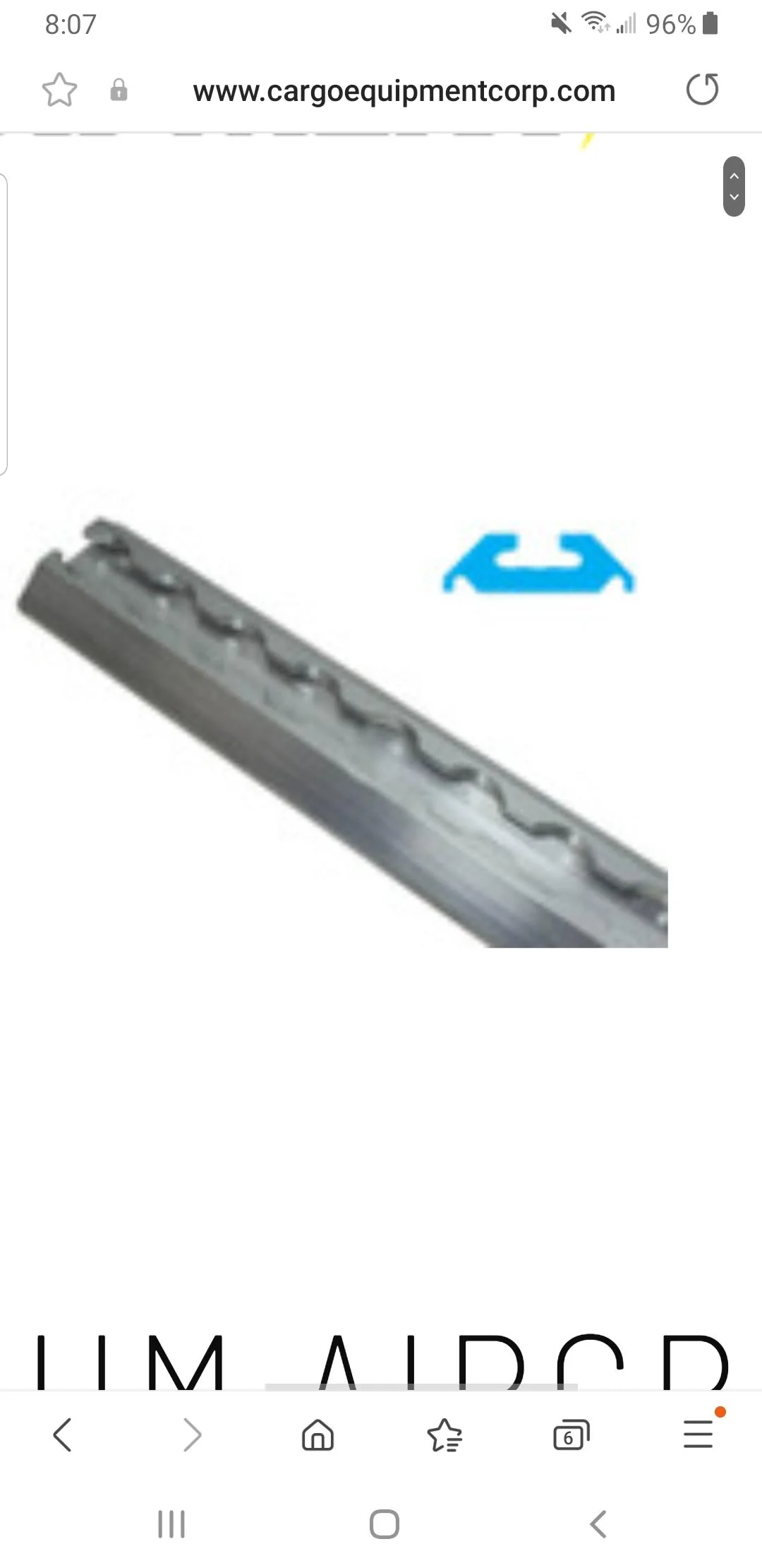

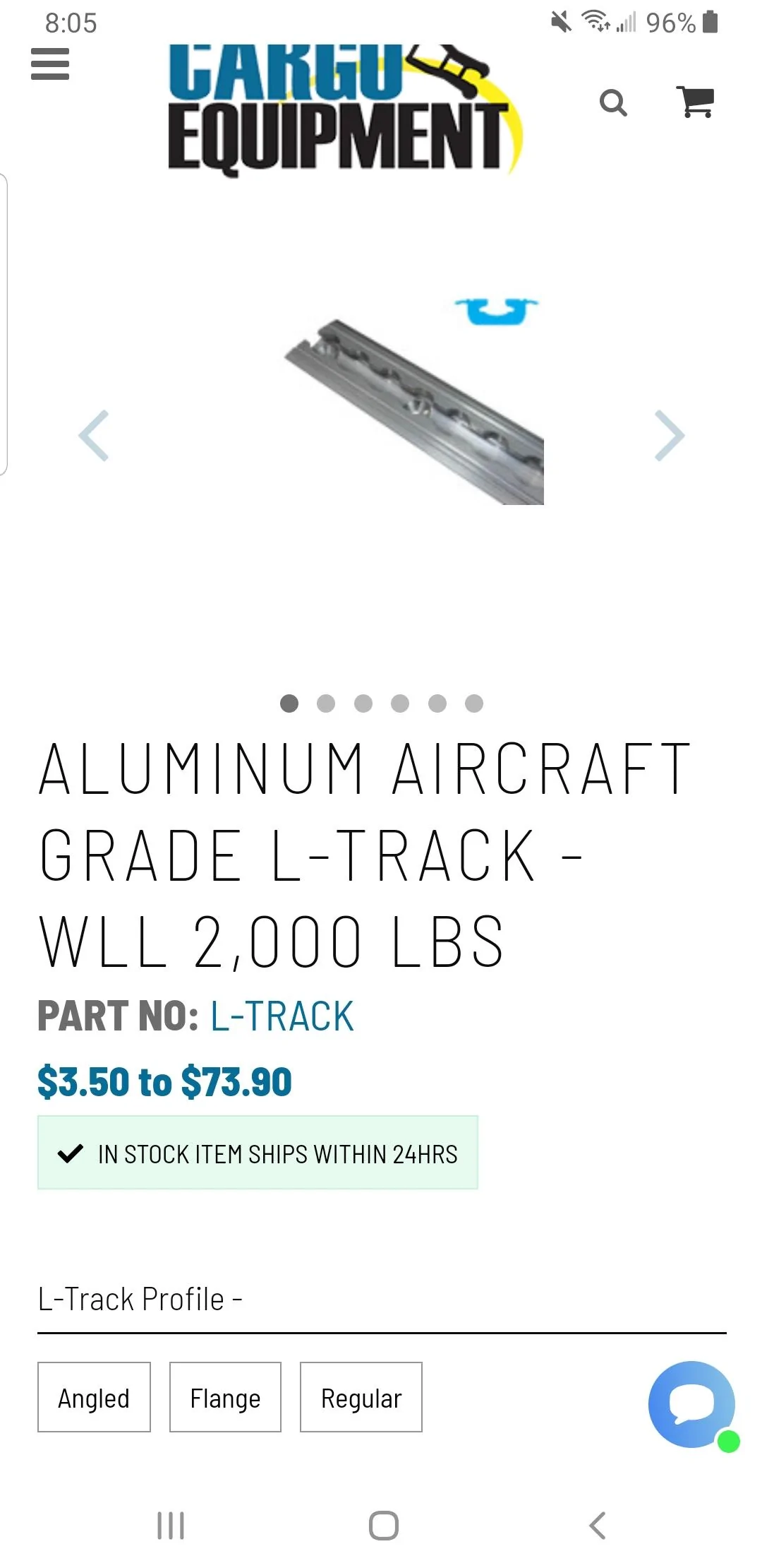

Track is from www.cargoequipmentcorp.com I ordered the 48" length surface mount undrilled tracks. This way I put the holes only where I wanted them. I had to cut I think 5" off one end to make them the right length. Tracks are $29 each plus shipping. Rated at 2,000 lbs pull, you will collapse the bed before these fail.
The end cap shown in my pic is 1 of 8 pieces I custom made from .040" stainless steel to cap off the track ends. I gave the other set to my friend.
Since the round lug holes in the tracks are 1 inch on center, it's easy enough to count the circles to where you need to drill, center up on the Circle and drill through. The lug holes are 1" on center hole to hole, but the circles themselves are 3/4" . For this reason I recommend a drill press and drill press vise.

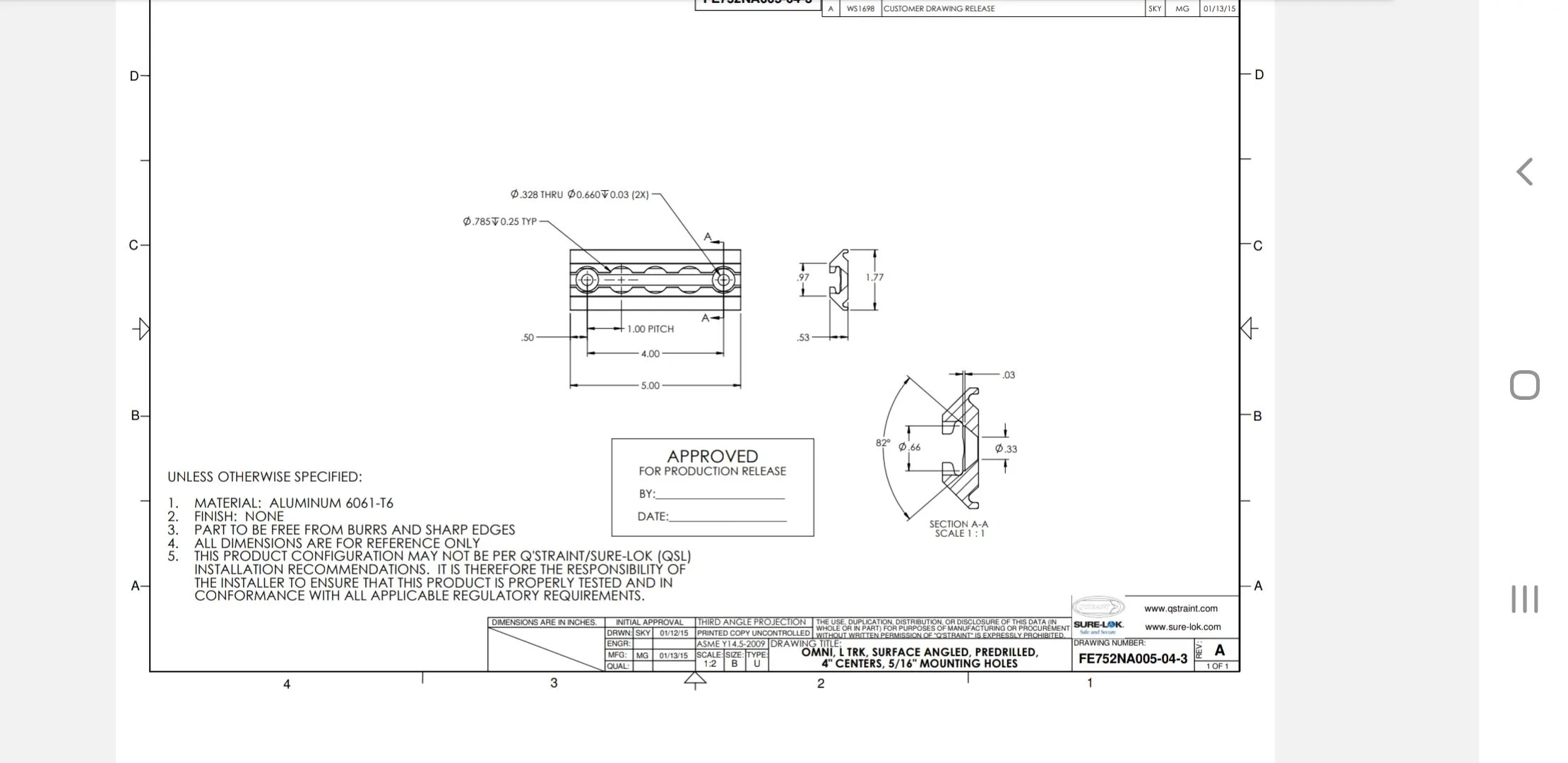

I work in aviation sheetmetal fabrication for a living, however I think if you have access to a drill press, you can do this. See specs below.
Ford Maverick Make your own Maverick bed tie-downs: DIY bed side rail tutorial by Ford Screenshot_20230317-080532_Samsung Internet
Ford Maverick Make your own Maverick bed tie-downs: DIY bed side rail tutorial by Ford Screenshot_20230317-080602_Samsung Internet
Ford Maverick Make your own Maverick bed tie-downs: DIY bed side rail tutorial by Ford Screenshot_20230317-080641_Driv
Ford Maverick Make your own Maverick bed tie-downs: DIY bed side rail tutorial by Ford Screenshot_20230317-080715_Samsung Internet
