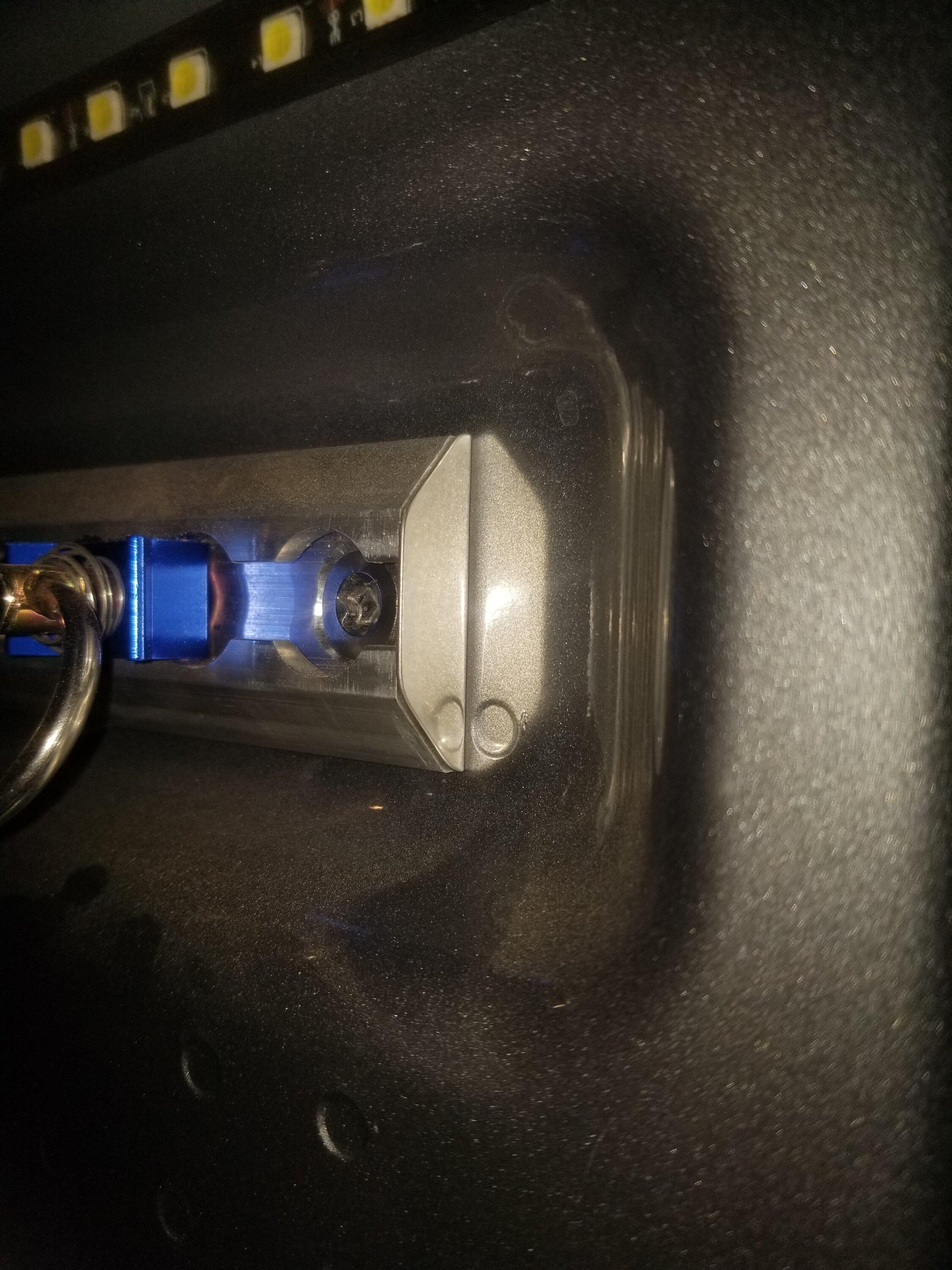

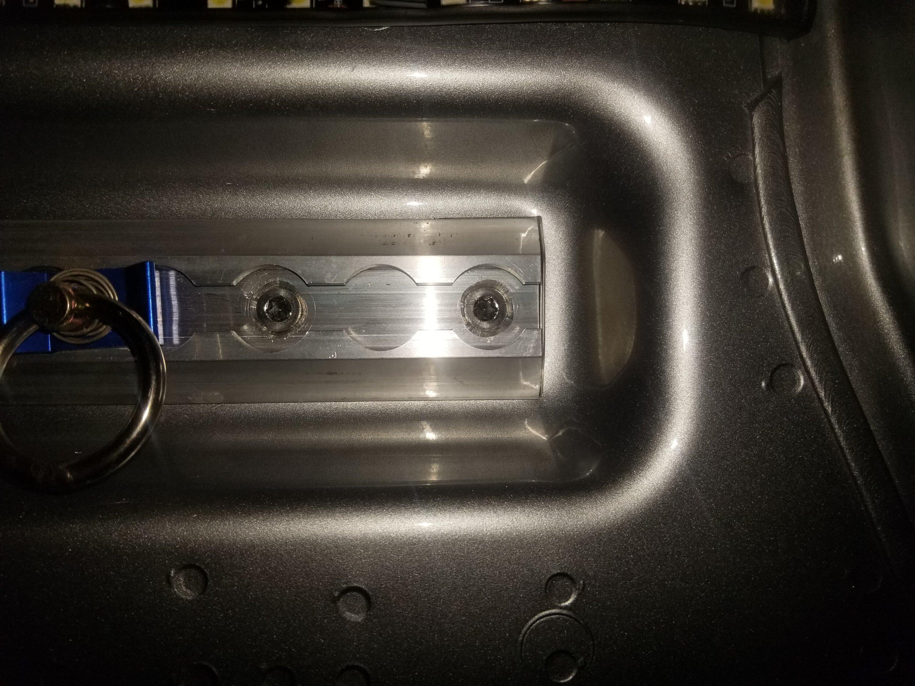

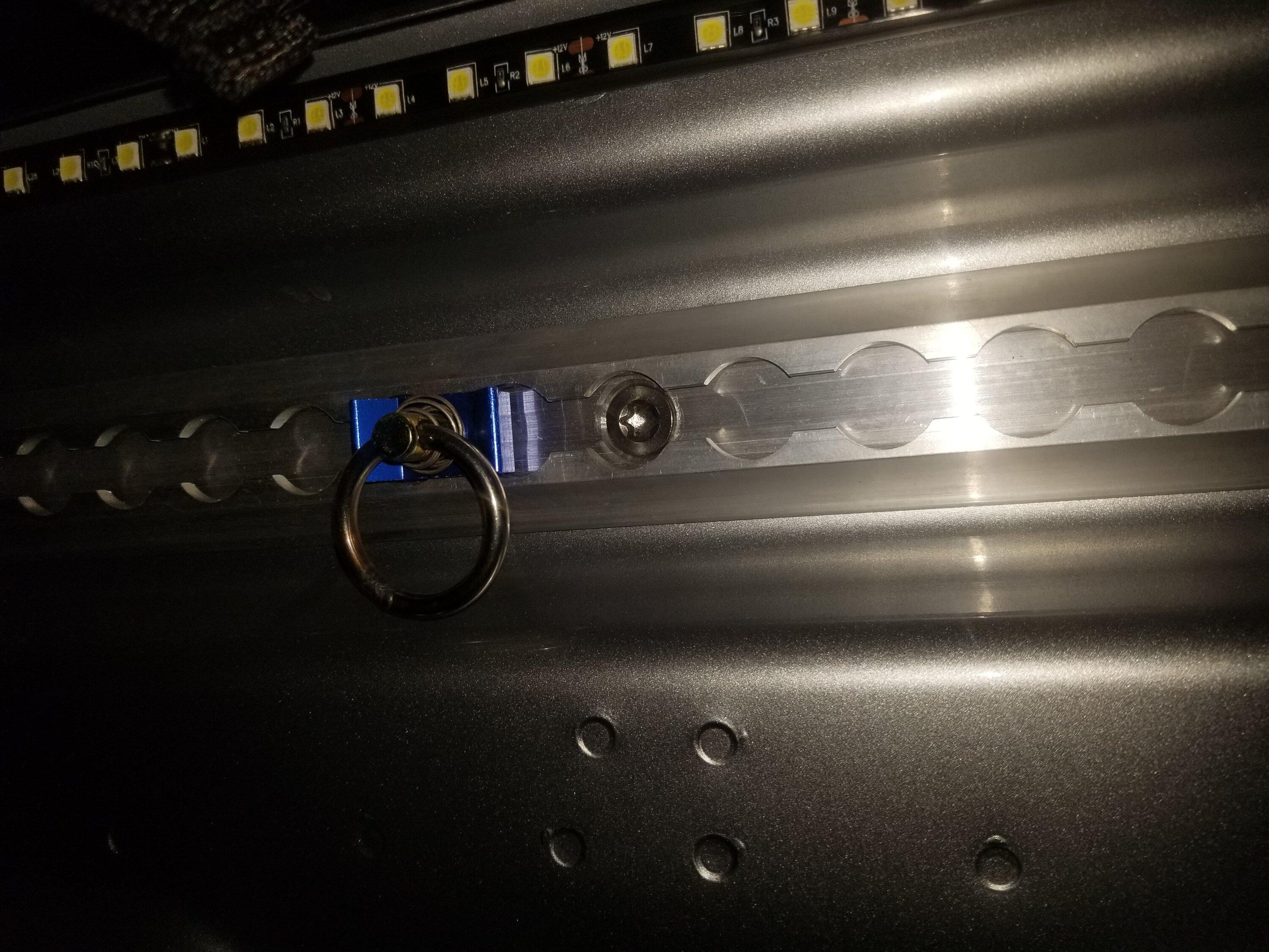

Some better pix of this setup. As stated earlier, when I measured the hole spacing on the bed, these 4 holes are the only holes that are perfectly in line with one another and that meet the 1" on center spacing requirements for a clean install of this track. After my first track install, another truck club member drew the blueprint for these up. My drawing only had the hole spacing required.
If you follow the blueprint, and oversize the drill holes for the bolt shanks slightly to allow for slight variation in spot welded nutplate position in the 4 spots on each side, these bolt right up. One bed side on mine, the bed nutplates were slightly off center. After enlarging the holes on the tracks a little, the screws threaded in straight with no binding
I get all 4 screws started before running any of them down tight. I also used anti seize compound on the threads. If they try to bind up, STOP!! If you continue, then your probably cross threading the bolt, and will break the nutplate off the bedside.
Another option instead of countersink bolts is a button head torx bolt. Then you only need to drill the mount holes, and no countersinking. However with this, you lose a couple spots on the track to lock your tiedowns into.
I hope this helps.

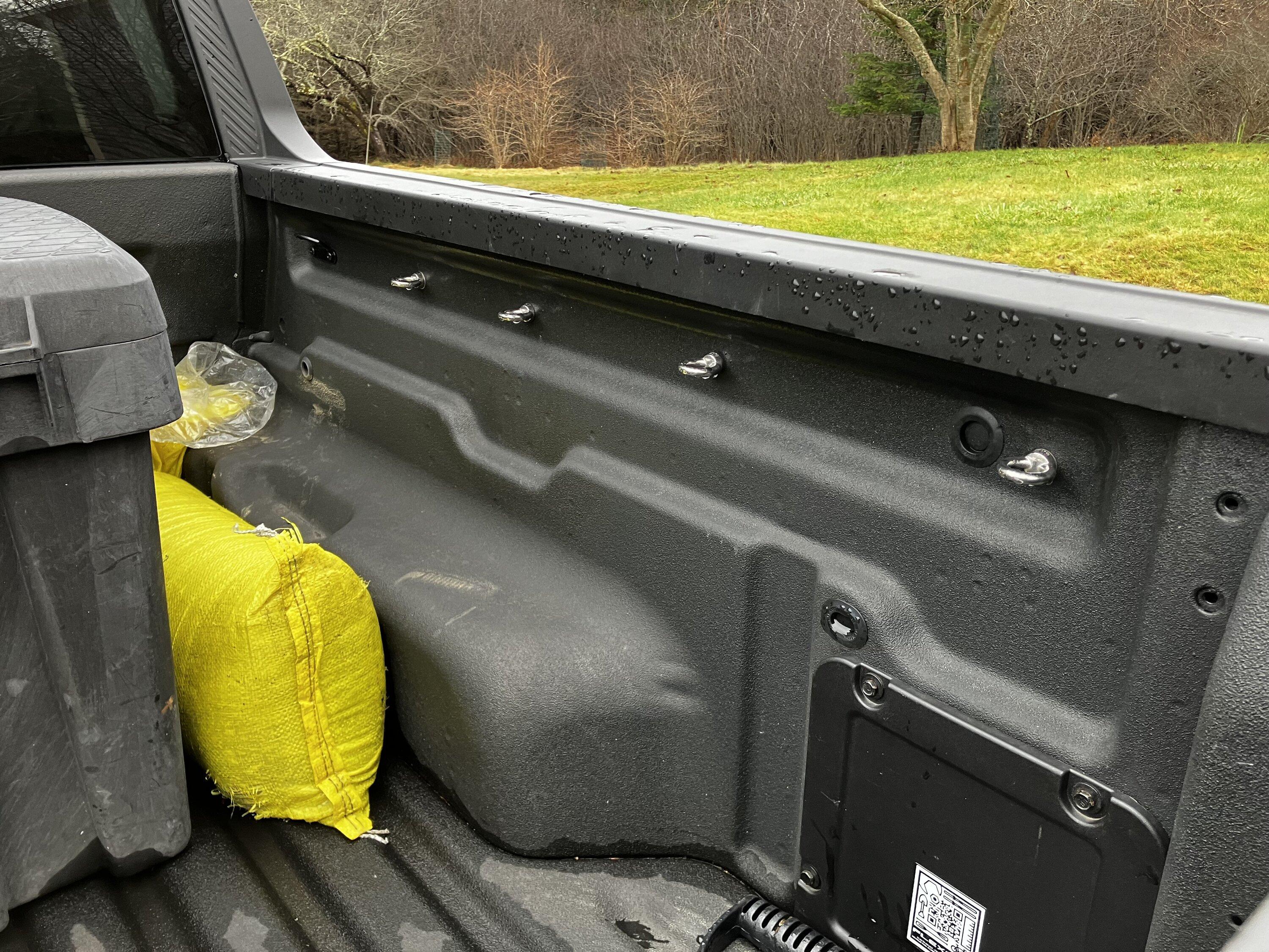

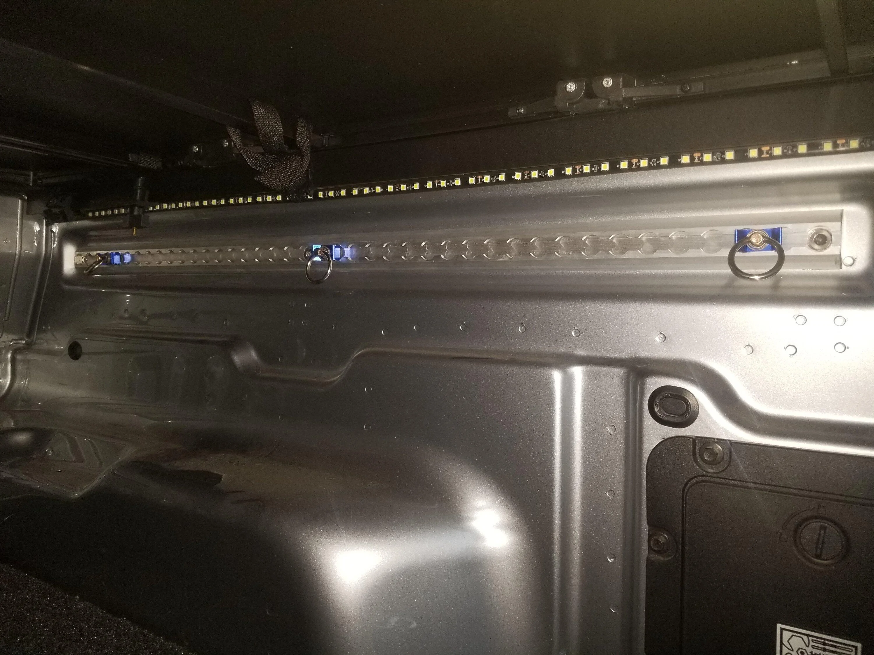

I liked the idea but didn’t feel I needed infinite flexibility for the ring attachment points for my use. I used Stainless lock washers to give myself the flexiblity of having them oriented the same way.

It's not so much about flexibility as it is spreading the load. Those eyelets are only threaded into a welded nutplate attached to thin gage sheetmetal. Just load something heavy and attach it to those eyelets, and if you have to slam on the brakes and that load shifts, it will bend those eyelets, or snap them off right at the threads, and probably bend the bed sheetmetal while doing all of that. The point of the infinite point attachment is the bolted on rail takes the brunt of the shock if the load shifts. Plus the clip in L track rings rotate to maintain inline to your tiedowns preventing side loading of the ring. Even the ford tutorial with the U channel strut material is better than the eyelet setup. Good luck to you.

I agree with you on the strength issue. I use the slots in bed with 2x’s to keep loads from shifting. I use the eyes to tie down loads like brush and tree limbs.
