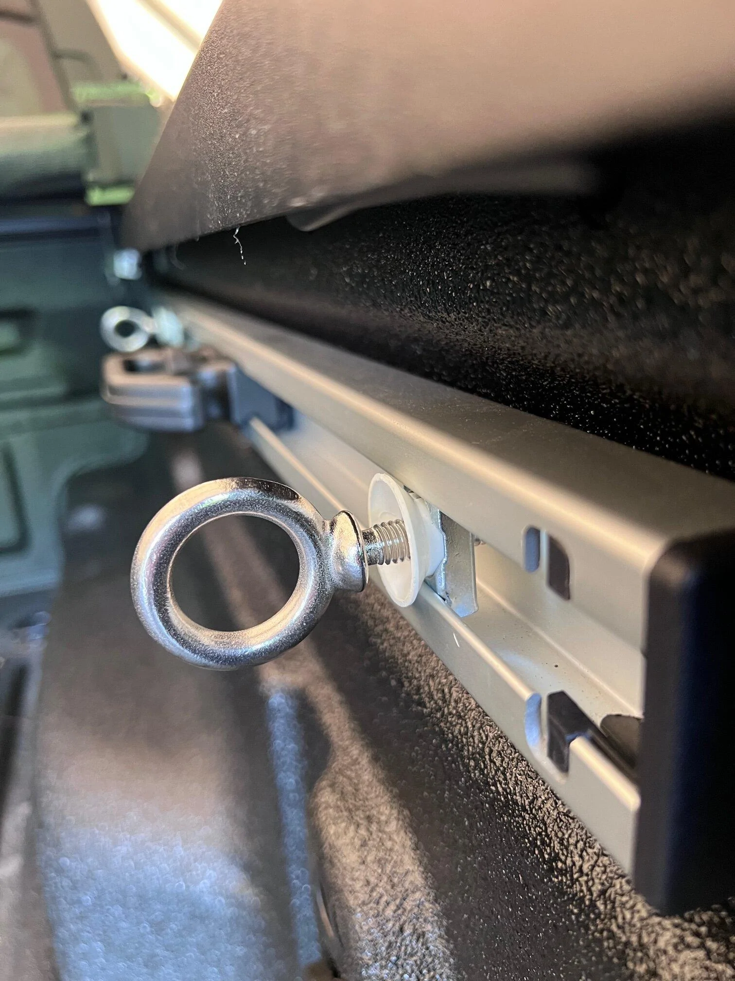

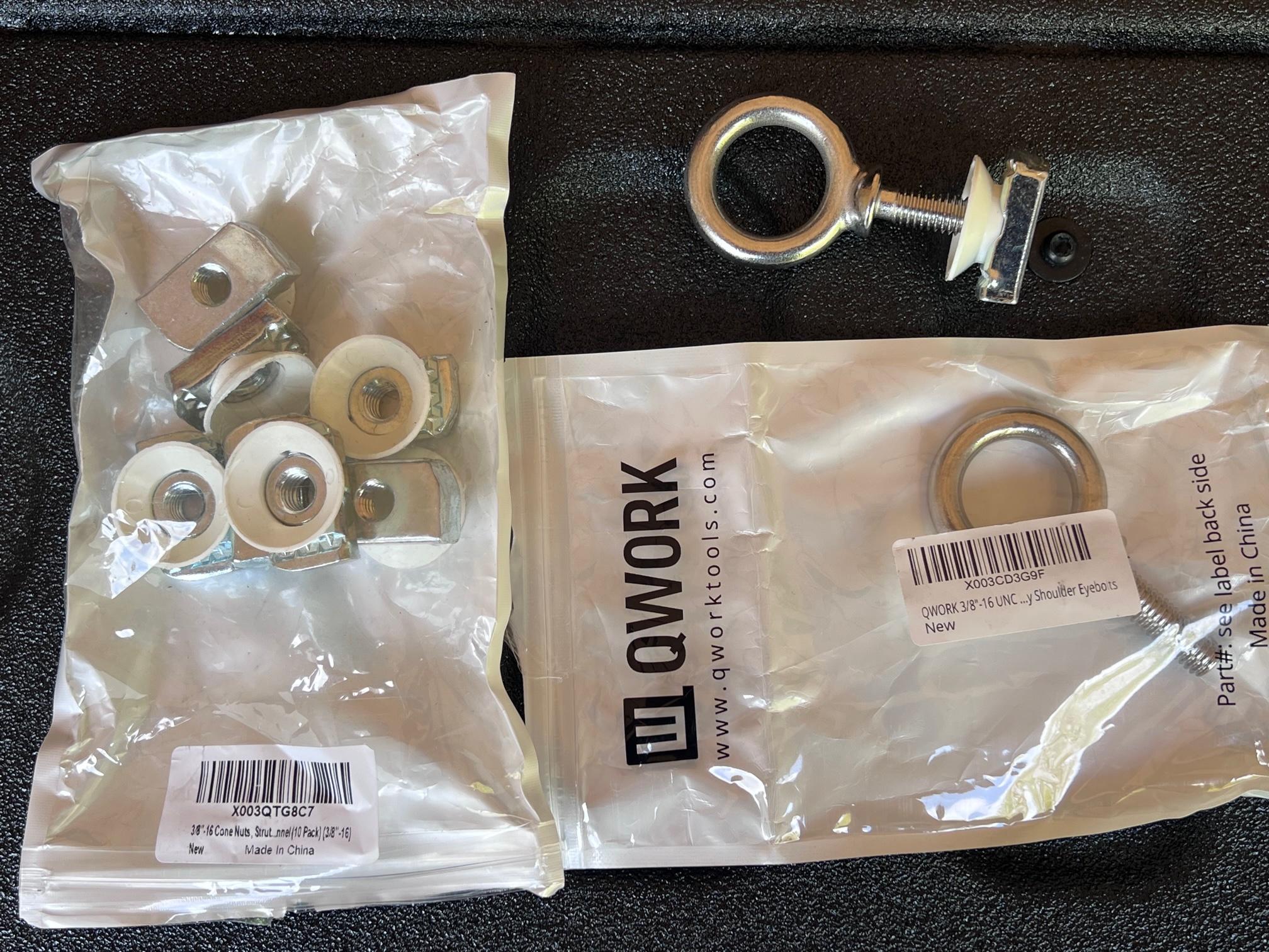

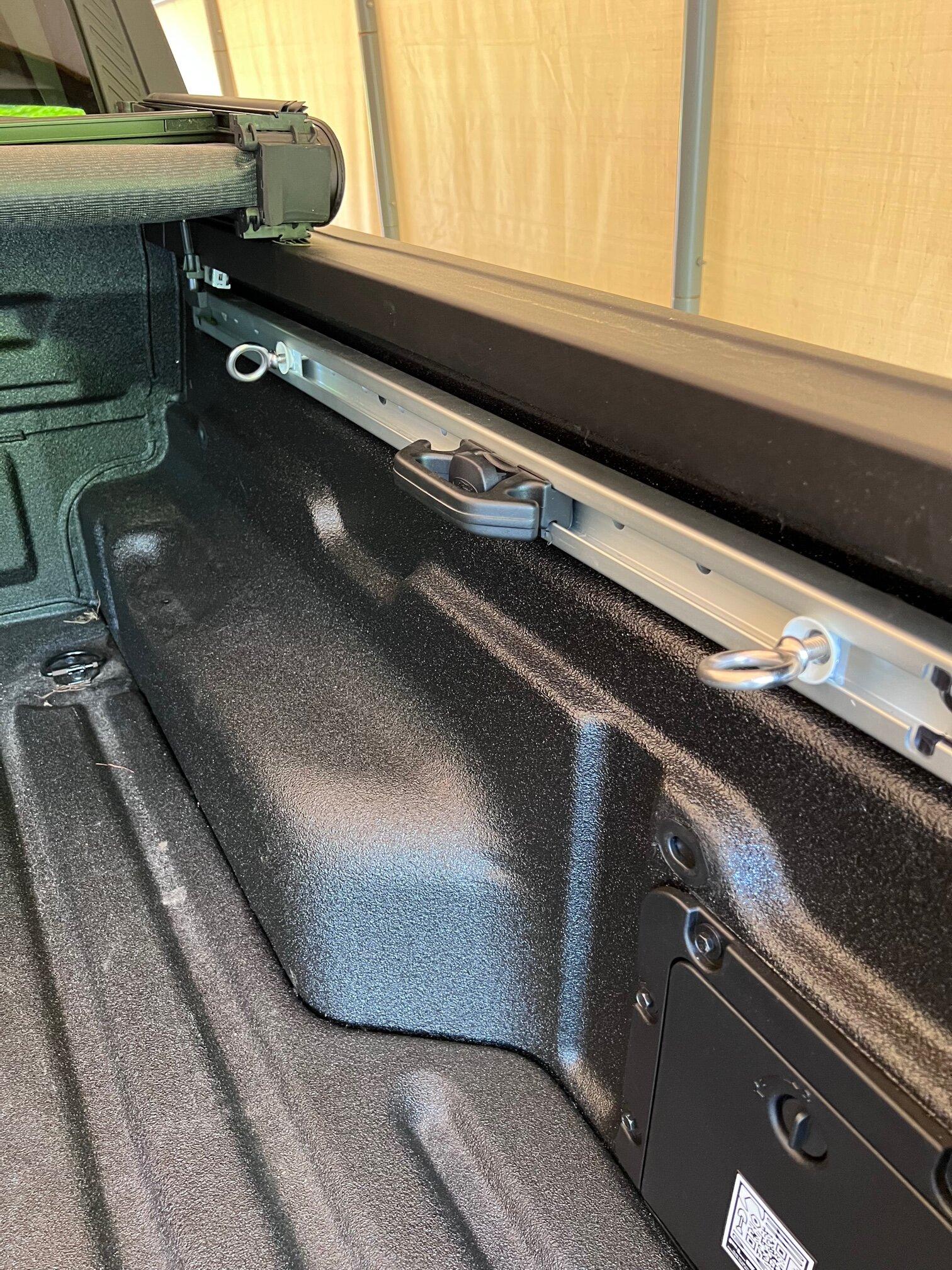

You can get a pair of the "official" bed rail handle-cleats for $100...or shell out $25 for 4 of these stainless steel eyebolt/conenut sets! They slip right into the channel without having to remove it and can be loosened and positioned wherever one wishes.
Ford Maverick Economical Bed Rail Adjustable Tie-Downs IMG_1151
Ford Maverick Economical Bed Rail Adjustable Tie-Downs IMG_1153
Ford Maverick Economical Bed Rail Adjustable Tie-Downs IMG_1154

Great out of the box thinking!!!
Katwimin
TT
Oct 14, 2023
SAT TX
VW Golf; Ford C-Max; 2024 Lariat Hybrid (Jan30,24)
Thank you for the tip I bought them and they work great!
