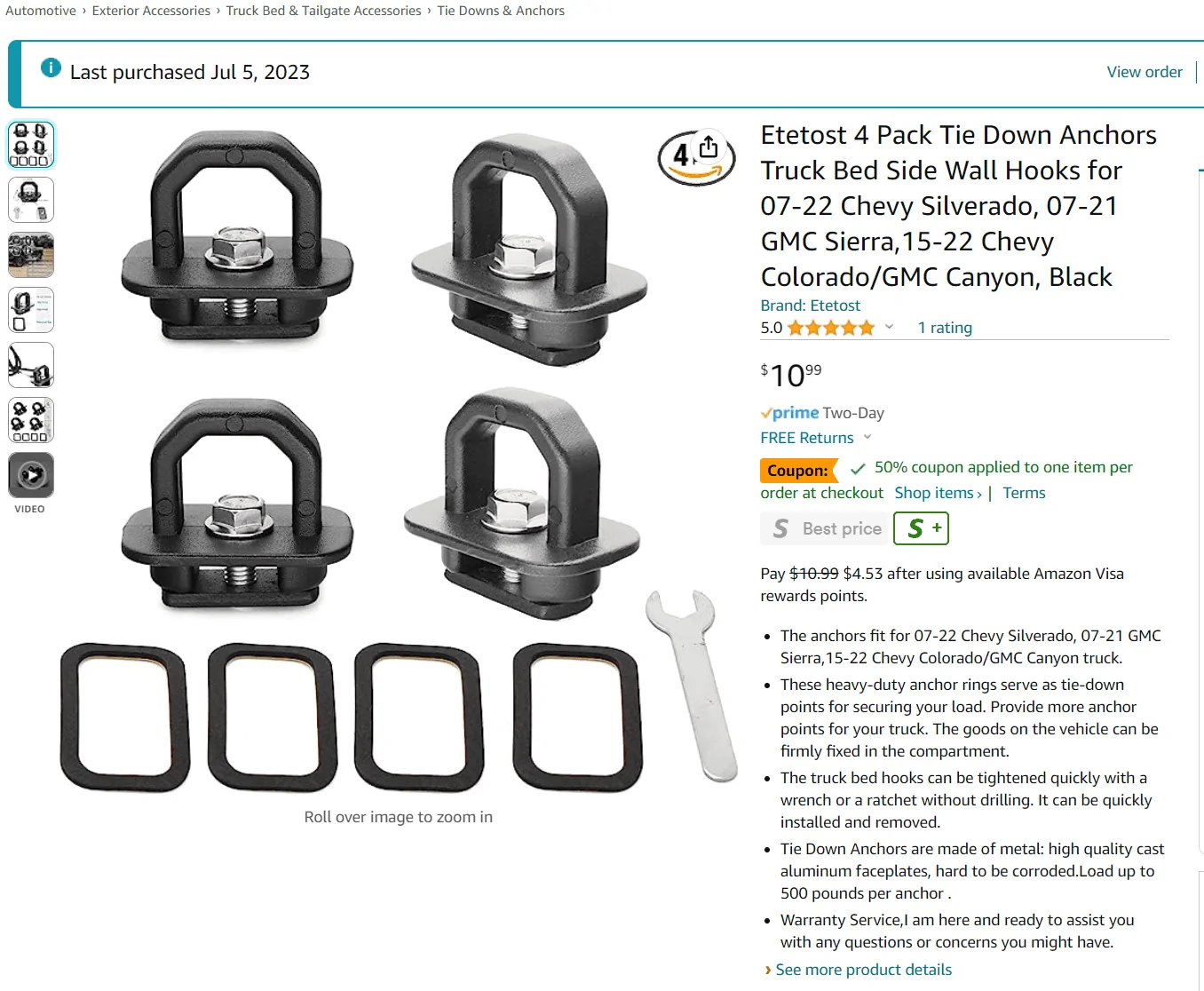

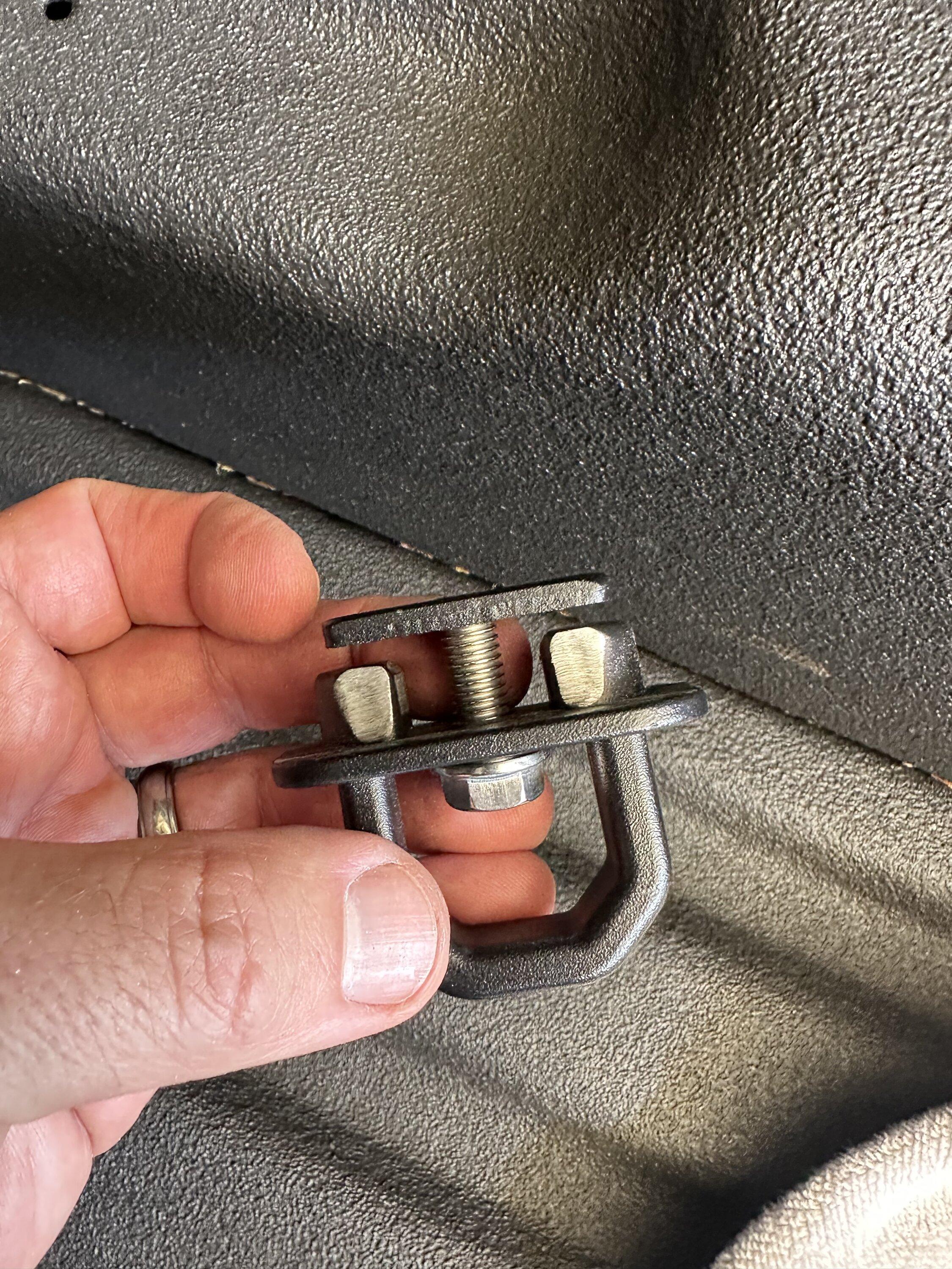

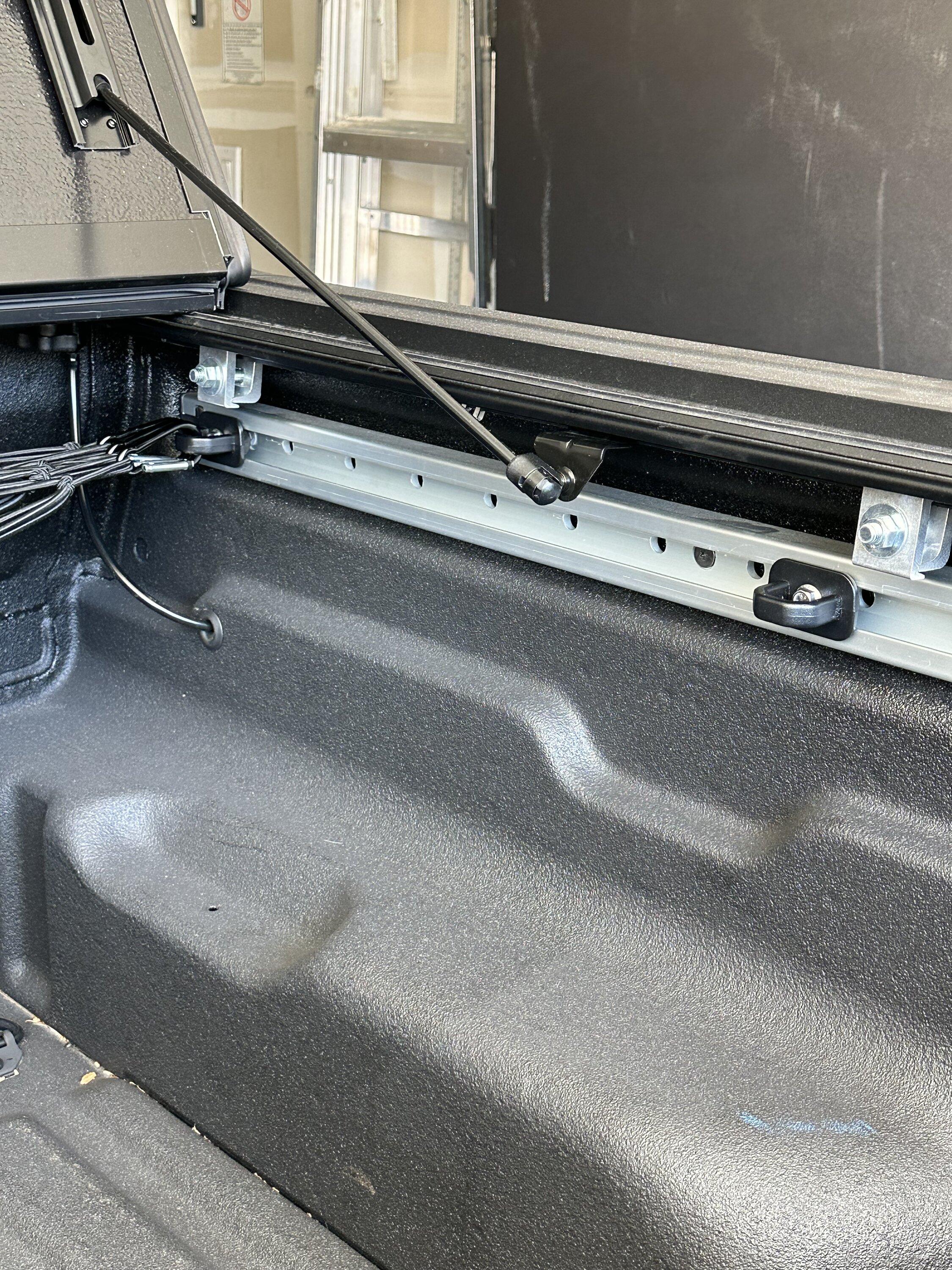

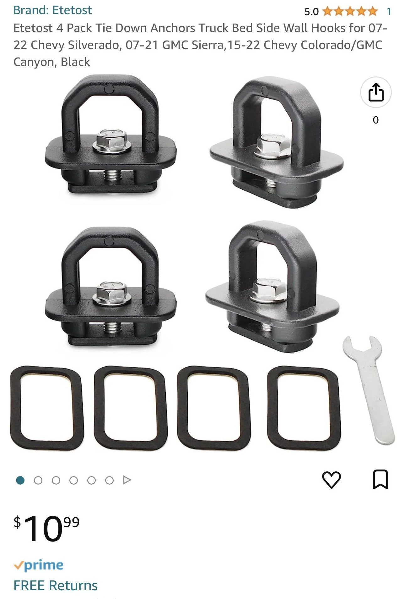

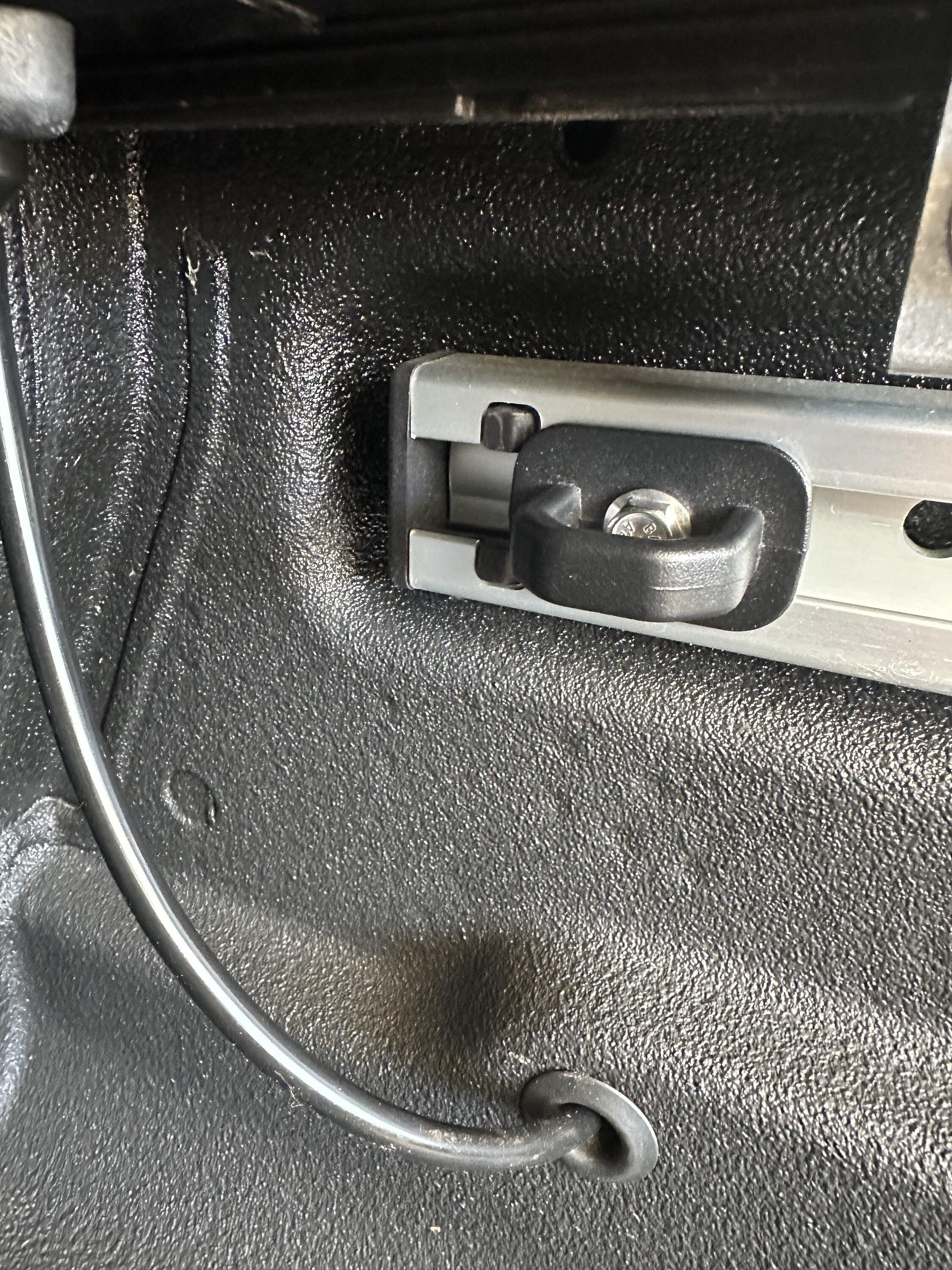

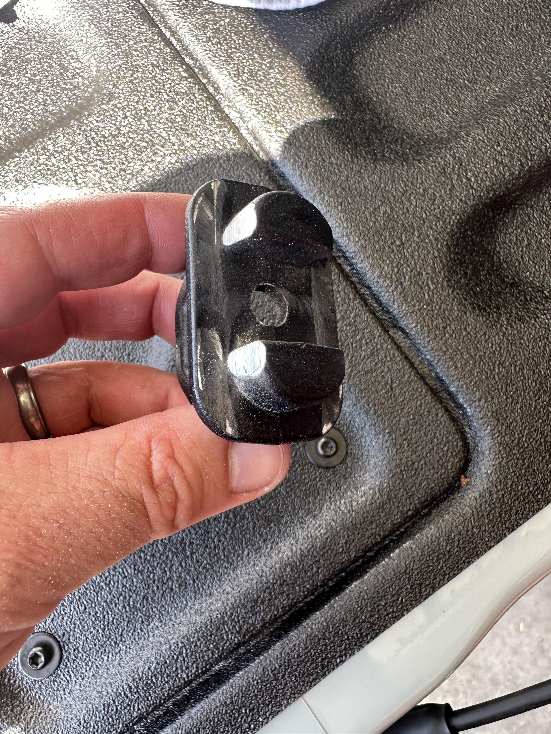

I know this has several posts but I couldn’t find any that fit this exactly. After looking around to find attachments for the the side rails in my truck, I located these on Amazon for $10 for four of them. I attached photos for reference because you have to slightly modify to fit within the rail space. They are aluminum so they are easy to sand down the edges to fit and they they match the original handle that comes with the truck. They tighten down super easy and are easy to move if needed. An easy project for low cost that is clean.

bet those are a pain to tighten

Looks like a ratcheting wrench would fit, should be very quick and easy if that is the case.

Exactly. You can tighten most of down by hand. Just a few extra turns with the wrench and it’s solid. Like I said the longest part was knocking down the edges to get it to fit but since that are aluminum, it goes pretty fast.

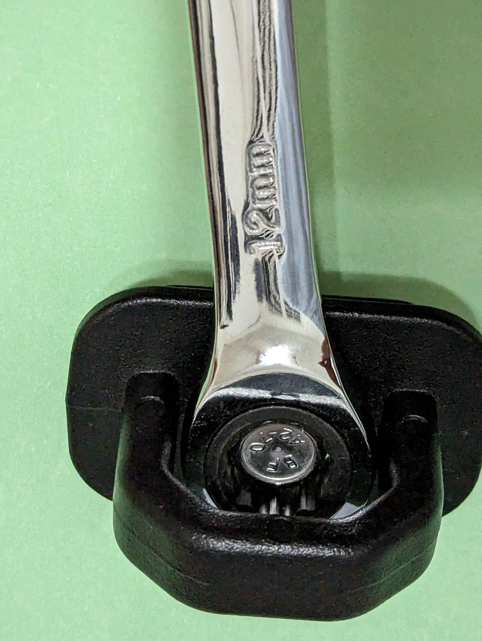

Received delivery from Amazon earlier today, and tried the ratcheting wrench - 12mm. It fits! Easy removal/tightening!
