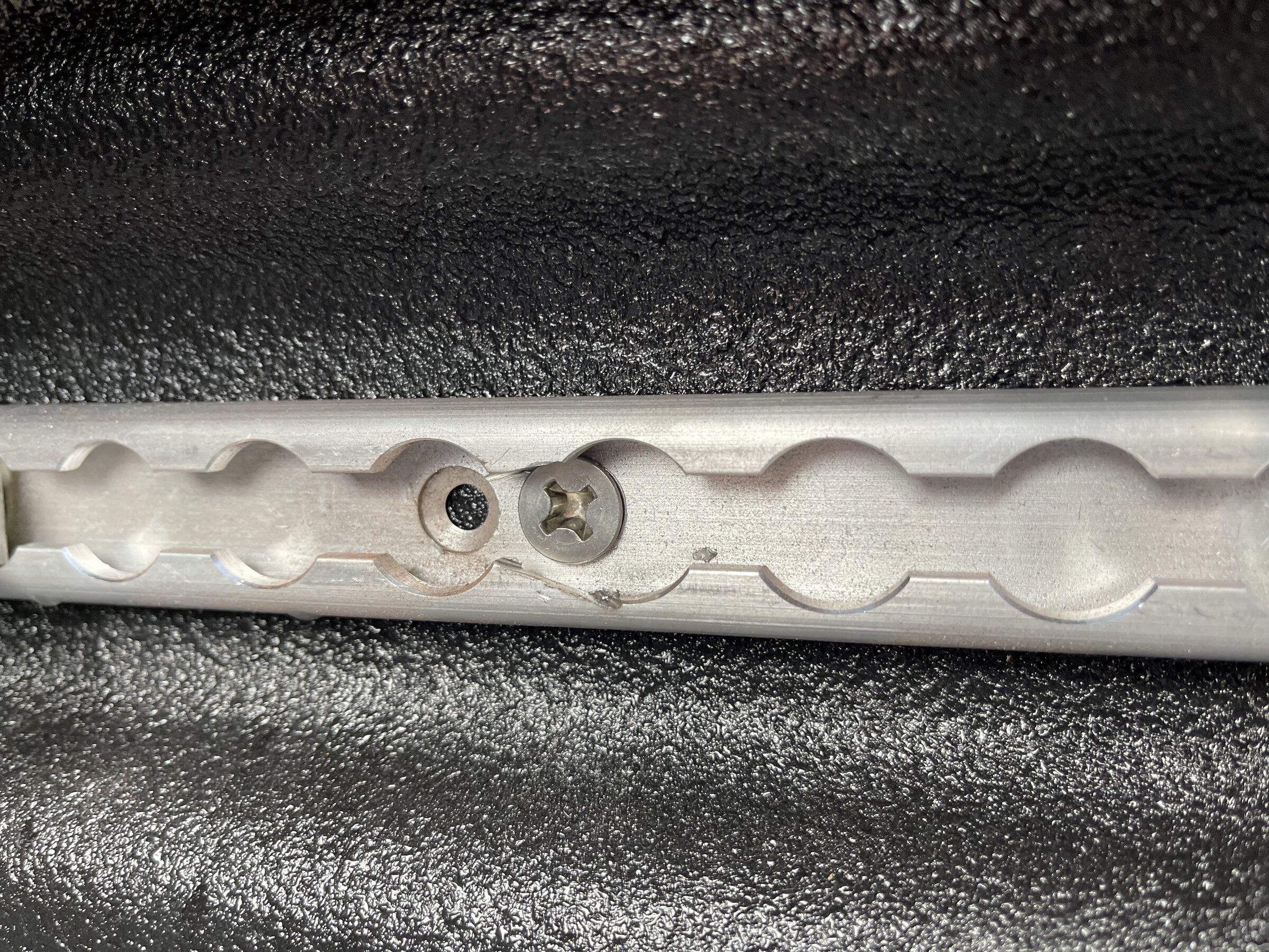

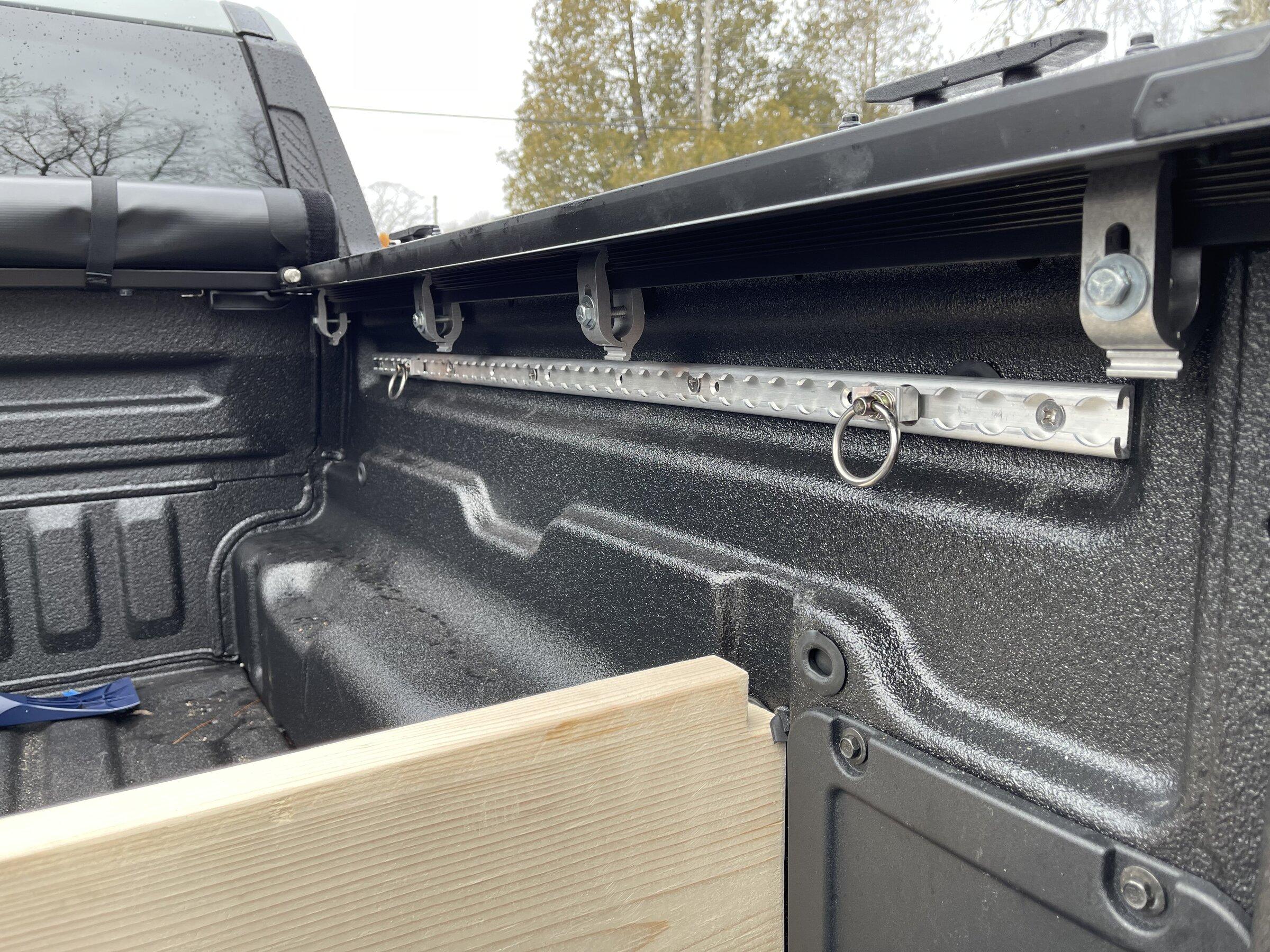

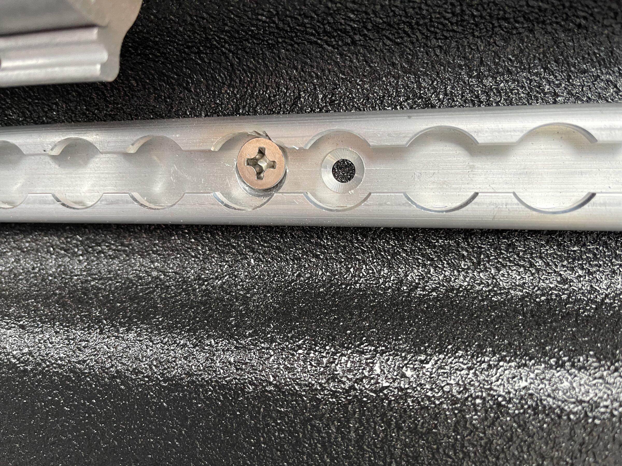

Sorry for my delay. Here are some pictures of the full rail and the two trouble spots. As my neighbor always says, it looks good from afar, but it's far from good :) It's really not that bad... the biggest problem is that some of the positions aren't usable because I couldn't countersink the screws enough or because I had to shave away some metal. I'll probably keep them until I'm able to order the factory rails that come with the Lux package (assuming they aren't crazy expensive).
Ford Maverick Make your own Maverick bed tie-downs: DIY bed side rail tutorial by Ford IMG_3620
Ford Maverick Make your own Maverick bed tie-downs: DIY bed side rail tutorial by Ford IMG_3617
Ford Maverick Make your own Maverick bed tie-downs: DIY bed side rail tutorial by Ford IMG_3618

Thank you very much for the pictures of the finished rails. They look good despite the difficulties you experienced installing them. And in reality, only you will ever notice the problem spots ;)

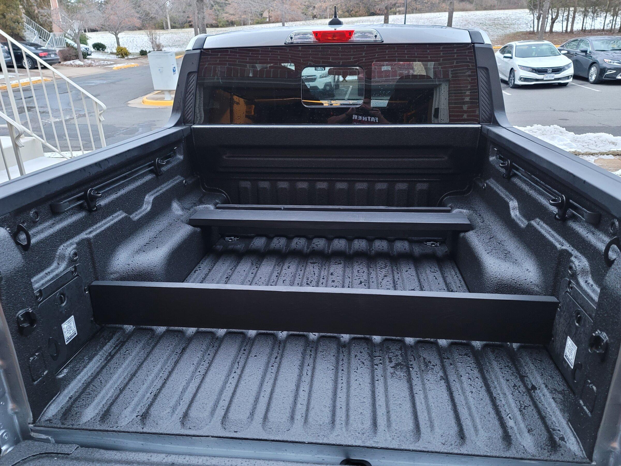

gear1975
Dec 17, 2021
69
121
Winnipeg, Manitoba, Canada
2022 Maverick, 2020 Civic, 2006 Pathfinder
I recently did this install. Will paint the rails black once spring comes. Worked great, and holes lined up without issue.
Ford Maverick Make your own Maverick bed tie-downs: DIY bed side rail tutorial by Ford 1643146379204
Ford Maverick Make your own Maverick bed tie-downs: DIY bed side rail tutorial by Ford 1643146405269

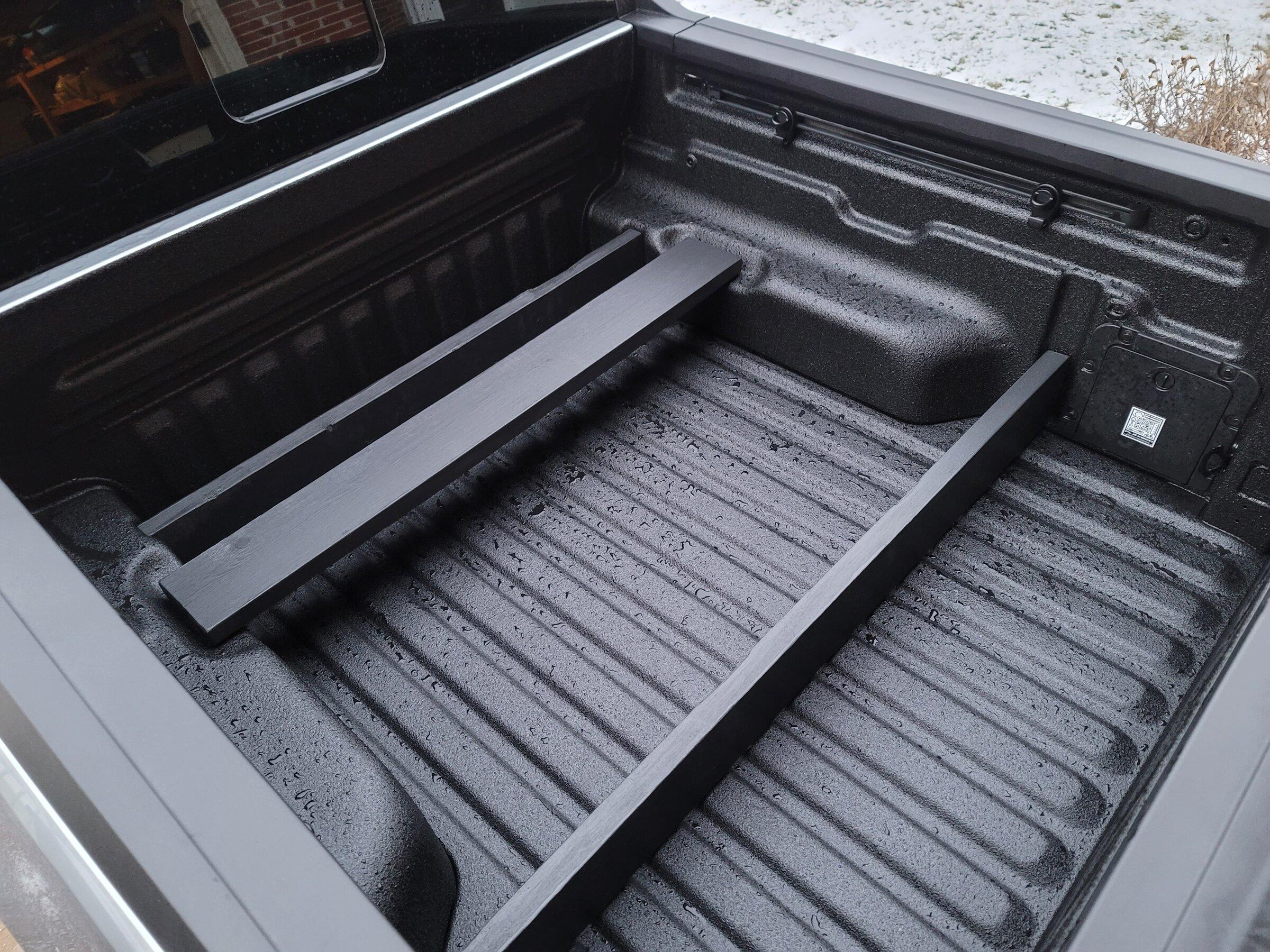

Barracuda340
Matt
Dec 19, 2021
2,149
2,520
Abilene Tx
Done. Area51 Bed Rails ... along with Area51 sound cables, water bottles, and other Area51 items ...LOL
I will likely round up the goodies to make the ford hack bedside rails as well.

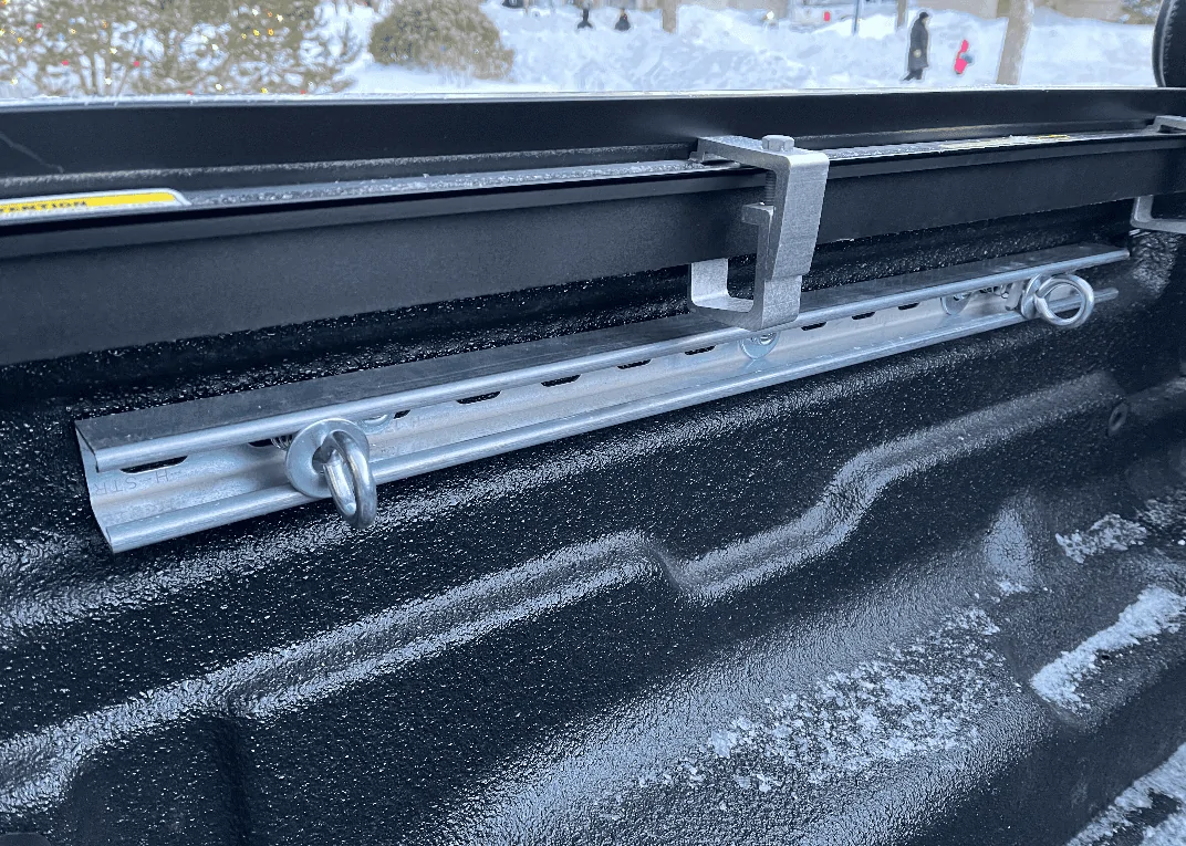

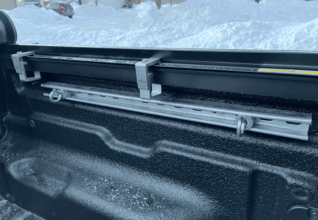

diggz313
Diego
Jan 5, 2022
49
20121
2022 Maverick Hybrid
diggz313
Diego
Jan 5, 2022
49
20121
and the finished product
Ford Maverick Make your own Maverick bed tie-downs: DIY bed side rail tutorial by Ford 20220130_172427
Ford Maverick Make your own Maverick bed tie-downs: DIY bed side rail tutorial by Ford 20220130_173135
