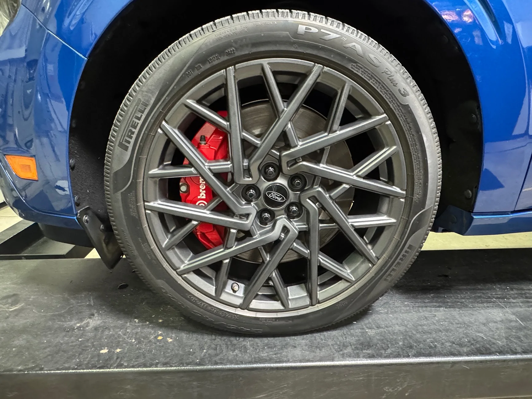

Ford Maverick Mach-E Brembo Upgrade with Part #'s IMG_5335
