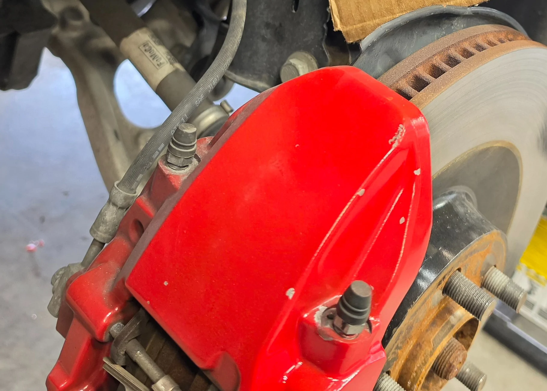

It sounds like you've gotten you answer but there's definitely not any extra room in the caliper. I took mine off and was going to sell them so I had taken some pictures, it's kind of hard to tell but in this one you can see there's only a couple millimeters between the top of the pad/rotor and the slide pins.

Sorry about not responding, I don't think I ever got any got any notifications I was being tagged.

Why are you selling them?
I took them off to switch to the Volvo Brembo's, my winter tires are on the 17" steel wheels and they don't clear the Mach-E brakes but they did clear the Volvo's. But I ended up running into a lot of problems finding a rotor that fit and then I found out the 21" Edge ST wheels wouldn't fit without a 1" spacer. So I ended up taking the Volvo brakes off and went back to these.
