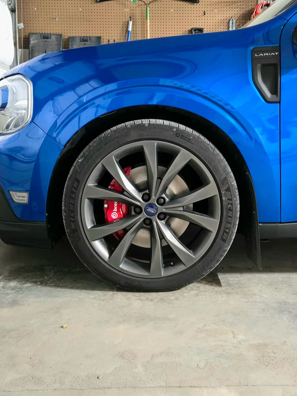

What mm rotor did you use I have seen a couple different option la just wanted to know what I should be looking for, plus your awesome for this ;)
I used the 362mm ones, they were cheaper and easier to find and I was able to use the stock backing plate.

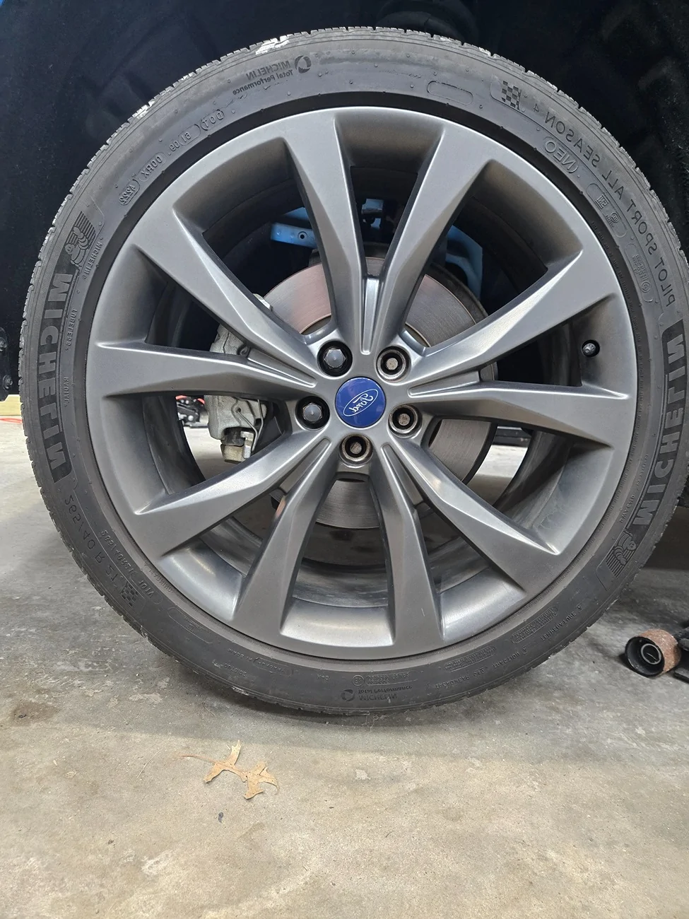

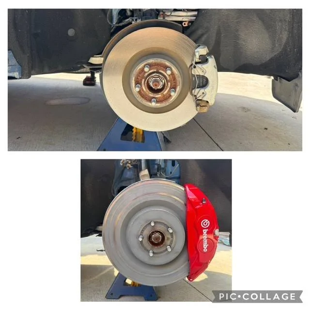

Before
Ford Maverick Mach-E Brembo Upgrade with Part #'s 20250704_224623

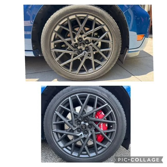

After
Ford Maverick Mach-E Brembo Upgrade with Part #'s 20250706_221354

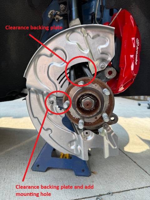

As the title states...I have captured pictures and part number data to help others with their upgrade to Brembo brakes from a Mach-E GT.
The part numbers are:
Rotors = LK9Z-1125-A (2 required)
Calipers = LK9Z-2B120-A and LK9Z-2B121-A (1 each required)
Pads = LJ9Z-2001-B (1 set)
Brake Hoses = LJ9Z-2078-A (2 required)
Caliper Bolts = W7 10681-S439 (pkg 2) (4 required)

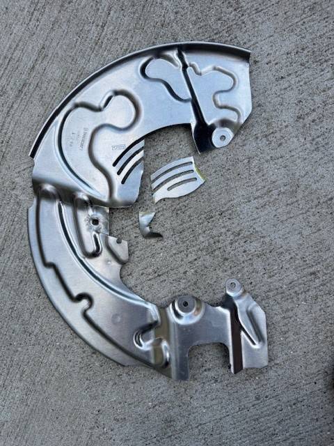

Backing Plate/Dust Shield = LJ9Z-2K004-B and LJ9Z-2K005-B (1 each required)
Once you strip the old brakes off you can start with the backing plates. They will need to be modified slightly with a mounting hole added.

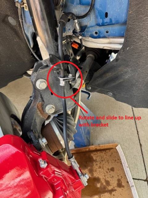

You can then add the new brake hoses. The retainer bracket will likely not be in the correct position. Once you have both ends of the hose connected you can slide and rotate the bracket to line up with the mounting point.

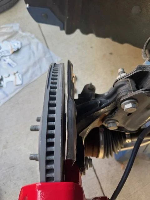

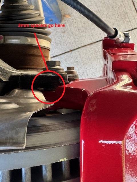

Next you can install rotor and caliper. Caliper will need 3mm spacer between spindle and caliper.

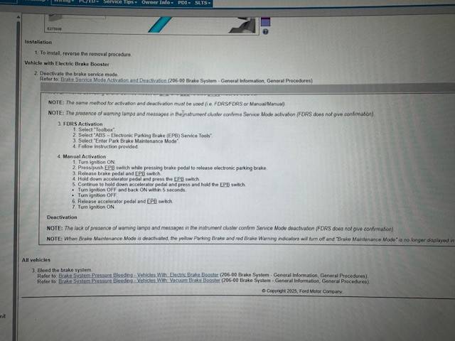

For brake bleeding you can try the manual procedure outlined in the screenshots below. They are from FDRS (Ford shop manual). The manual procedure would not work on my hybrid but luckily, I have a VCM3 and access to the Ford service software to enter the vehicle into/out of Brake Service Mode.
