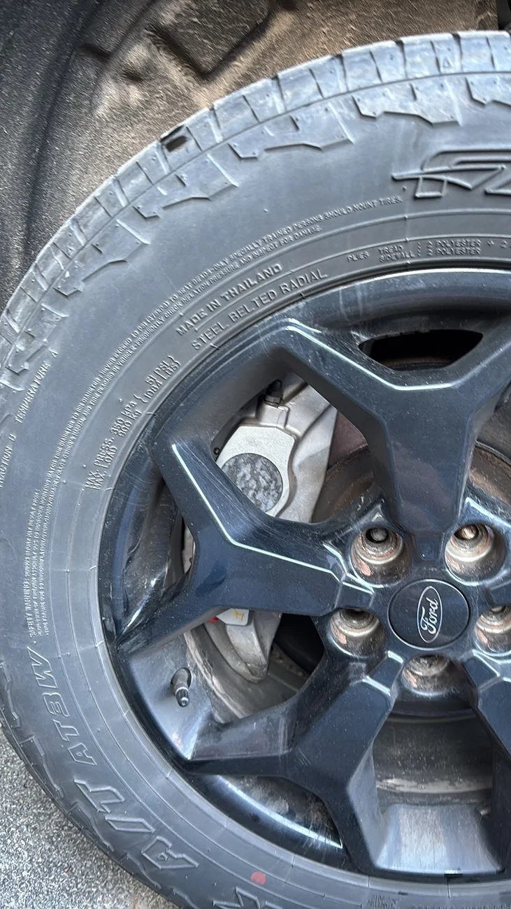

I’ll be the guy to save yall some time, will definitely not fit Maverick 17s. Maybe some 17s with a bigger offset and a flatter barrel.

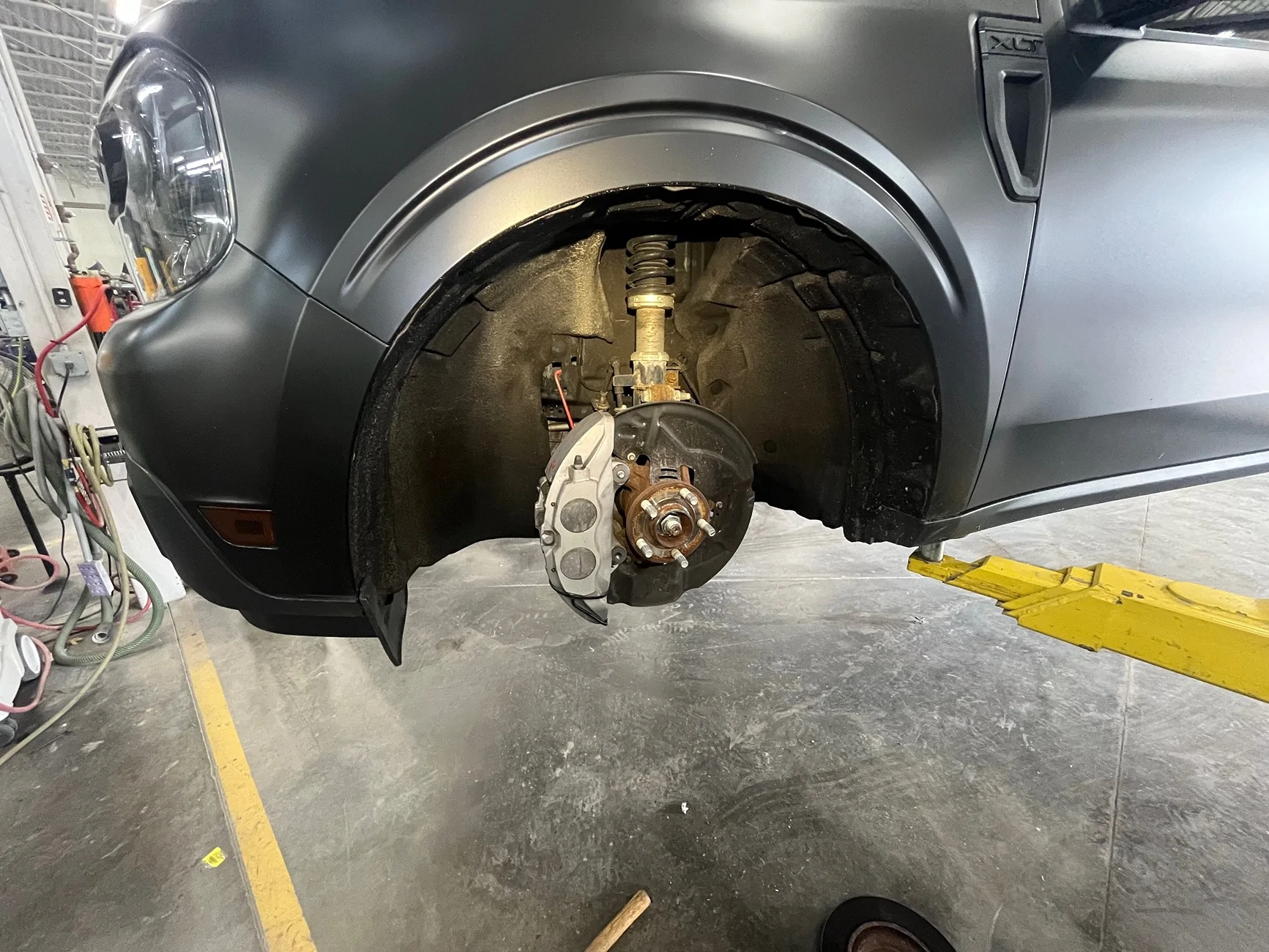

Ford Maverick Mach-E Brembo Upgrade with Part #'s IMG_9638
Nice! Looks like there might be just enough space for an 18" wheel though!!
Did you do the install yourself or do you also have a Mach-e?

I found the calipers for 60 each and impulse bought them… then did the math and a test fit. I found Maverick bap 18s from ford for 130 a rim so they are on there way! Then we will see again because I don’t see anyone with factory Maverick rims running this set up

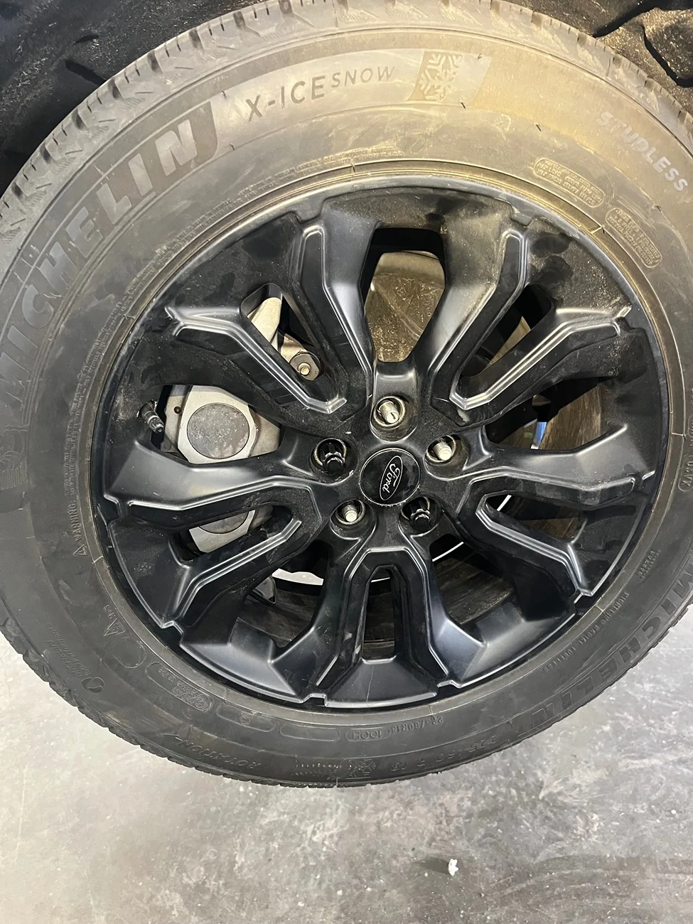

Did you need spacers with those wheels? I haven’t ordered Mach e rotors or pads yet so don’t know if I would need spacers. I know my summers don’t need spacers. If anything I would only need 5mm spacers for stock wheels
Ford Maverick Mach-E Brembo Upgrade with Part #'s IMG_1951
Ford Maverick Mach-E Brembo Upgrade with Part #'s IMG_1952
No the 17s don’t fit, the caliper was rubbing the rim and I wasn’t even on the lugs yet.
Oh those were 17s must of miss read my 18 maverick wheels fit but will probably need spacers

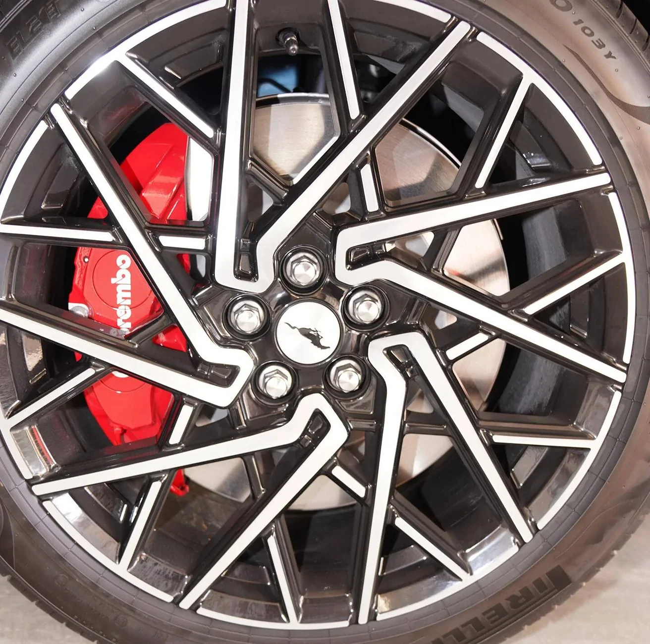

From these photos (Top Non-PE/no decal) and (Bottom PE w/ decal) there is a inside radius and overall length difference between the LJ9Z (Non-PE) and the LK9Z (PE) Calipers!
The LJ9Z Calipers for the 362mm Rotors weigh 11.45lbs and for the LK9Z Calipers for the 385mm Rotors weigh 11.7lbs. Also the 362mm (14.25197") rotors weigh 23lbs and the 365mm (15.15748") rotors weigh 27.33lbs. This is taken from Duck Duck Go Search Assist. Personally haven't verified this. But from these photos from GT vs GTPE Mach-E forum, you can see the Caliper's inside radius and caliper lenght difference between the two rotor sizes.
Ford Maverick Mach-E Brembo Upgrade with Part #'s 362mm Rotors with LJ9Z Calipers
Ford Maverick Mach-E Brembo Upgrade with Part #'s 385mm Rotors with LK9Z Calipers

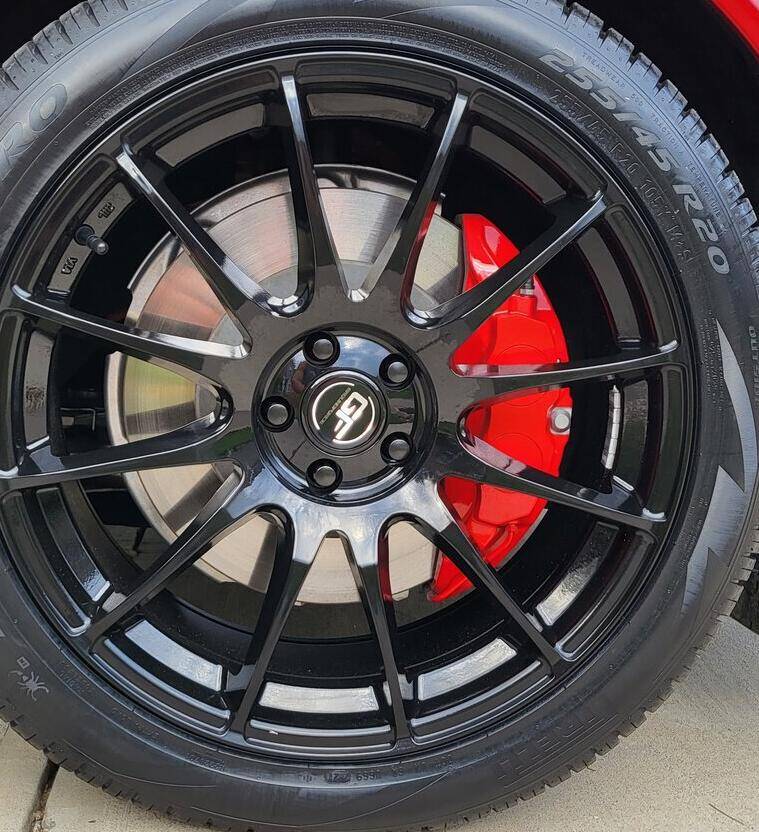

Ugh. After reading all this I checked my calipers and it looks like I got bamboozled. Brembo stickers but Ford/Continental(ATE) red brakes. Argh! Running on OEM 385mm rotors though.
So be careful when sourcing your upgrades .

On a positive note, I do have a 4-piston performance caliper upgrade on 385mm rotors. And they look good too. Trying to see the positive. :)
