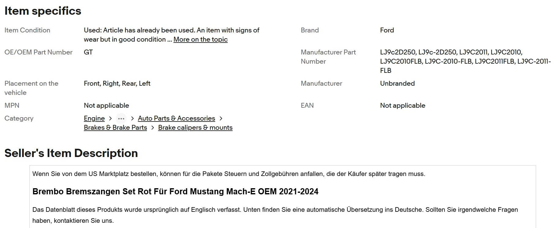

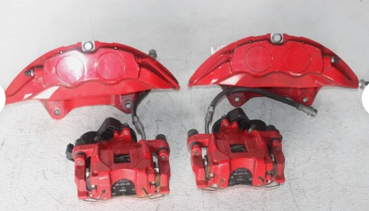

I've been searching rock auto and other places and can't seem to find the parts you listed. Closest I've found is some used parts on ebay.de that i've screen shot and added here. Any chance this is the same, just a different version?

This is the route I went, I bought used calipers with new pads and rotors, and with red caliper paint and brembo decals I have just over $500 in it.

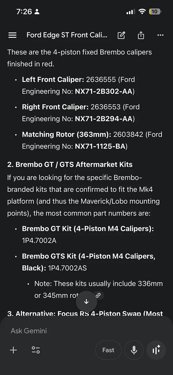

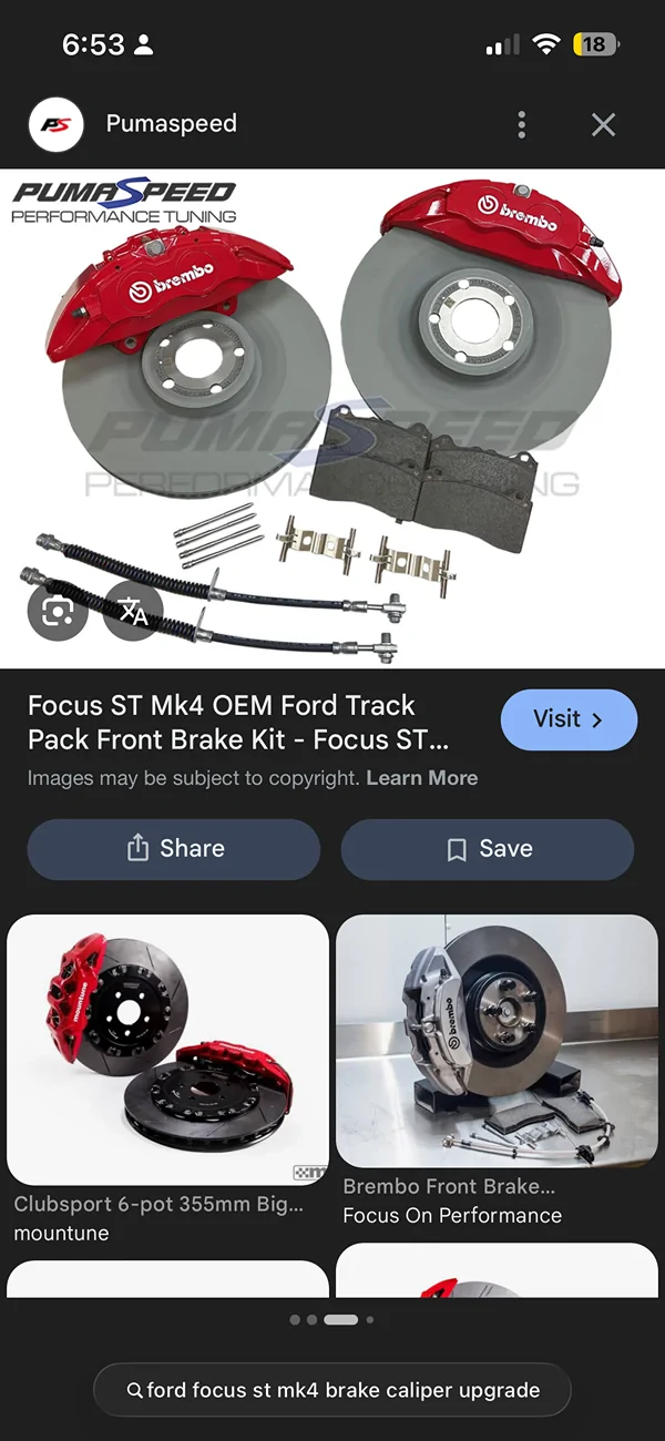

Kind of surprised Brembo doesn’t make a kit for the Maverick by now.
I’m convinced these are also Genuine Ford Mk4 ST Track pack Brake calipers someone should help verify this

They actually might have something! ai could be wrong. The have kits for mk4 focus st

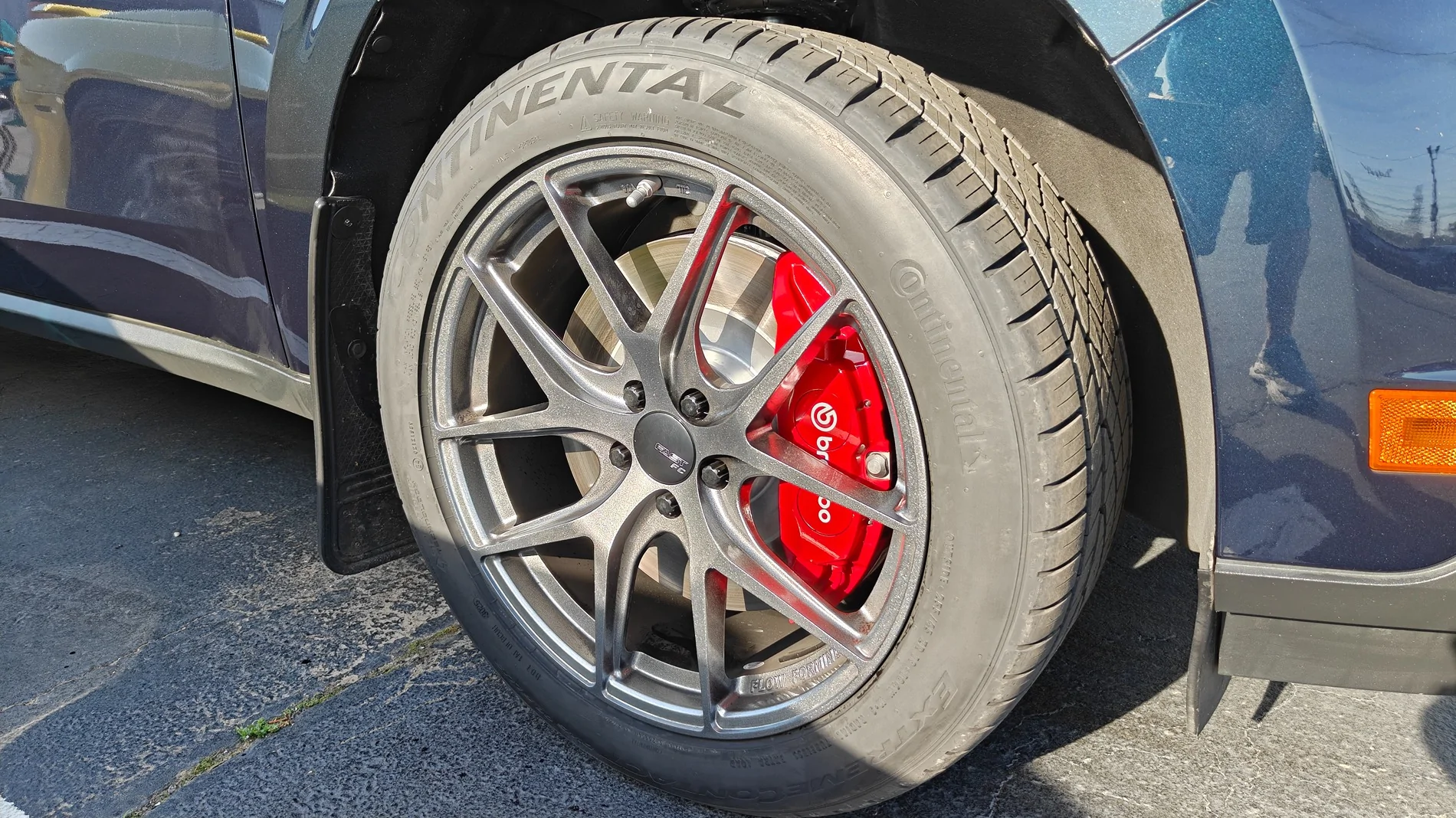

If you aren't too picky, you can find used calipers off a donor MachE GT for less. I got mine for $240 each. I went with the LK9Z-1125-A OEM 385mm rotors.
Also, the MachE GT rear brakes aren't much different than the Maverick's and not worth the upgrade. I just painted my rear calipers to match.
