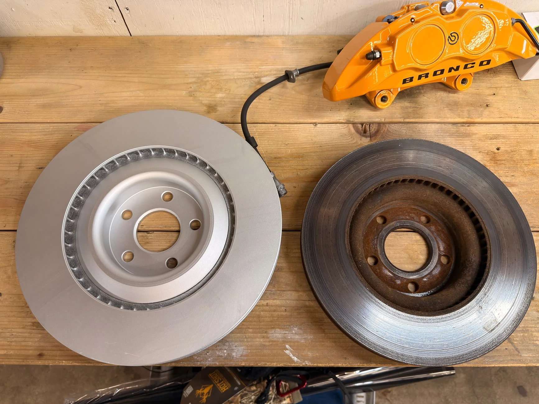

As the title states...I have captured pictures and part number data to help others with their upgrade to Brembo brakes from a Mach-E GT.
The part numbers are:
Rotors = LK9Z-1125-A (2 required)
Calipers = LK9Z-2B120-A and LK9Z-2B121-A (1 each required)
Pads = LJ9Z-2001-B (1 set)
Brake Hoses = LJ9Z-2078-A (2 required)
Caliper Bolts = W7 10681-S439 (pkg 2) (4 required)
Backing Plate/Dust Shield = LJ9Z-2K004-B and LJ9Z-2K005-B (1 each required)
Once you strip the old brakes off you can start with the backing plates. They will need to be modified slightly with a mounting hole added.
You can then add the new brake hoses. The retainer bracket will likely not be in the correct position. Once you have both ends of the hose connected you can slide and rotate the bracket to line up with the mounting point.
Next you can install rotor and caliper. Caliper will need 3mm spacer between spindle and caliper.
For brake bleeding you can try the manual procedure outlined in the screenshots below. They are from FDRS (Ford shop manual). The manual procedure would not work on my hybrid but luckily, I have a VCM3 and access to the Ford service software to enter the vehicle into/out of Brake Service Mode.
Thats it!!!
If you aren't wearing your seatbelt, the brakes will put you through the windshield! They are awesome.

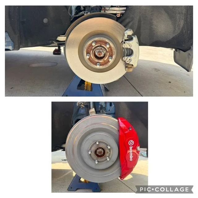

I did mine as well using the regular GT calipers. Got the calipers off eBay for $250 each and it came with the brake hoses. This was one of the easier cars to remove the original calipers and rotors, and the new ones bolted on easy. They just clear the barrel of the 18" wheels

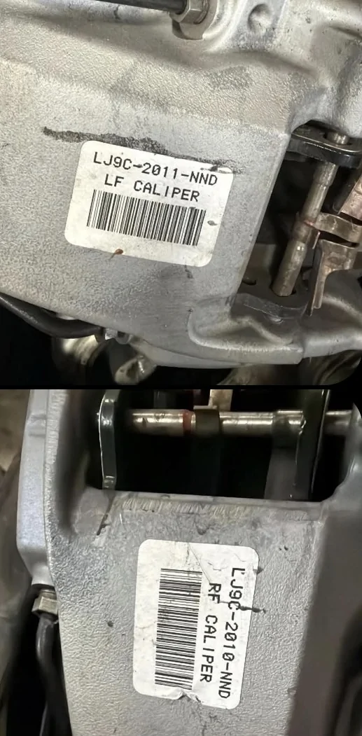

I would like to add a part number to the list
I have a caliper set off a 2025 and they fit and maybe someone that works at ford can verify but they don’t look any different, just a part number change.
LJ9C-2011-NND
LJ9C-2011-NND
LJ9C-2010-NND
LJ9C-2011-NND
I also purchased a pair of calipers with those same part numbers off ebay recently.
LJ9C-2010-NND RF
LJ9C-2011-NND LF

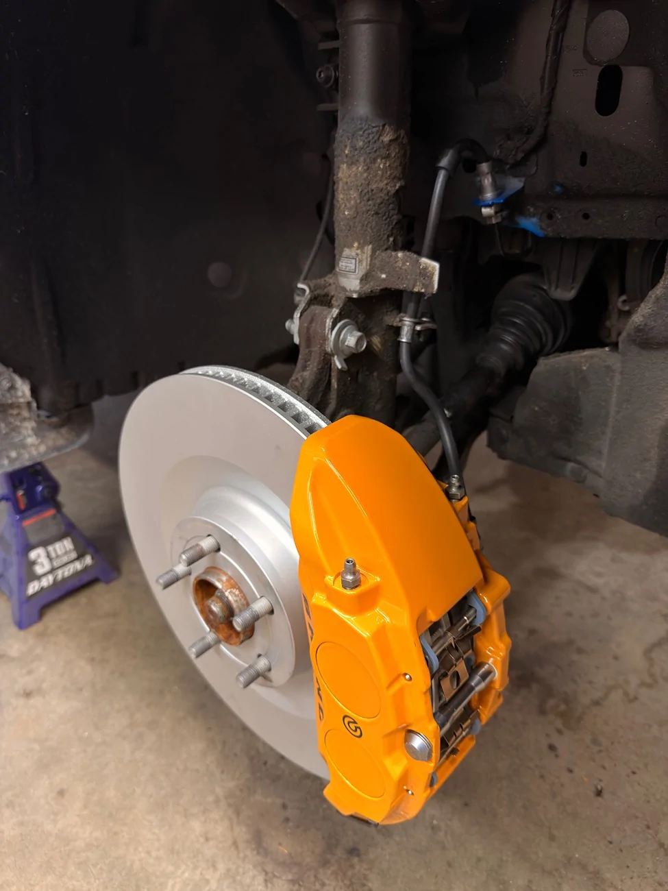

Anyone that has done this upgrade, have you had any issues with brake jounce hose length? Overall the Mach E brake hose is ~60 mm shorter than the Maverick's, so theoretically it'll be kinked a bit more under full rebound even if you reposition the hose/knuckle bracket.
Frenchy906
Joe
Jul 21, 2026
2025 Bronco Sport

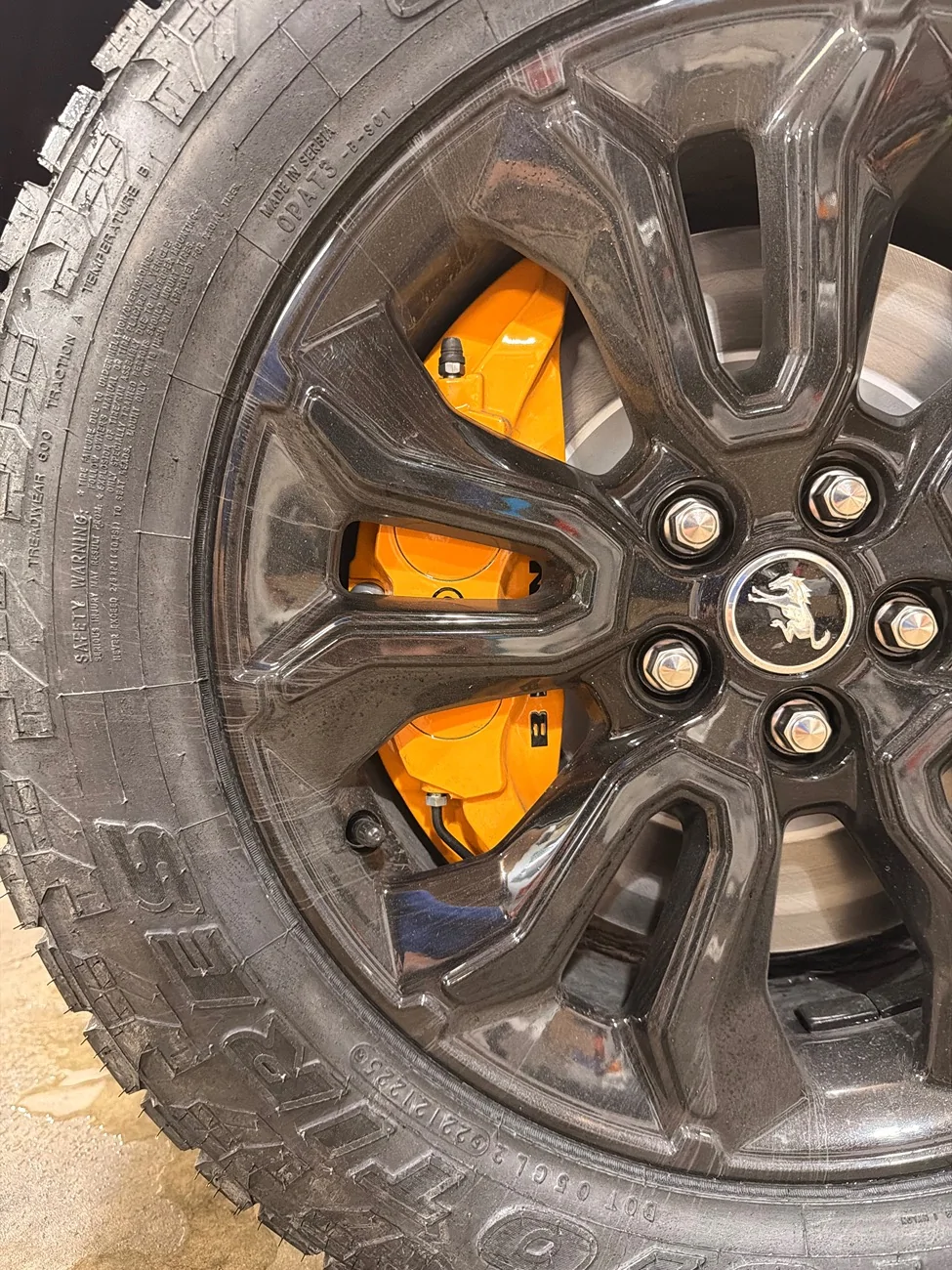

First post here. Coming from BroncoSportForums.

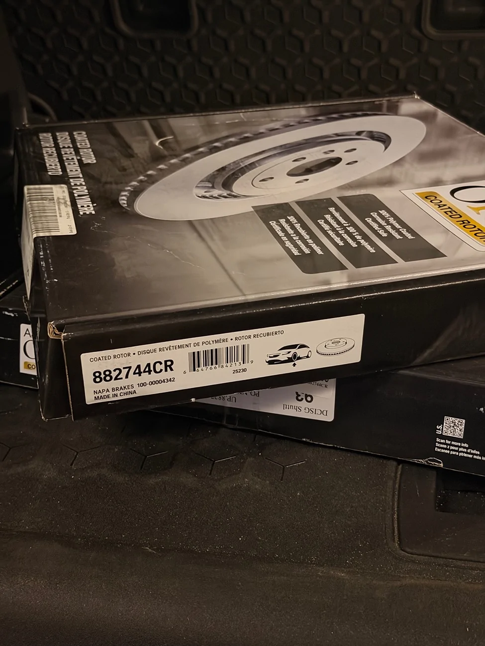

I followed the part numbers posted here, and cross referenced them to my work numbers (store manager at NAPA).
Managed to do the swap for about $410.
I upgraded to Ford Performance 18x7 wheels, and that’s the absolute smallest wheel that’ll fit.

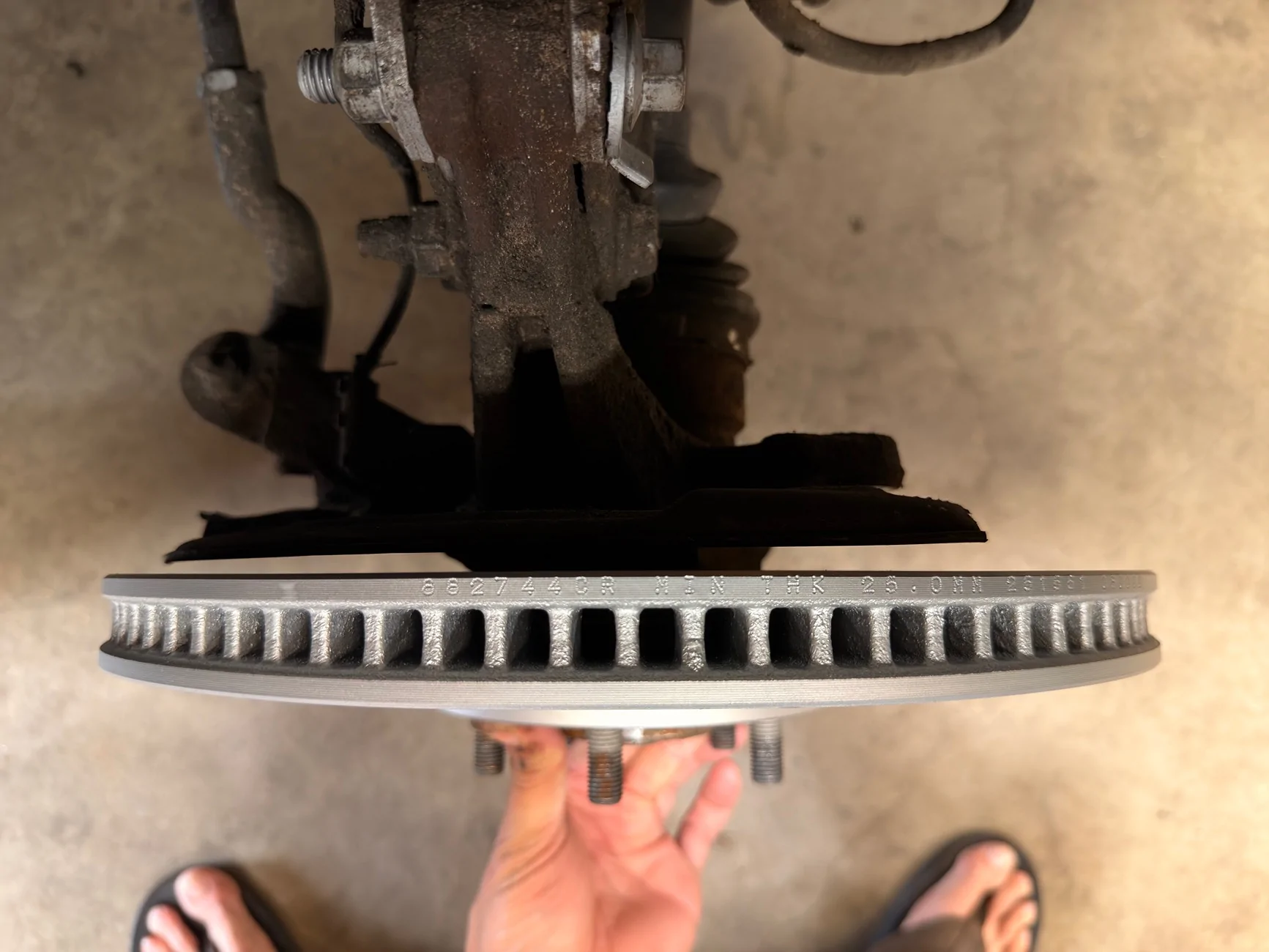

I’ve included some photos of clearance from the factory dust shields to the new rotors and the brake line hose. Have no issues with the hose length as I saw questioned on here.

Looks great, really like that orange...Is it school bus...I mean CyberOrange??

Can you post the Napa part numbers for the record?
LMFAO.
Actually, the proper color name is Valencia, or Grabber Orange as Ford later renamed it.
It’s as close to the Badlands logo on the door as I could mix up at work.
