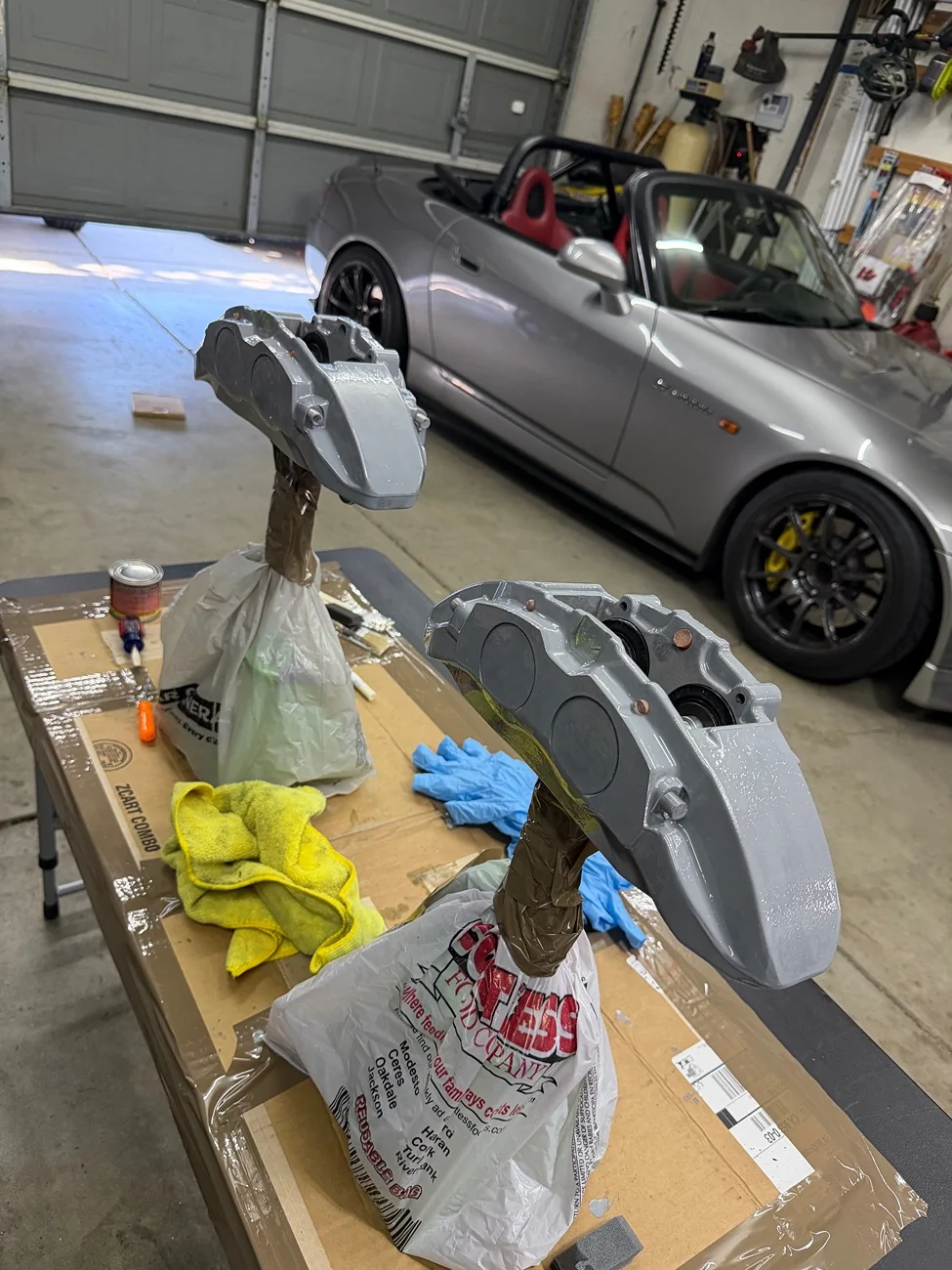

Camd out great! What blue is that?

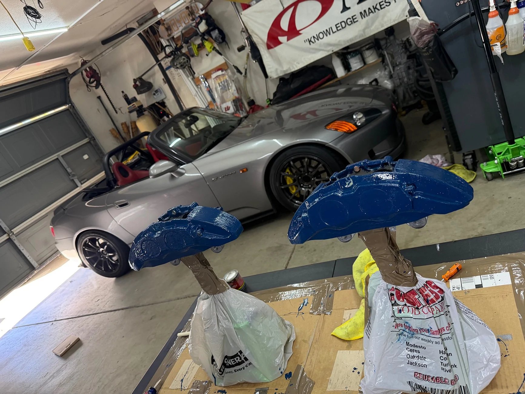

this was POR-15’s brake caliper kit blue.
Was hoping it was a bit more of a lighter blue to match fords ST blue but eh.
The kit comes with a metal prep then a primer before the color goes on.
The paint needs to be brushed on and it was difficult to avoid runs, and it isn’t brake fluid resistant (shocking) so I wouldn’t recommend it.

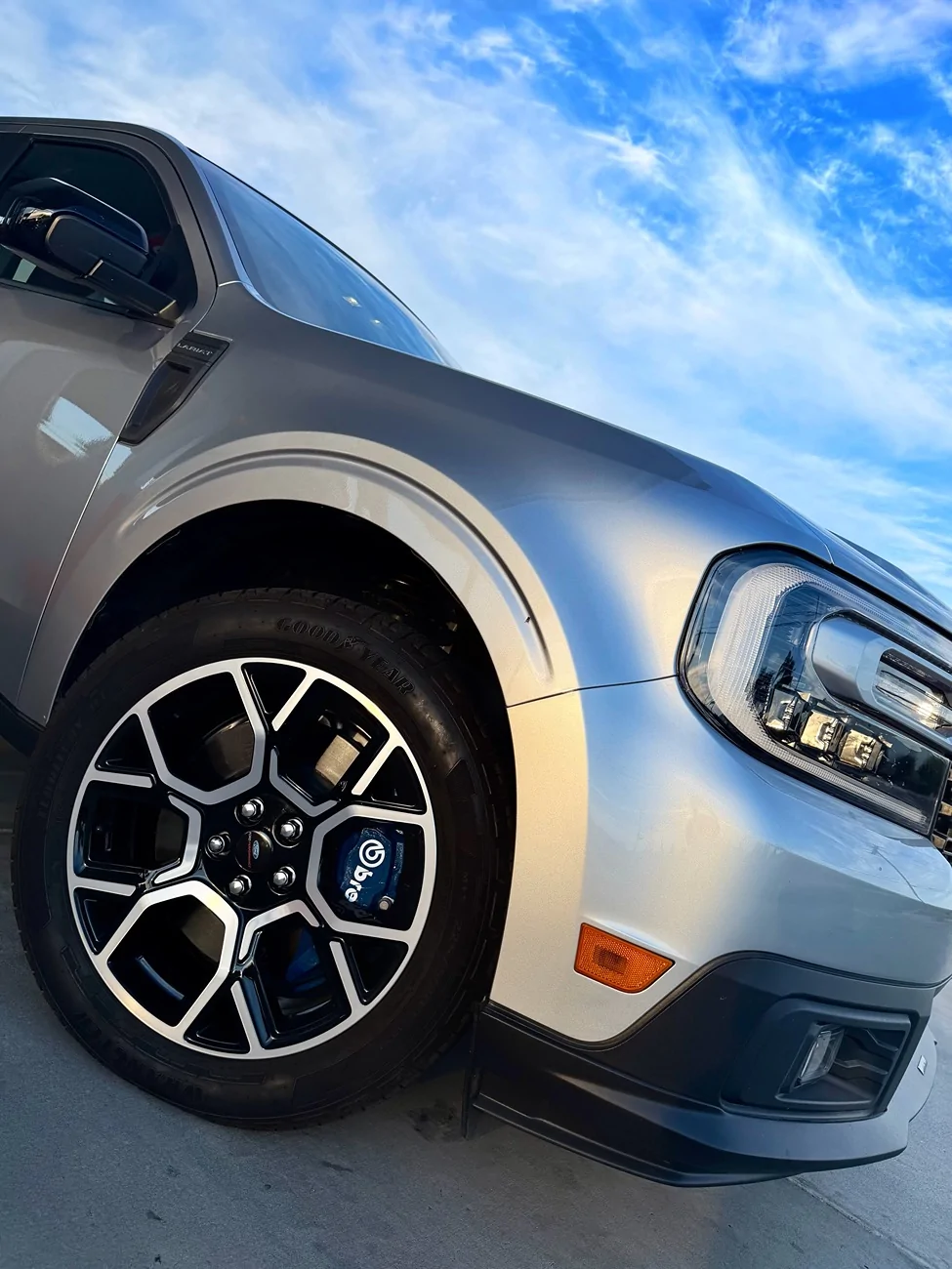

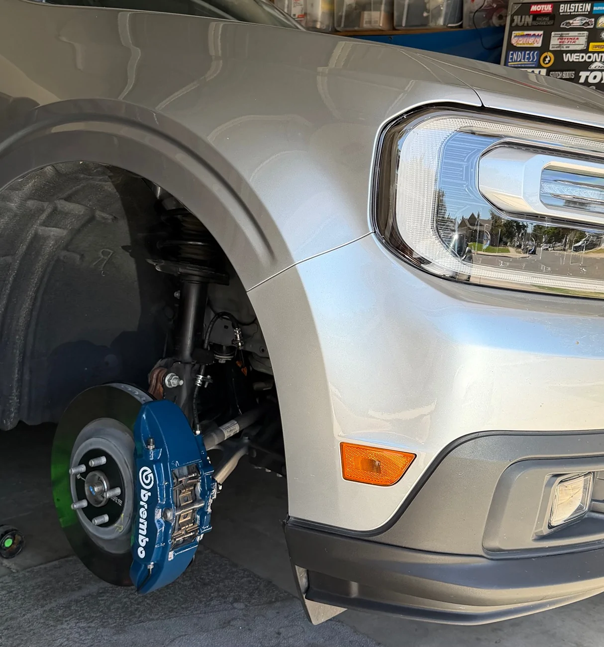

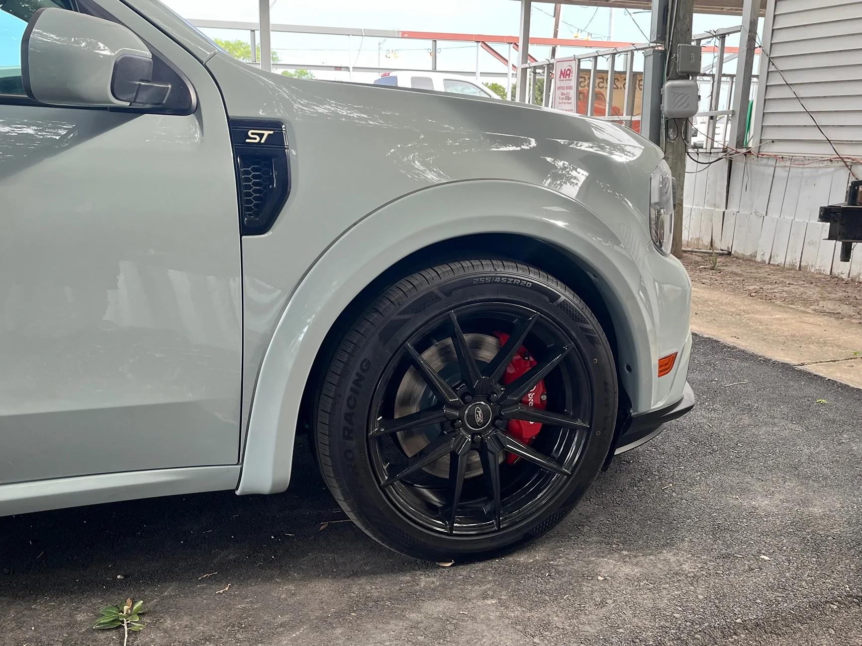

Welp after lots of reading test fitting and waiting on parts and paint to dry… she’s now got the most unnecessary mod installed :like:
just want to say thanks to everyone here for sharing this mod.
Looks great. What all parts did you use or which parts list did you follow?
Short answer I sourced everything off a 3,754 mile totaled out 2025 Mach-E (non performance) … the man wanted $60 per side, and I happily obliged and offered to take them off myself (I didn’t want him to change his mind lol)
calipers w/pads
Brake lines
Dust shields
