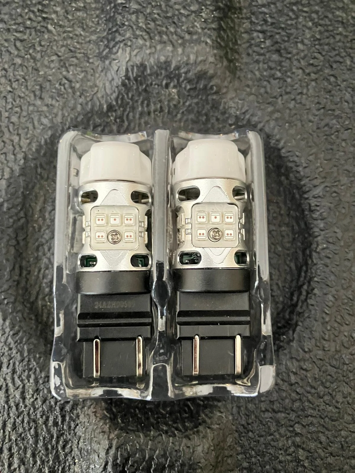

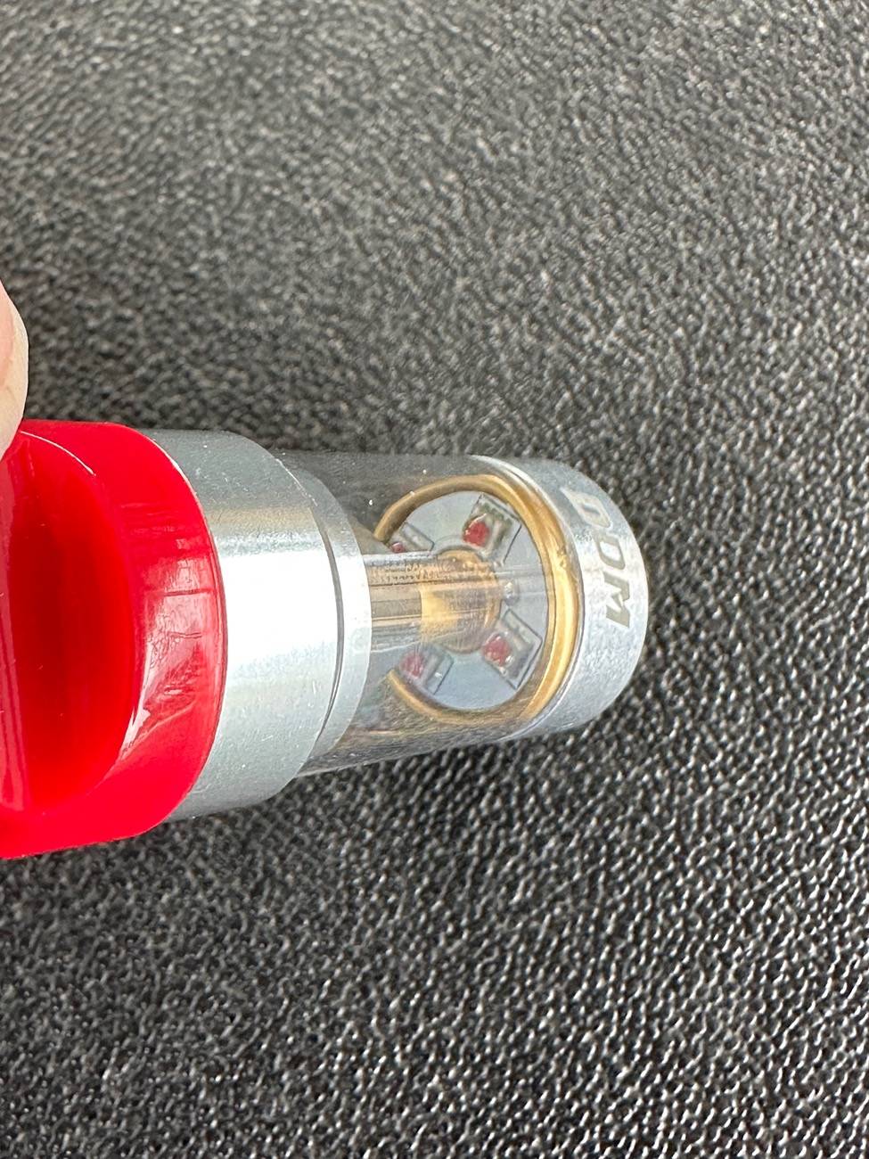

As a follow-up to my previous post (https://www.mavericktruckclub.com/forum/threads/removed-my-lasfit-backup-and-turn-signals.44210/), my LASFit bulbs failed again. This was my second pair, sent by LASFit as a replacement because the first set also failed. I've had my 2023 XLT Hybrid since June 2023, and both pairs have failed in this short time. LED bulbs should not be failing this early, raising concerns about LASFit's quality control.
I also had my recalls addressed today at my home with the Ford dealer Mobile Service, but the bulbs still didn't work after the updates. The service technician suggested I follow up with them because other users are also experiencing issues with LED bulbs, and identifying unreliable brands would be helpful. I replaced the LASFit bulbs with the original incandescent ones, and they worked perfectly. Given the repeated failures, I’m reconsidering using LEDs.
I've emailed @LASFIT with a video as they requested and am waiting for their response. Changing these bulbs twice, considering their cost and that they were the latest version, is frustrating and undermines my confidence in LASFit. While my switchbacks, reverse lights, and cargo/brake bulbs from LASFit are working fine, the turn signals are problematic. LASFit needs to improve their quality control to ensure these bulbs last as expected. I almost want a refund, but I bought them off Amazon and then when those failed, LASFit sent me the new ones. The side of the bulb that failed was the brake light, the running light still works for both sides. Last thing I need is to get hit due to faulty LEDs.
Below are a photo and video.
I am coming here to post my exacttt same story. They sent me the updated bulbs and my left upper bulb has taken a crap at about the 2 month mark.

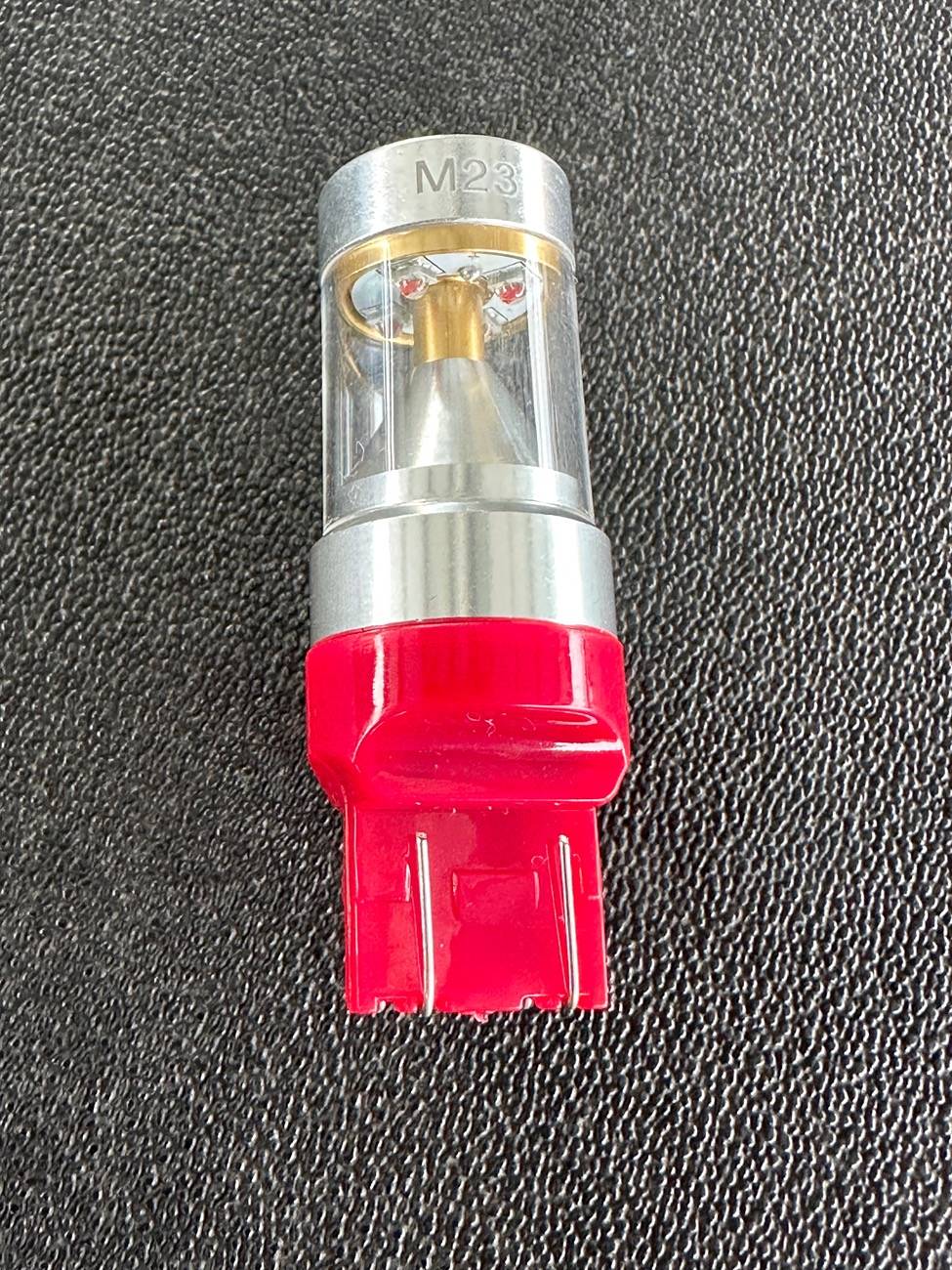

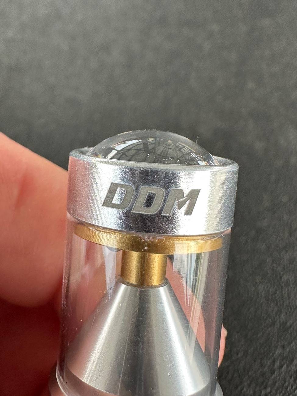

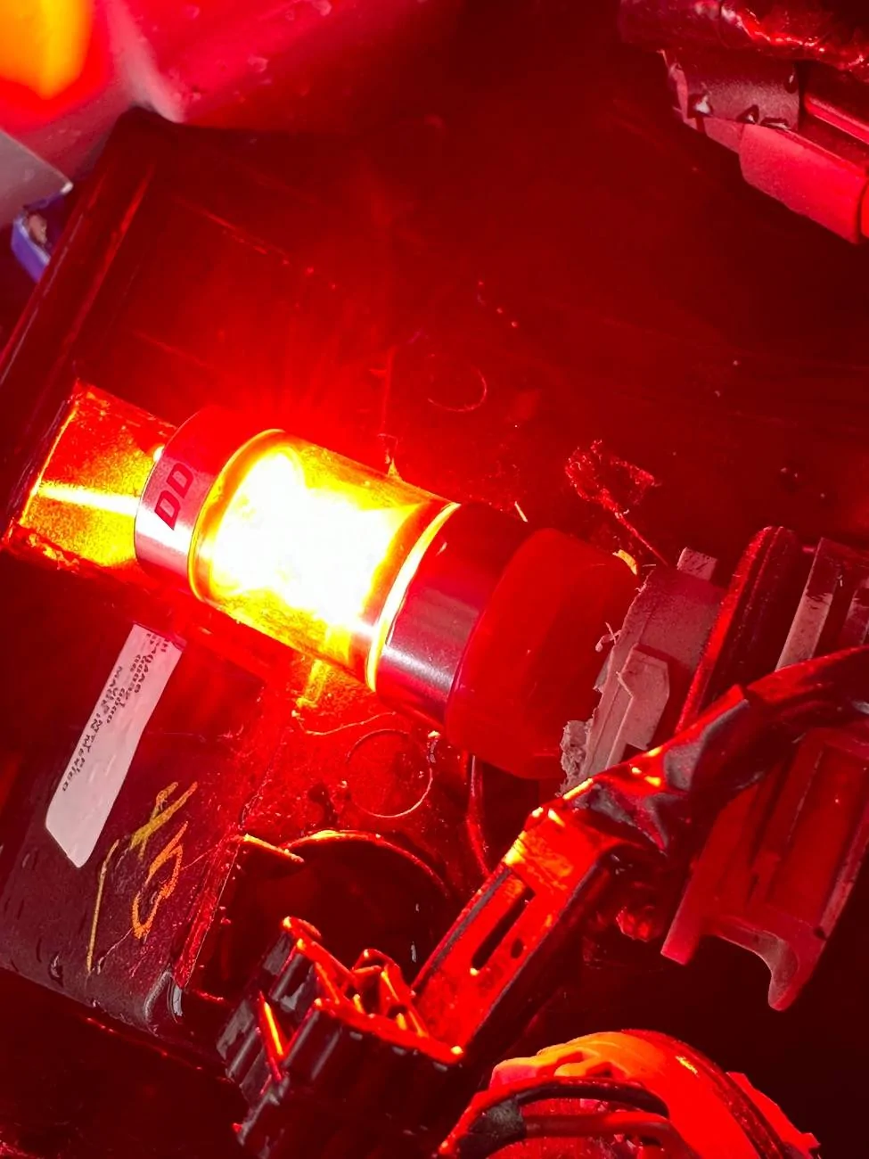

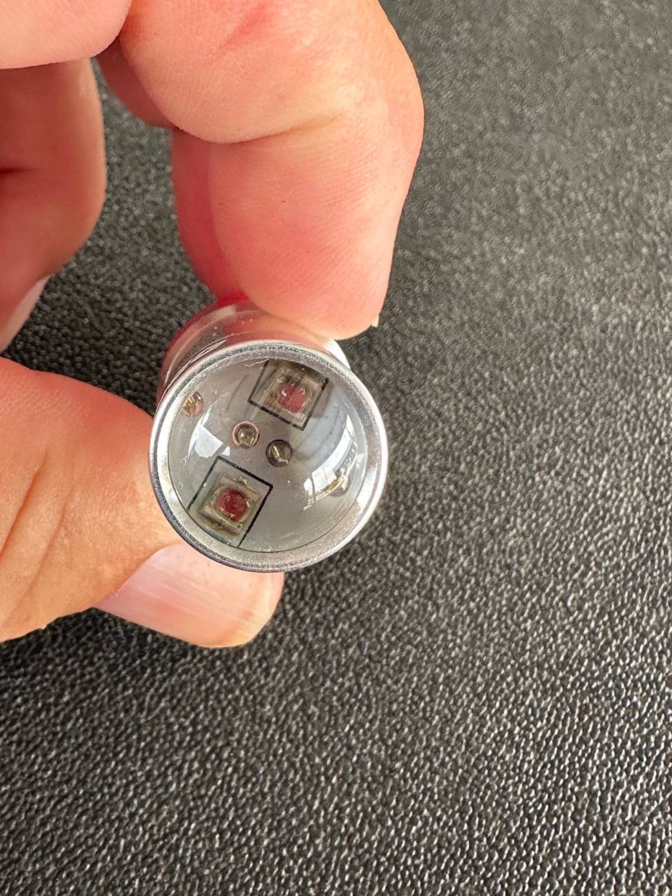

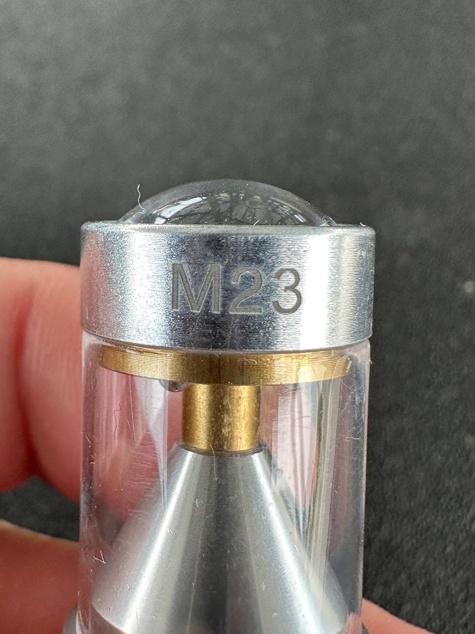

LAS-QUIT , says it all🤬. Found some really bright ones so far and have lasted a year. Did go into forescan and disable the outage. I’ve went thru 3 sets of LAS-QUITS and gave up on them. If you go to hi-power ones with fans, it will kill the BCM on the brake modules. The front turns will take what ever hi-power you toss in. I found the ones that are 4 sided or 2 sided work best with the reflector. These are what I ended up with.
https://a.co/d/dyWdVPc
