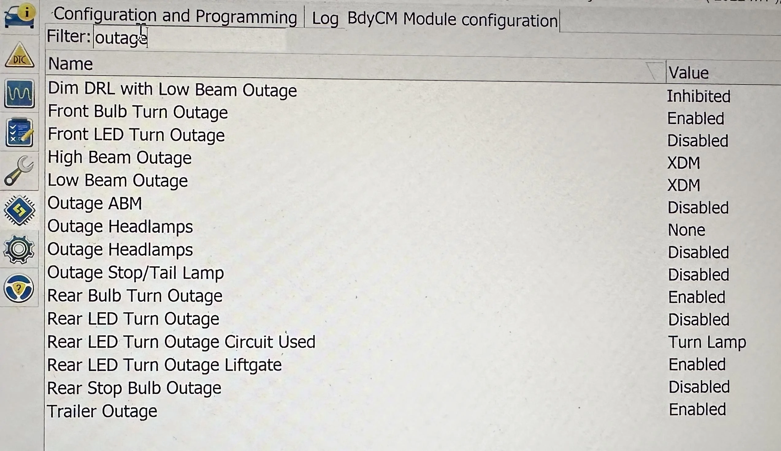

Using FORScan, I only had to disable REAR STOP BULB OUTAGE in the BCM Module to eliminate the Hyperflashing. I will keep it this way until a better fix is available.
@Brett3550 , so everything else is enabled, including the front?
Yes. Unless changing this setting automatically changes other settings. I didn’t bother to look at the others.
My fronts were disabled, maybe the dealer did it trying to resolve the problem.
Thank you!

Here is a screen shot of my filtered "OUTAGES." Again, I only disabled the REAR STOP BULB OUTAGE. I wish I would have looked at what was enabled/disabled before the recall flash.
