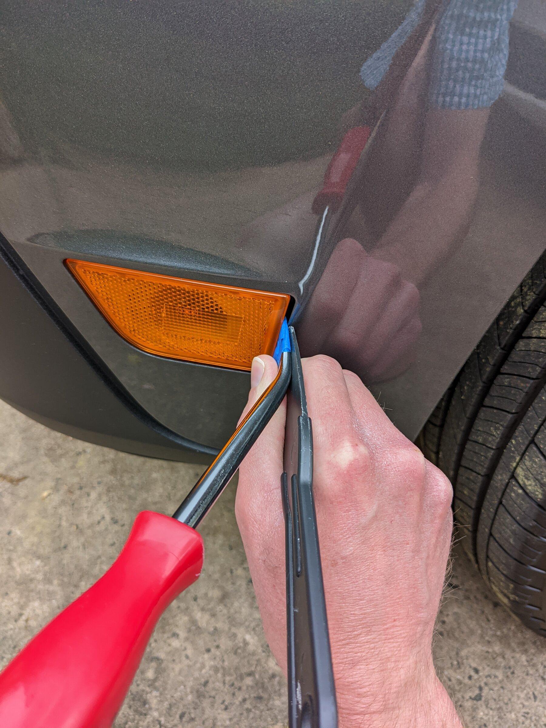

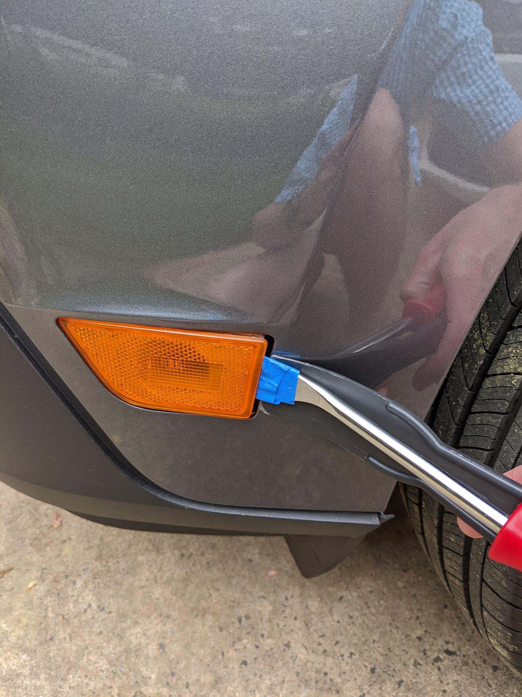

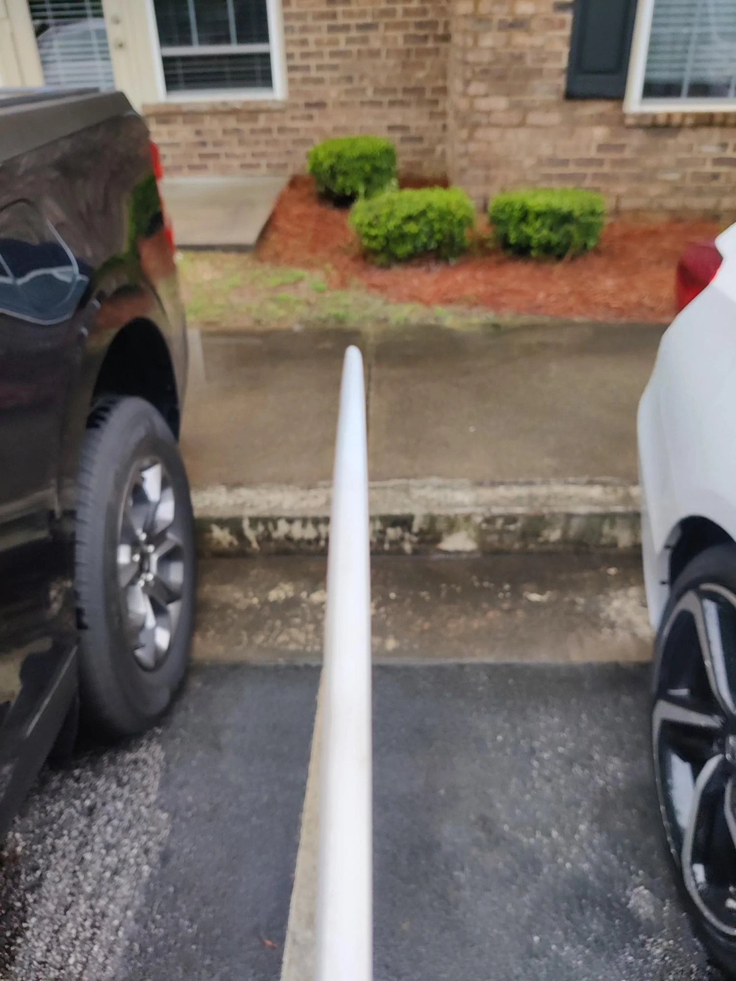

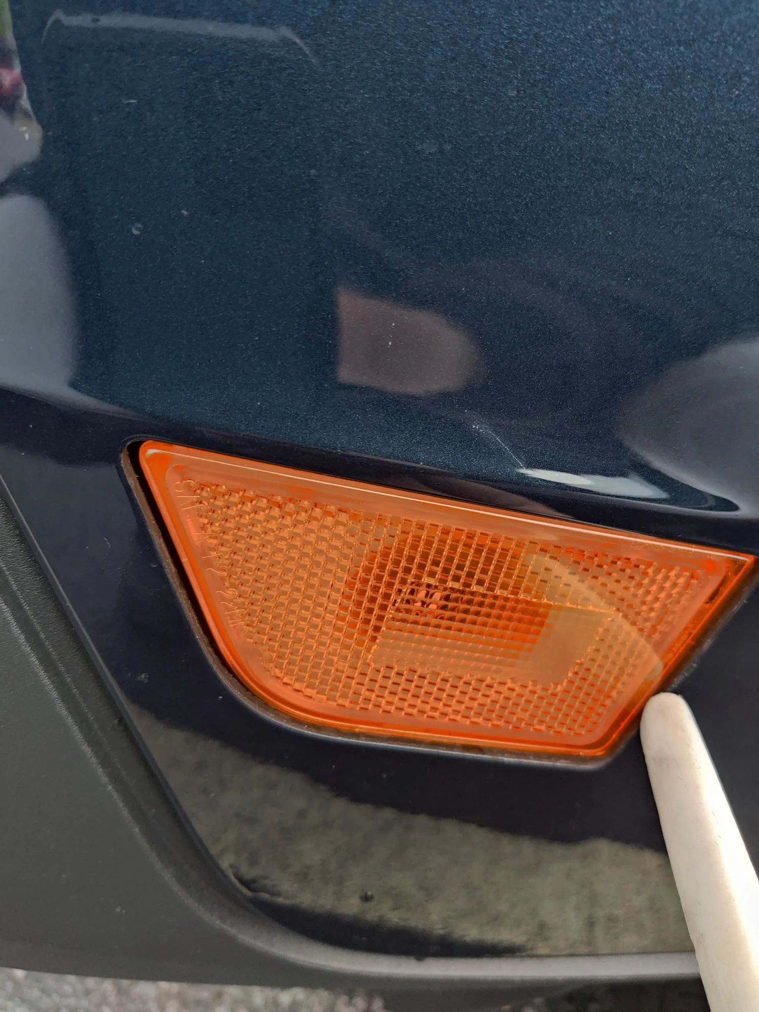

I used a variety of plastic trim tools and all of them warped the paint where pressure was applied
I’m following the manual and some prior posts here to correctly apply the pressure but really don’t want to cause any more damage than the minor paint wrinkle I’ve got now.
I get some movement but it doesn’t pop out. If anyone who’s done it this way can post an actual video, it’d be helpful.

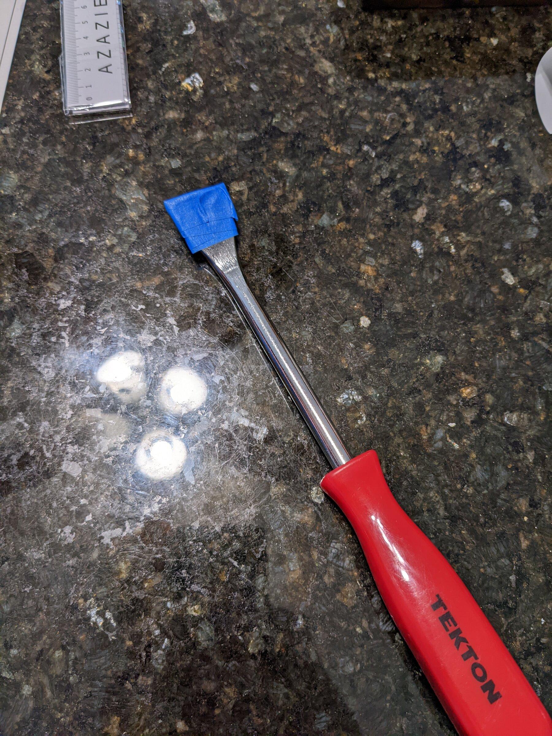

Here you go. Photos and video. I used a metal trim tool wrapped in painters tape and a plastic putty knife for leverage/protection.

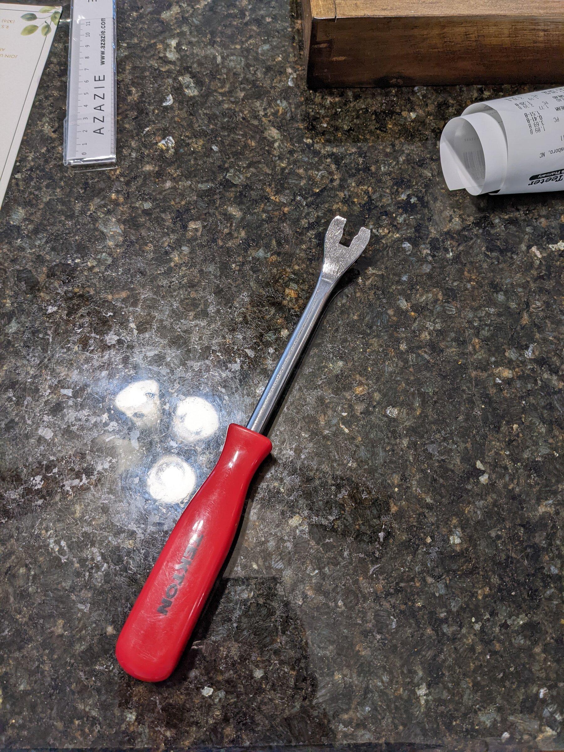

My brother I did our side markers a few minutes ago. It took about 2 minutes per side.
You need a plastic tool designed to get in the outside of each light reflector.
The plastic trim tool.didnt scratch or damage the paint
Just push in ward and pivot the tool, to the outside. The reflector will pop right out.

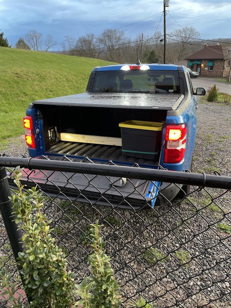

Can now confirm that the tail lights work flawlessly in a Lariat.
My truck is now all lasfit LEDs, except for the side markers which I still need to do. My only minor gripe is I think the front blinkers may be a little too bright, but I'll live with it
They are pretty dang bright, lights up the entire area in a flood of orange light bright. So bright that I will not leave my blinker on at night if in the turn lane and will turn it on just as my light turns green. Finally got a turn signal to hyperflash inside at a ridiculously long light the other day. Turned it off for a bit and back on and it went back to normal.
All of the LED light upgrades look awesome otherwise. The kit I ordered did not have the brake lights at the time of order. Debating whether I want to upgrade those or not.

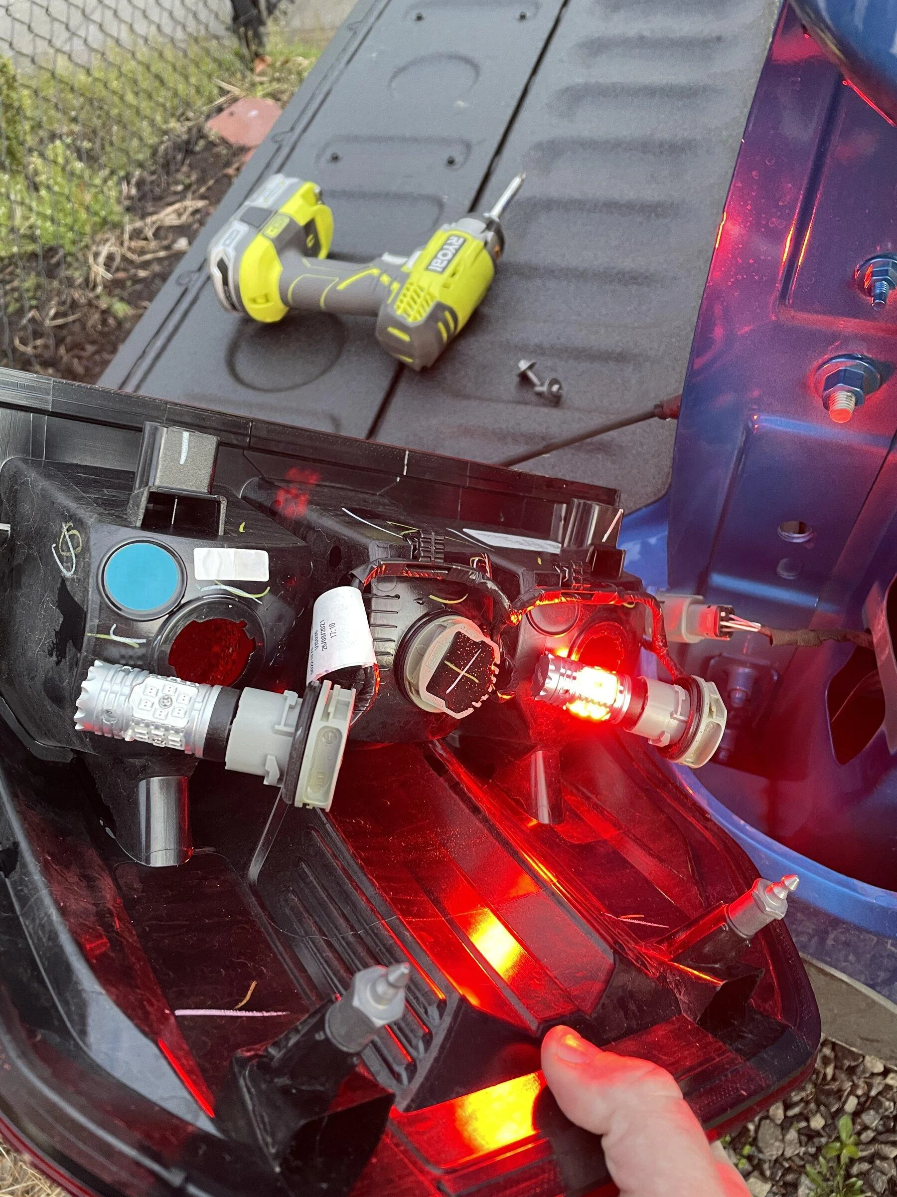

Just got the brake lights installed on my Hybrid Lariat Lux. Can also confirm everything is functioning as expected!
Really looks a lot better. As a note, I had to remove the wire clip like in OP’s video before turning the upper driver’s side bulb out.
Otherwise, the wire is too short to completely turn to remove.
