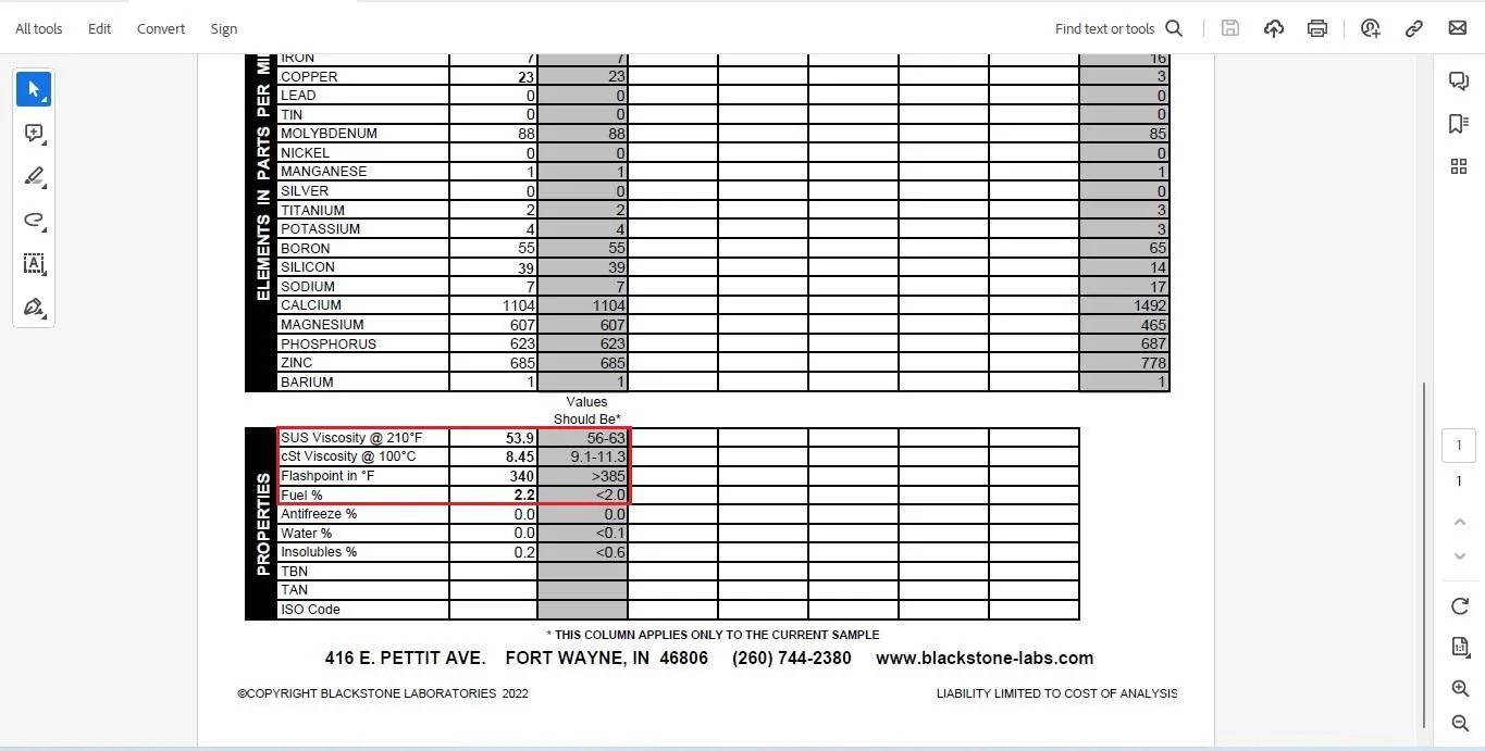

incorrect, I have posted used oil analysis which showed 2.2% fuel dilution after 5k miles which correlated to degraded viscosity and flash point. You really need to understand how direct injection causes higher fuel dilution especially when combined with forced induction. I wish more people were knowledgeable and used lab analysis rather than just using anecdotal "evidence".
Ford Maverick Is the oil dilution theory some BS? UOA 22 Mav

I have posted lab results via a used oil analysis which showed 2.2% fuel dilution which correlates to a degradation of both viscosity and flash point. What you're saying is based on assumption unfortunately rather than science. Also, fuel dilution is very dependent on driving style and driving conditions for each individual. What I do suggest is getting a used oil analysis based on oil in YOUR vehicle to determine if your driving style and conditions causes excess fuel dilution rather than making assumptions.
Thank you for your post and for the analysis. Do you know if there is a dilution percentage at which point the oil is considered worn out? Meaning, at what percent does the oil degrade to the point where it is no longer meeting minimum standards as required by the engines?
EDIT: please ignore, after taking a closer look at your spreadsheet, I see that was already answered.
A quick and dirty is looking at the flash point. Reference the sample and recommended range in his test data.
