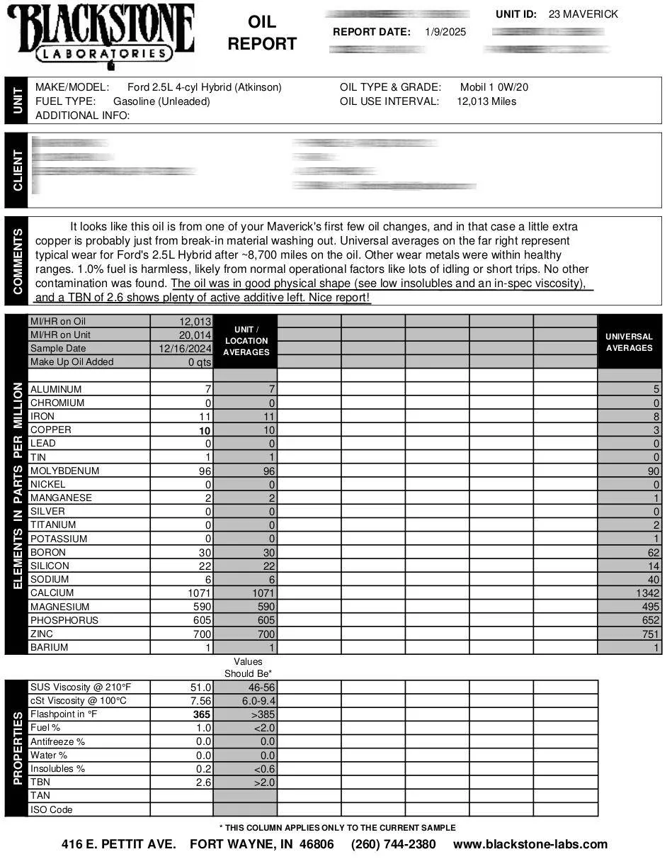

My last Blackstone oil analysis on an oil change at slightly over 12k mile interval showed fuel dilution at 1%. The "should be" value was <2%.
Ford Maverick Is Fuel Dilution a Hybrid Thing? (Blackstone) Blackstone_12k-on-oil_20k-engin
I thought fuel dilution was more of an ecoboost thing... (?)

I have done Blackstone reports on a Hybrid Escape and my Maverick.
Always in spec at 10k and 15k.
IT IS NOT A HYBRID THING.
At least not a NA Atkinson Engine thing.
