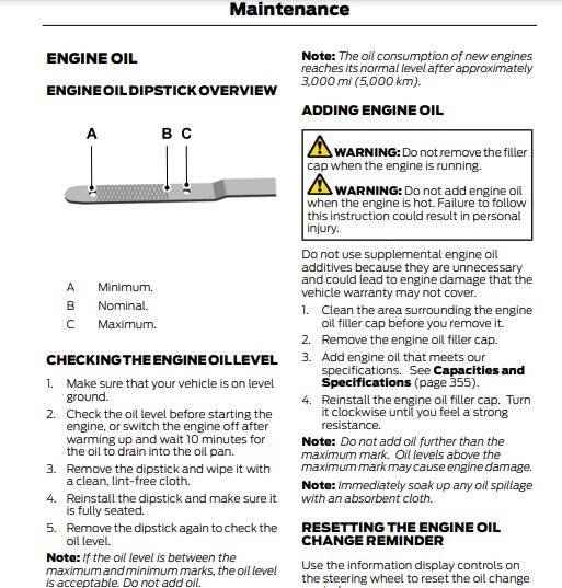

Yes. Too many assumptions. I see my oil level fluctuate that mulch regularly, and have no dilution issues. I mentioned earlier a few causes of this. It's every unlikely it's anywhere near that percentage.
How's your fuel mileage, and how is it running? That's a LOT of fuel that would show multiple symptoms.
You have it in your head that DI engines regularly have this problem and they really don't.
Fuel mileage is decent, considering my driving habits, and hasn't changed much except the expected summer and winter differences. I think my lifetime average is 19 something which has been pretty steady. Much higher on road trips, but most of the 6600 miles I have on the truck been in town. Engine runs excellent. Never a hiccup.

Your math is fine, but there is zero evidence that says the .25 qt there is fuel in the oil. As Tbone said, your nose will deceive you.
Keep checking the oil to watch it over time. At the next change, send a sample off for testing. Relax and enjoy your truck.
10-4, will do. (y)
Thanks guys. I do appreciate all the input!

In the pic below of the Maverick dipstick there's three points, A, B & C. I assume B is full and the distance from A to B would be one quart? If B is full (5.5 quarts) C would appear to be approx 1/4 quart more.
I believe my truck was at B the second to last time I checked it and it was at C when I last checked it.
0.25 quart (gas?) / 5.5 quarts (oil) = 4.5% fuel dilution.
That's pretty high, no?
Or, is there too many assumptions in my thinking?

My '23 EB oil level also varies from the "B" nominal level to the "C" maximum during the winter when driving less than 30 minutes in cold weather. It doesn't start dropping down unless I drive an hour or more, and interestingly it seems to drop quicker driving for long periods of city driving than long periods of freeway driving. I always check the oil level in the morning (before driving) to be consistent. I knew there would be some variation, but I was surprised that it changes as much as it does. My MPFI vehicles always have very consistent oil levels, so I don't think much of the change is related to temperature. So, I avoid driving the Mav during short trips as much as possible and change at 5000 mile intervals. When I see the level getting too high, I take it for a longer drive.
As a side note I have a friend with a 2.0L EB in a Lincoln who typically only drives short distances. At one point last winter he checked his oil level and it was significantly above the maximum hole.
