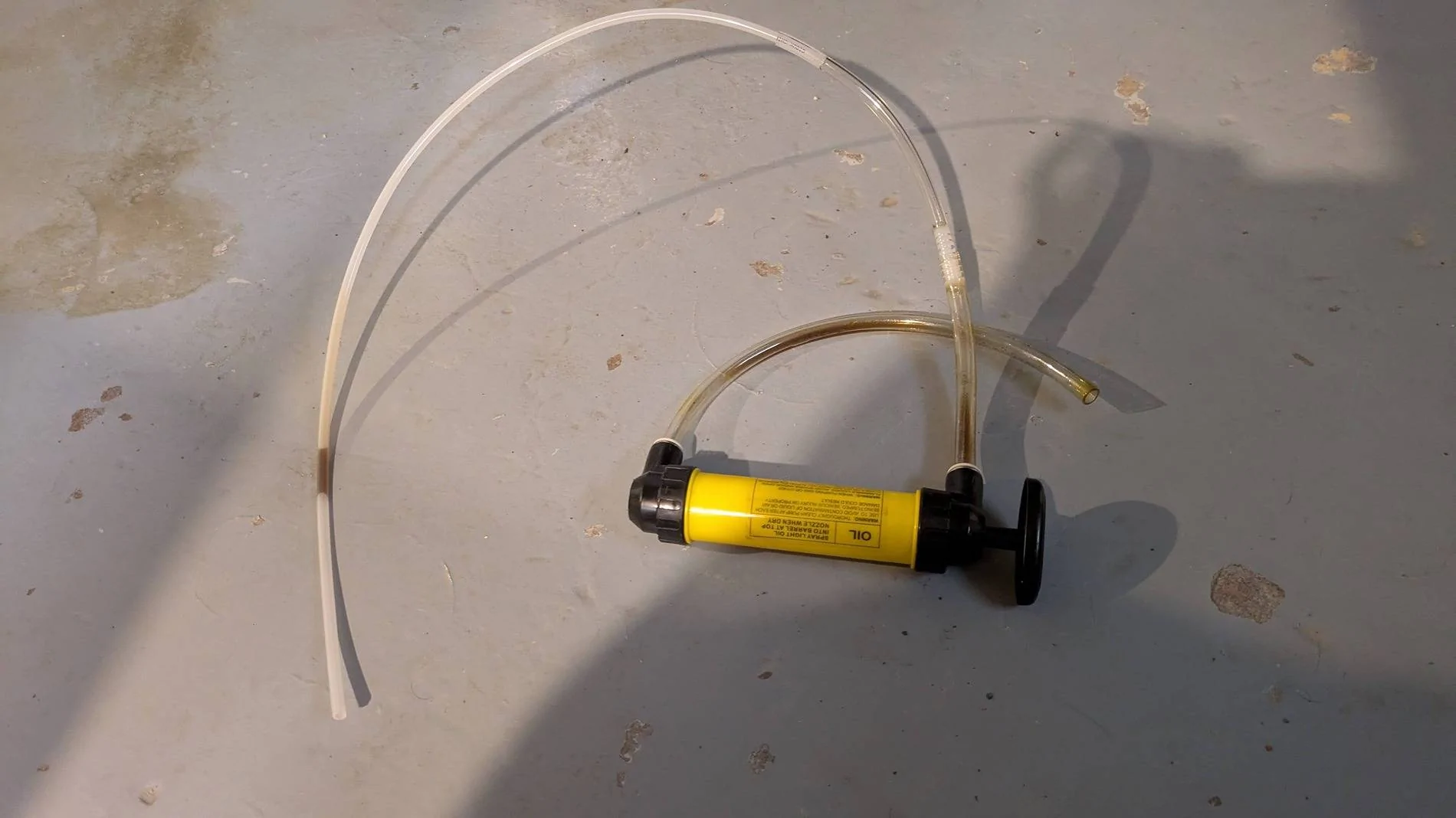

Just for git's and shiggle's, I thought I would see if I could put together something that could draw oil out thru the dipstick tube.
This is what I came up with and it worked great. If nothing else, it'll be useful for when the oil change dummy's put too much oil in the engine, which seems like about 50% of the time. It'll save me a trip back to have them drain some back out.
I used a pump made for oil and gas, and adapted it down to a 1/4" OD stiff plastic line. Slipped right down the dipstick tube and into the oil.
I don't know enough about OA's to know if this would introduce too much contamination from residual oil in the pump to be useful in getting an OA sample?
Set up so that the tube itself holds the fluid, and never reaches the pump. You're not going to lose much, I suspect, as you slide it out. Then cap with your thumb until release.
You could use a wider diameter tube for the segment that doesn't go into the dipstick to get it to hold more.
