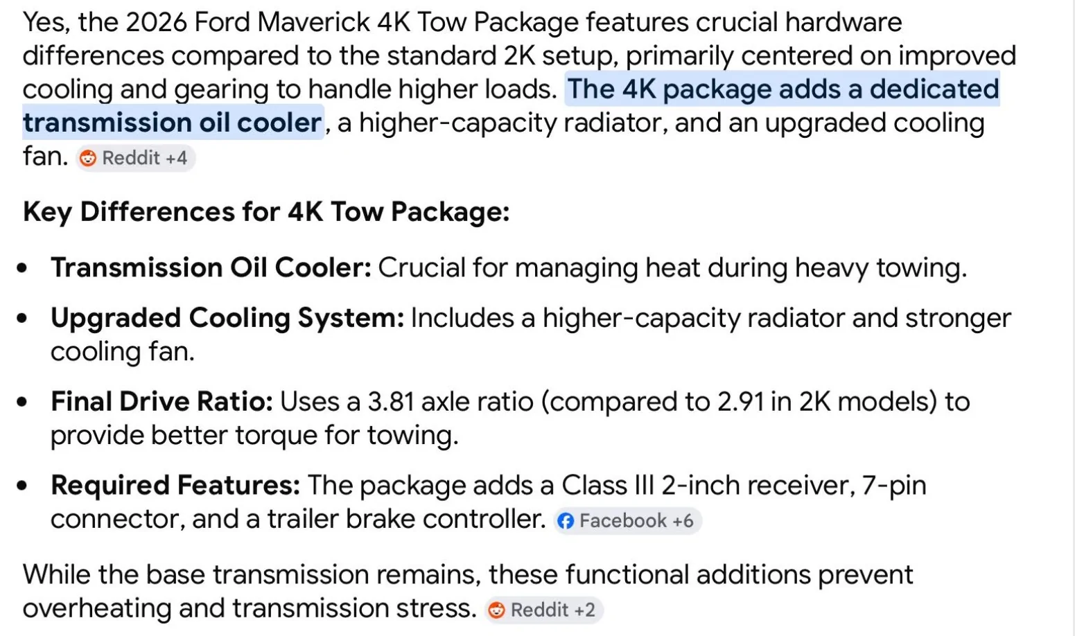

I only tow about 5 or 6 times a year but, For me, it's completely worth it for the added transmission protection
The final drive ratios are completely made up. Here is what they actually are.
3.37 (Hybrid)
3.63 (EB)
3.81 (4K Tow only)
