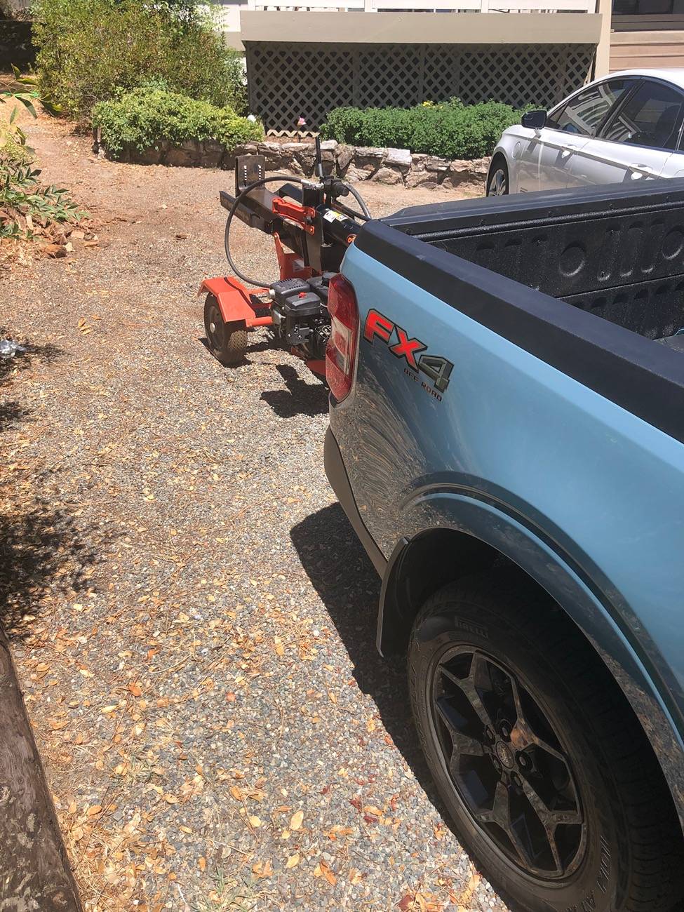

I got it and fx4 as well. I’ve only towed a log splitter so far, and yes you get a lot of add’l cooling stuff and 3.81 axle.
Trailer brake controller too…
Edit to add mpg. 26-27
