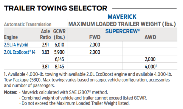

Actually the biggest thing is the GCWR on the door sticker is higher to be legal, goes from 6145 to 8145. Tow package is pretty cheap for what you get, kind of a no brainer if you are ever going to tow anything...the bigger radiator and trans cooler will help engine/trans last longer even if you dont tow.
The FX4 package also includes the bigger radiator and cooling fan. Just not the tranny cooler.
