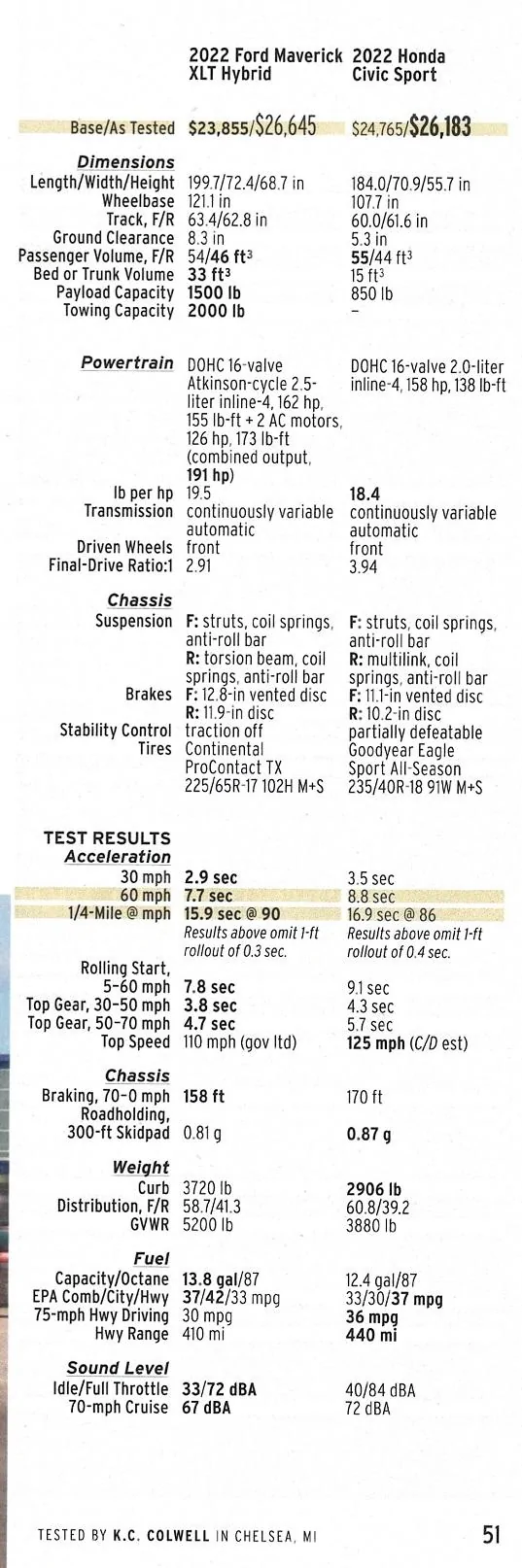

Not to argue or dismiss your results but this months issue of C&D did a comparison test and part of the test is measuring the sound levels.
Here are the results from the test. At the bottom you can see under the Sound Level section at idle/full throttle the dBA was 33/72 and at a 70-mph cruise it was 67 dBA. Here's a scan of the article so you can see the trim level.
Ford Maverick Interior road noise sound level comparison. Maverick = 49.5 decibels Car&Driver Mav stats

No offense taken at all. My test was done with a phone and app so the results were crude at best. I trust the CD numbers way more.

I just did a quick and dirty test on my Hybrid XLT.
At 70mph the average was 64db
At 55 mph the average was 60db
sitting in my garage was 18-19db with no sound.
My test results are much closer to what C&D got in their testing. Noticed C&D did their test on an XLT... but could a lariat really have 10 db worth of sound reduction? I have a hard time believing the noise reducing windshield would have that much of an effect.

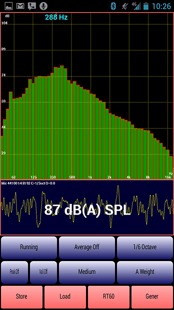

All these numbers sound silent in comparison to an old Honda, aluminum-chassis daily driver I had years ago. This was AFTER installing 130lb of MLV, butyl panel dampening, and decoupling foam between them, on the floors and halfway up the walls/doors...
Ford Maverick Interior road noise sound level comparison. Maverick = 49.5 decibels a-weight
The acoustic treatments didn't change the SPL, but it shifted everything down in the spectrum - it was far less annoying at lower frequencies. This was with a calibrated SPL meter held at driver ear level, Oregon roads at only 55mph. Cross the border into Washington State and it would drop 12dB.
People complaining about Maverick road noise don't know what noise is. The Maverick may not be as quiet as a V6 F150 where all four wheels are further away from the cabin, but it's quieter than a lot on the road, and much quieter than the common hatchback.
Road tires will also be quieter than all-terrains. Low rolling resistance tires will be louder.
