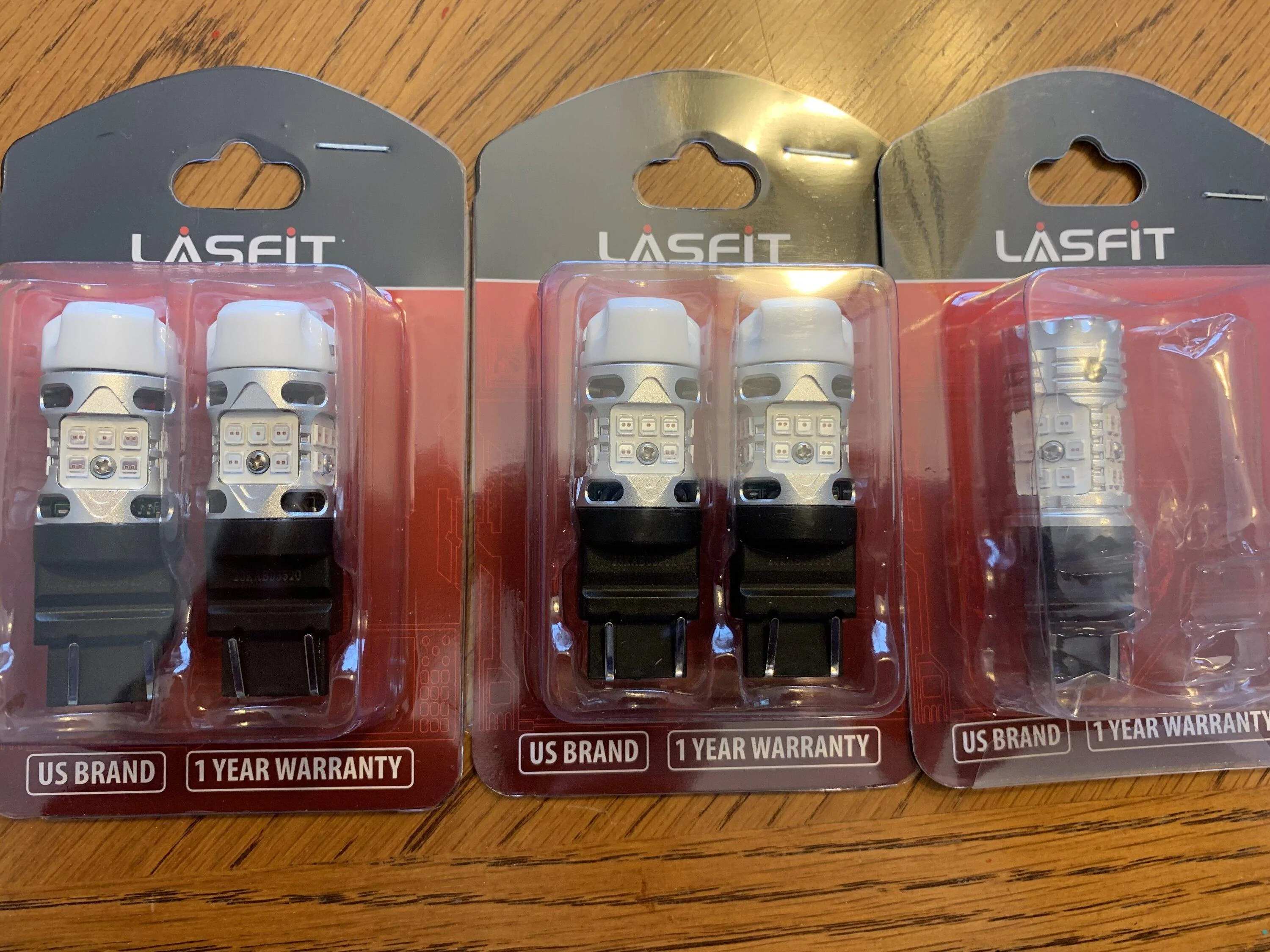

I did have Ford mobile service update the software and the update did make the dash turn signal indicators hyper flash. Since I still had a few weeks of warranty left on my Lasfit bulbs, I applied for a warranty claim with Lasfit. They quickly responded and sent me new replacement led bulbs for my evaluation. After correspondence with their customer service representative on correct installation ( correct pin polarity) I can say that the new bulbs work perfectly. Lasfit mentioned that the new bulb has a stronger resistor. I noticed that the new bulb’s have fewer led elements but they appear to be still very bright. No hyper flashing and now my software update app to work correctly also.
Ford Maverick Hyper Flash after Turn Signal Recall IMG_0768
