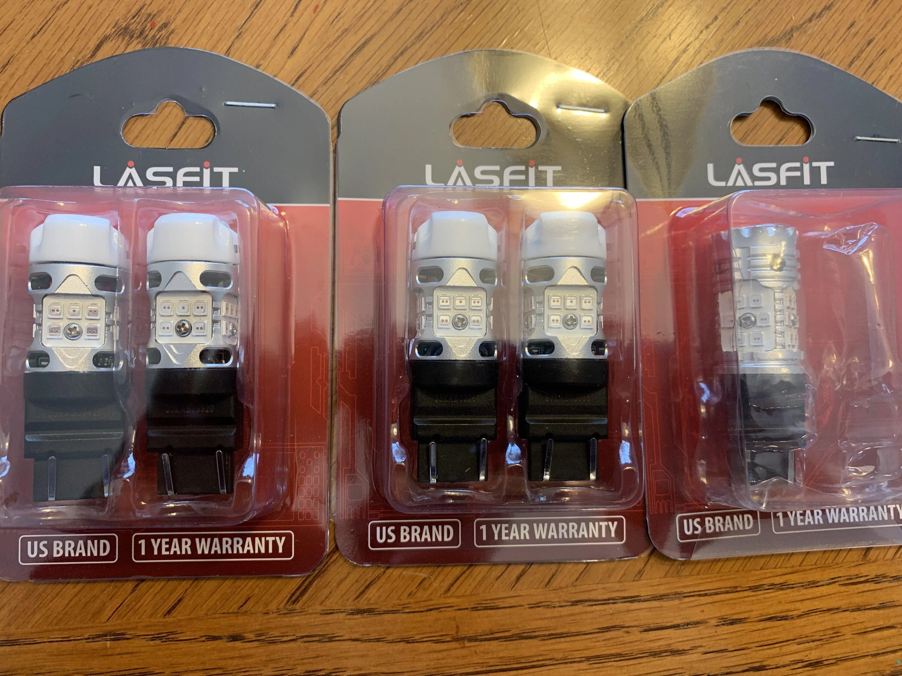

Lasfit was very quick to reply when I mentioned the issue with hyper flashing on the dash turn signal indicators. Lasfit quickly sent me the new T3 led bulbs to try out for evaluation. After installing the new bulbs, one lamp would not illuminate. After writing Lasfit again they suggested that I install all 4 bulbs and then reverse the polarity on the bulb that was not working. This morning after changing the polarity on the one bulb, I can say that all of the bu are working perfectly with NO hyper flashing on the dash indicators! Same brightness as before and operating perfectly! The old style bulb is on the right with new T-3 bulbs on the left. One less led element on each side, 4 total less for each bulb.

Rflick
Ron
Jun 21, 2021
103
174
Granger,In
2016 Buick Encore + ordered Maverick
@Rfick. Great post on the outcome with the new T3's. Thanks!
Can you please explain your last statement: "One less led element on each side, 4 total less for each bulb."
After your dealer upgraded the software for the turn signal recall, hyper-flash went away because you:
a) swapped the old Lasfit LED bulb with the new T3 upgraded bulb on the left side, and kept the old Lasfit LED bulb on the right side?
b) swapped the old Lasfit LED bulb with the new T3 upgraded bulb on the left side, and kept on the right side the original incandescent bulb that came with the truck?
Thanks again!
In the photo if you look closely to the new T-3 bulbs there is now only 5 led elements on each side compared to having 6 elements on the old style pictured on the right of the photo. Lasfit indicates that a stronger resistor is being installed in the new T-3 bulb. When I originally replaced the older Lasfit led bulbs, I started with just one side to see if the new bulbs worked correctly . Without replacing all 4 bulbs at once, the dash turn signals indicator would still hyper flash. All 4 bulbs changed and all of the bulbs worked perfectly with no hyper flash on the dash. Hopefully I explained this better. lol
