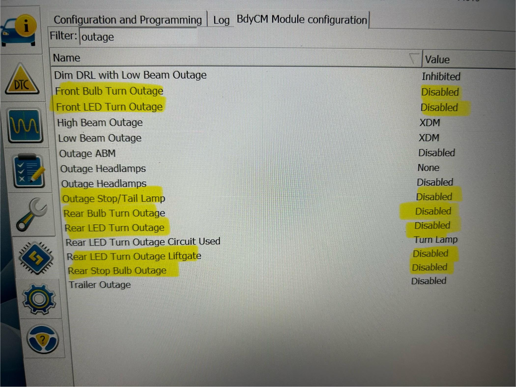

All, I have successfully found all the settings in the BCM to change to eliminate hyper flashing. I have all first gen Lasfit LEDs including switchback turn signals, reverse lights, rear braking and turn signal lights, and third brake lights.
See the photo below.
Under BCM you can filter to “outage” to get them all in one place. I did them one at a time but in total there should be around 4 or 5 to disable.
Note: the screenshot is just the BCM filtered to the word “outage” I did not change all of these settings that are shown.
Edit: highlighted in yellow
I can confirm this works. I have a Lariat and the original LASFIT bulbs, and there have been a few posters on here that indicated they only had the front LASFIT bulbs and post Ford Recall never had hyperflashing in cab...so made me rule out the fronts. So all I disabled was the bottom 4 highlighted (in the attached photo). I was debating not doing the last 2 (rear led turn outage liftgate, and rear stop bulb...aka I believe top mounted bulb..) but figured seeing I changed them all to LEDs, to disable them at least for now. Also I wasnt sure what "LED turn outage liftgate" actually meant...anyone have an idea?
My plan is when LASFIT has bulbs that are updated (hopefully) that work with the Mavericks post recall and Lariat (being different socket I guess), I will purchase the new LEDs and then turn the bottom 4 back on via Forscan...aka the reverse of what I just did this morning. Took me all of 10min to do, mainly because I am a big noob when it comes to forscan.
But otherwise this does indeed work post recall and stops the hyperflash in cab.
I did the same as you, works perfectly!

If any of you have the LASFIT bulbs and are experiencing hyperflashing on your dash after the recall update, I only had to disable REAR STOP BULB OUTAGE in the BCM Module to eliminate the Hyperflashing. I will keep it this way until a better fix is available.
