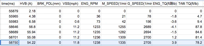

How about the thread that displayed the ice rpm. I do not know what the cycle rate for the RPM reading is but when the ice started the rpm jumped in less than a second from 0 to 810 in his video. If you blinked you would have missed it. Perhaps someone could observe the 3ph starter/generator in action?
From a log, not warmed up as 1st drive of day, so motor provided the torque until later.
Can't show the whole picture from 0 RPM to idle RPM - too much screen, so little start and ending time.
0 RPM was 55879 ms.
1235 was 58689 ms.
2810 ms / 2.8 sec
Engine kept at idle and no power used until about 88164 - so 32 sec of no load warmup. 81 F outside, cat 1000, coolant 100 F.

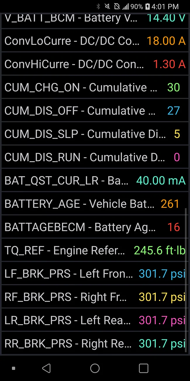

Regenerate rate/effect is different (L is actually the highest) - but the amount regenerated is the same whether the mode caused it with coasting, or your braking caused it - as long as you stay outta brake dust, it's all a matter of which makes it easier for your foot and terrain and traffic.
Cabin heat is ICE - unless the ICE is running and you have it set to max heat (High) - then 3 electric heaters will come into play.
Combined torque listed in truck system PIDs (below TQ-REF) for doing math in modules - 245.6.
That's your max potential from them anyway.

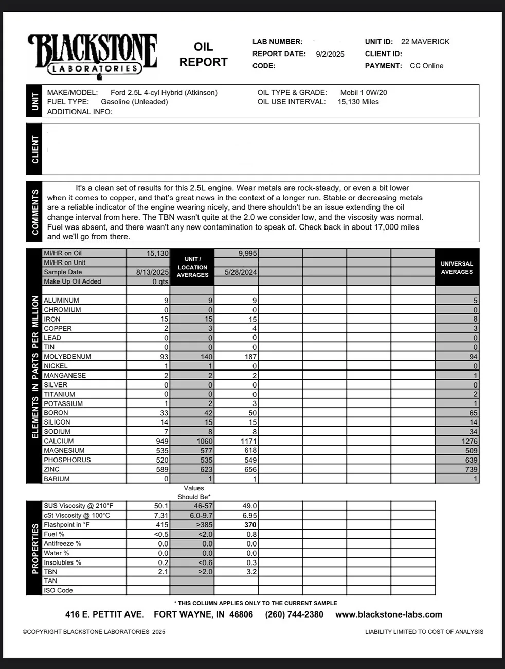

I average 46 MPG not towing.
I tow 3000 lbs 10% to 20% of my miles.
Commutes are 50% city 50% highway.
Two separate oil fills.
The 10K used and 15k used oils are nearly identical.
TBN is Total Base Number and indicates additives remaining.
Plain Mobil 1 used both times. Not Hybrid specific. Hybrid formula I may try going to 20,000 miles.
Those wear numbers are very low for that many miles and type of driving you do (especially towing 3k on the '22 hybrid). <2 / 1000 miles is very, very good.
M1 is good oil. Like you, I used it on my wife's Prius for many years however it's lead to oil sticking up the rings and starting to cause it to burn oil. So far, Valvoline Restore & Protect has reduced the burning to almost 0, so I've switched to that for now.
