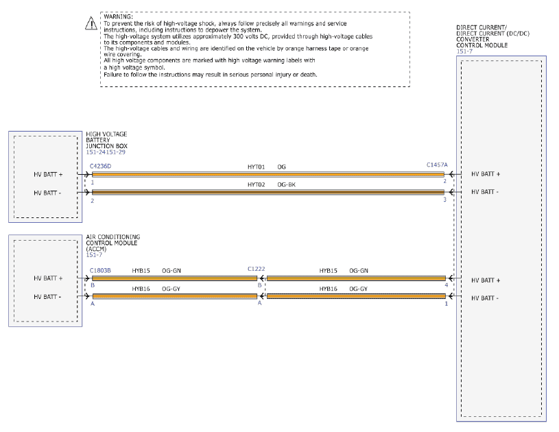

I realize that this is an old thread - I came across while looking for information on the hybrid Maverick AC.
I haven't been able to find a wiring diagram of the High Voltage system, I'm guessing that the AC compressor is wired directly to the High Voltage battery?
I assume it is 12v, like everything else not drive train related, so it is powered by the 12v system I believe. It could be powered right of the inverter though, so it could be more than 12v.
It's on the HV system via the DC/DC converter.
It is not powered by the 12v battery it is powered by the HV 450 volt battery pack via an inverter to turn that DC 450 volts to AC volts.
It has a bright orange cable going to it. Orange Cable equals very high voltage.
In the picture below the bright orange cable going from the middle back then to the left side and down to the left of the radiator is the HV cable that powers the AC.
Not sure the rating on these compressors but automotive electric AC compressors can easily use 3+ kW. You're not going to be drawing that from the 12V system, especially not with these tiny 12V batteries.
In general, for systems that were typically powered by an ICE, the electric version is probably going to be driven by the HVB. If it's typically driven by 12V even on an ICE vehicle, it's still 12V on a hybrid/EV. ICE AC is typically belt driven off the ICE.
By the diagram @Darnon posted. He meant the AC compressor is driven by the HV battery but it is connected to the HV side of the DC-DC converter NOT the 12 V side.
Also the compressor is variable speed. So depending upon the cooling load, it will run at different speeds.
