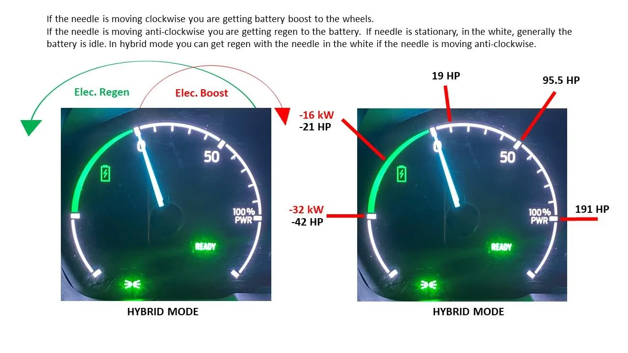

I'd always been curious if that 10% line on Power Meter before ICE kicked in, was based on traction motor torque and RPM, or what the battery is supplying for power.

(I just realized I'll need to get some figures for like 20% and see if indeed engine Tq & RPM are used.)

So mighty close in each case, and unknown if that data was right at moment of dial at 10%.
Hmmm, might have to search the IPC PIDS for needle location if such exists.
Anyway, thought it was interesting, and it appears perhaps the A & V are used to calc HP for that up to 19.1 at the 10% of gauge.
