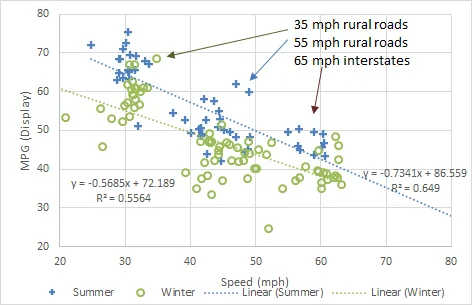

Using A/C on the same afternoon route (20 miles) I've gone from 50-55mpg to 41 mpg. As for the ICE needing to run more...

In my experience, I go from 41 to 55 mpg regularly depending on the route terrain. You know the area; I'm driving from Bushnell's Basin to Southern Tier cities like Ithaca, Elmira, Corning, Hornell, etc., on rural roads, and returning to Henrietta on I86/I390, then driving home. Given the speed and temperature dependence, I plot against average speed, and show Summer (June-Sept) and Winter (Jan-Mar) populations.
Ford Maverick Hybrid power train and air conditioning? 1625554474986
AC is on for all the Summer trips, but the data says the large spread is due to varying routes and weather (rain).
