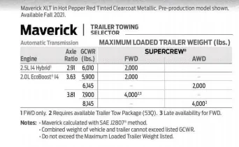

^Yes. The taller the final drive ratio the better suited for towing.

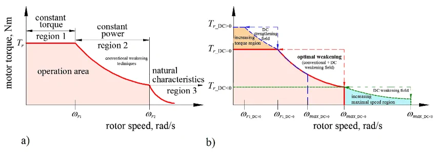

Electric motor torque/HP curves are generic. Peak torque occurs at 0 RPM, but so does peak current load, so all of these motors are current limited in the constant torque region, from 0 RPM to the "torque peak" where current requirements start to fall, along with torque. HP is flat in this region. The challenge is handling the current necessary to produce 94kW. It's a ~211v HVB, so do the math... 94,000/211 = 445 Amps.
Ford Maverick Questions on Hybrid power plant. 1627926063968
Compare the curves and you see that the ICE torque peaks at high RPM, while motor torque peaks at low RPM. That's why the "total" isn't close to the sum of the parts. The specs describe what the control system will provide, not the inherent capability of the combination.
