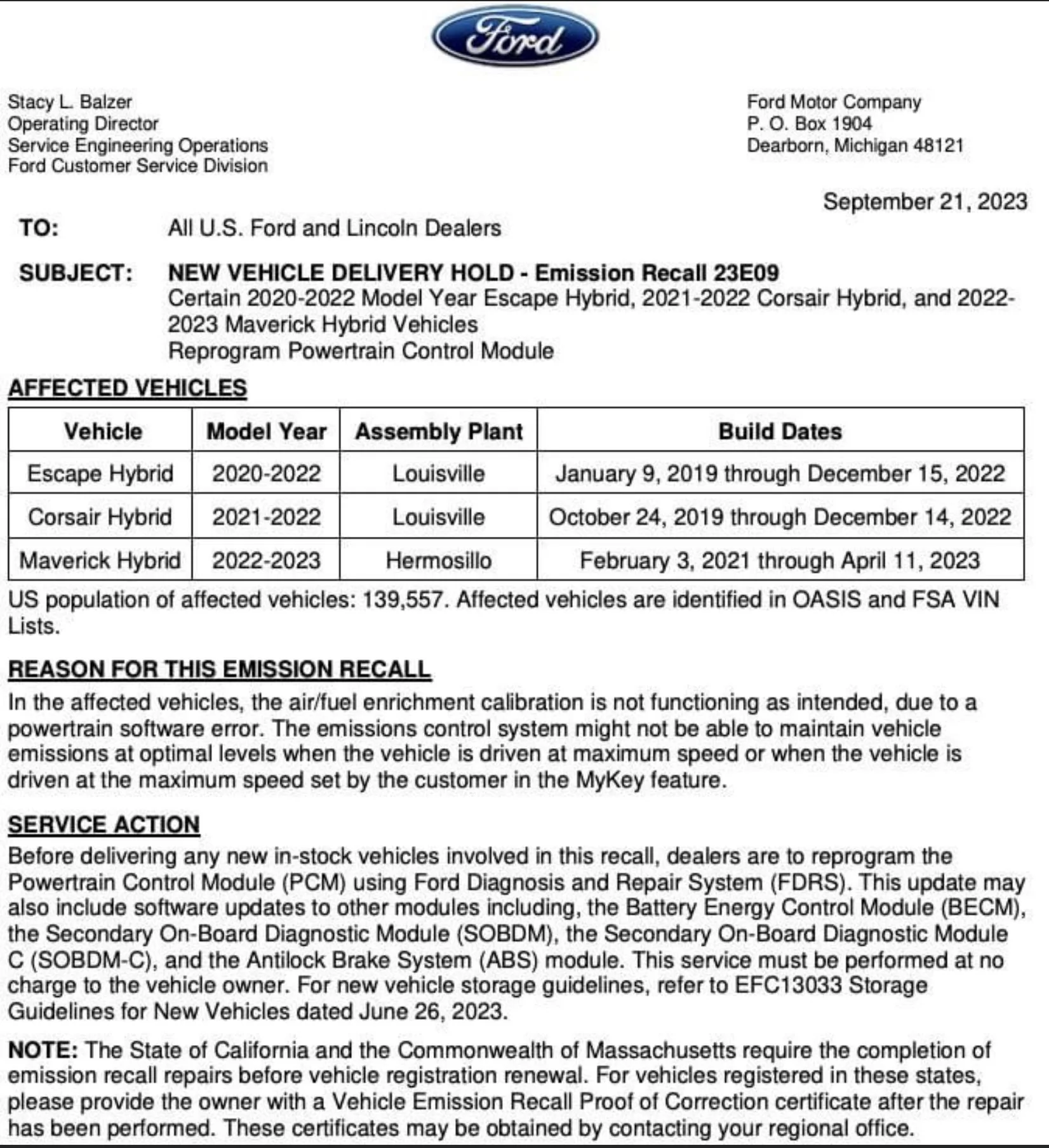

On 10/26/23 I had 23E09 power train recall done on my lariat 12v been showing 11.9-12.1v in accessory (push start button and truck goes to ready showing 14.8 before recall after recall shows 15.3-15.5) then push start button to turn ready off now in accessory. Turn off all possible 12v and dash power point monitor shows on 7th day and 270 miles at 12.8v which did not drop for 3-4 minutes. 23E09 apparently updates setting for BMS ???
That is not a battery related recall though...

23E09 updates the PCM, BECM, SOBDM, SOBDM-C, and ABS modules - it's really just a general update of various powertrain modules to the latest versions. Could definitely have an impact on charging the 12V battery, even if the BMS is untouched, though even that could be included, just not called out.
Recall 23E07 and TSBs 23-2059/2060 follow the same update procedure.
