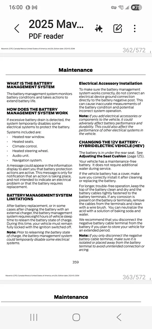

Good day @Pop2020
Have a look at your manual...I have added a page from my manual for reference. There are clear directions on changing your battery properly, resets etc.
It isnt like the old days where we could just get the biggest battery we can fit!
I and others have included our thoughts in many threads as to how to do the battery relearn (after thoroughly recharging your battery over several days using a good quality battery charger of at least 4-5 amps...FLA or AGM...new smart chargers can do both but check to make sure). Directions are included in the manual but they are a bit vague, so we just flesh out the instructions a bit.
If you want the instructions just ask. I feel we all need to properly charge our batteries and then perform a battery relearn to show the system what a good charged battery is supposed to be charged to.
