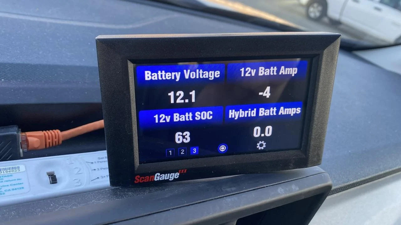

What it means is the DC/DC converter has two settings:
Low ( 13.x ) for accessory mode and
High ( 14.x ) for drive mode.
8 amps of draw was when dome light was on, when you first shut off, and when the dome lights go off the draw was 4 amps.
On 10/26/23 I had 23E09 power train recall done on my lariat 12v been showing 11.9-12.1v in accessory (push start button and truck goes to ready showing 14.8 before recall after recall shows 15.3-15.5) then push start button to turn ready off now in accessory. Turn off all possible 12v and dash power point monitor shows on 7th day and 270 miles at 12.8v which did not drop for 3-4 minutes. 23E09 apparently updates setting for BMS ???

Many
I need to clarify:
there are four possible conditions:
Key off
Key to accessory 12 volt battery only
Run without start, DC/DC on low
Started and Ready DC/DC on high.

I think these 12v batteries die by a million paper cuts, so to speak.
Replacing one will have immediate benefits. It will immediately solve issues. But for how long?
My truck is drawing 4 amps out of the truck 30 minutes after I've removed the key. It eventually turns off because the battery never goes to zero volts. Just 11.8 volts.
So it's kinda like leaving your headlamps on EVERY SINGLE DAY until the 30 min timer cuts it off.
This is unusual wear & tear on the battery, I think, contributing to short lifespan. But a guess. 🤷🏻‍♂️
Interesting regarding the 4A draw. That's exactly what the dealership measured my draw, but blamed it on my Kicker Hideaway behind the seat.
