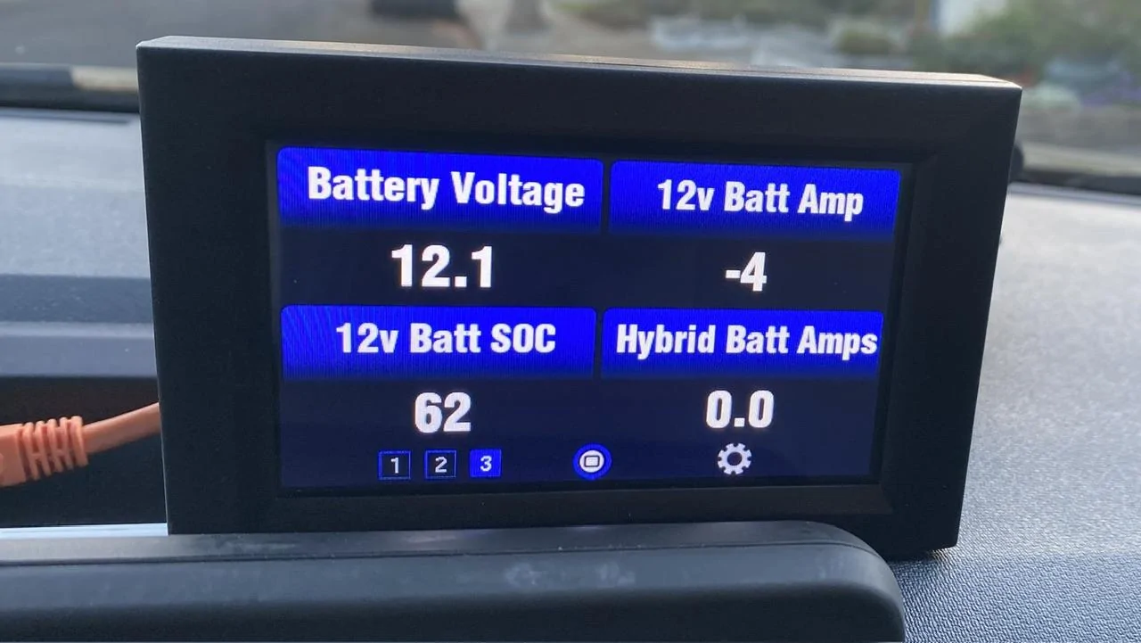

My truck is drawing 4 amps out of the truck 30 minutes after I've removed the key. It eventually turns off because the battery never goes to zero volts. Just 11.8 volts.
So it's kinda like leaving your headlamps on EVERY SINGLE DAY until the 30 min timer cuts it off.
This is unusual wear & tear on the battery, I think, contributing to short lifespan. But a guess. 🤷🏻‍♂️

What is that box you're using? I'm curious about my own Mav

Www.scangauge.com
Plug n play attachment to the OBDII data port above the driver's left knee.
Can read about 75 sensors.

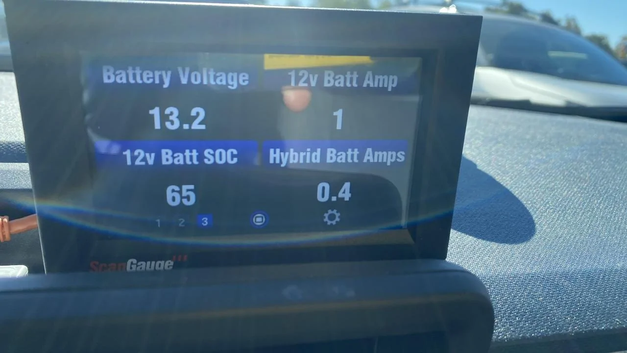

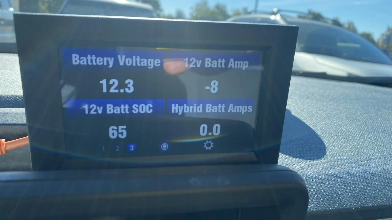

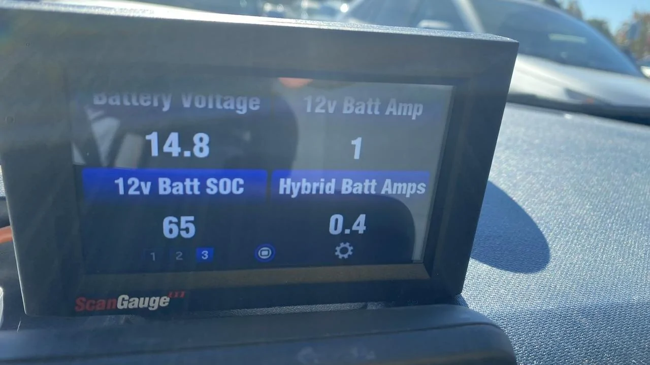

Ok, this is new TO ME because I had never done this before.
I got in, turned the key to "on" without starting. Got vastly different voltages.
ALL PHOTOS WITHIN 2-4 seconds of each other.
#1 Key to "ON" but no start:
Ford Maverick Hybrid Deep Sleep issue solved! Bad battery was my cause IMG_8536
#2 Key to "RUN" / Ready to drive:
Ford Maverick Hybrid Deep Sleep issue solved! Bad battery was my cause IMG_8538
#3 key to "OFF":
Ford Maverick Hybrid Deep Sleep issue solved! Bad battery was my cause IMG_8540

Off drawing 8amps maybe makes sense ? All systems shutting down, coolant circulation, safety systems etc ?
Probably drops after a few mins. What's odd is the key on voltage higher than off. Would this mean that after some time when they truck turns off, it actually charges the 12v a bit ?
GPSMan
Jul 28, 2022
4,325
5,340
Many
What it means is the DC/DC converter has two settings:
Low ( 13.x ) for accessory mode and
High ( 14.x ) for drive mode.
8 amps of draw was when dome light was on, when you first shut off, and when the dome lights go off the draw was 4 amps.
