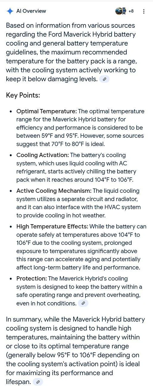

The HVB has a temp set point which routes the battery coolant through a heat exchanger which is cooled using the AC refrigerant (when the lower portion of the radiator cannot cool the battery coolant to that set point normally about 95°F-106°F). I believe the Transaxle fluid also has its separate area within this exchanger.
Ford Maverick Hybrid Battery Seemed to Stop Working on Drive Home Today chrome_screenshot_Jun 18, 2025 2_14_49 AM CDT
