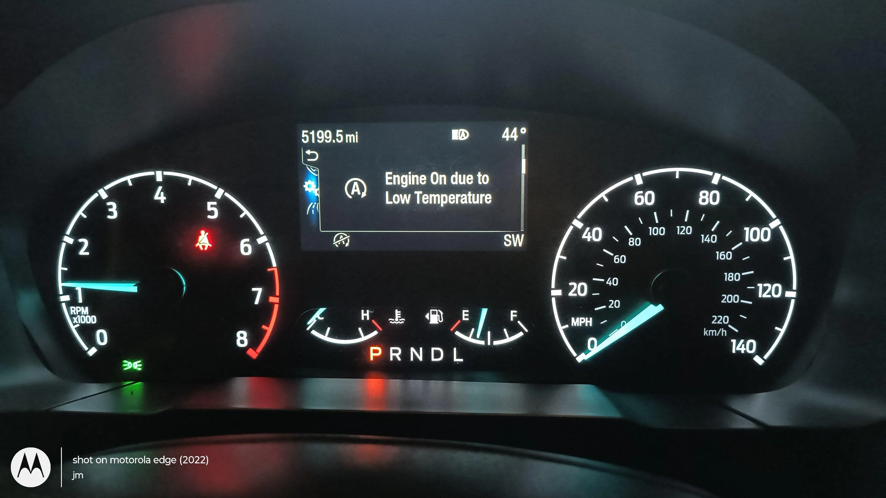

Checked this morning on my EB XL: If you go to the center screen and the Information Menu, then select AutoStartStop, the reason is displayed. Photo was taken with engine just started.
Thanks for this, had no idea i could look at this from the info screen

Scroll up to the information screen on your gauge cluster menu. One of the options in the information tab is "Auto Stop/Start". It will tell yo why it is not active. It might say Running due to low temp, or running charging. If it is giving a reason, or the reason doesn't make sense, (your temp gauge is showing normal operation temp, and the heater is not set to "inferno", then you could have it looked at. If it always says due to charging, have your battery checked, and load tested.

I’ve actually tried this and got nothing in the box. Do you need do it right when it happens or anytime after the last fail?

All I get is Normal Operation now

After 5min went to due to vehicle charging. So yea. I’ll get battery tested
