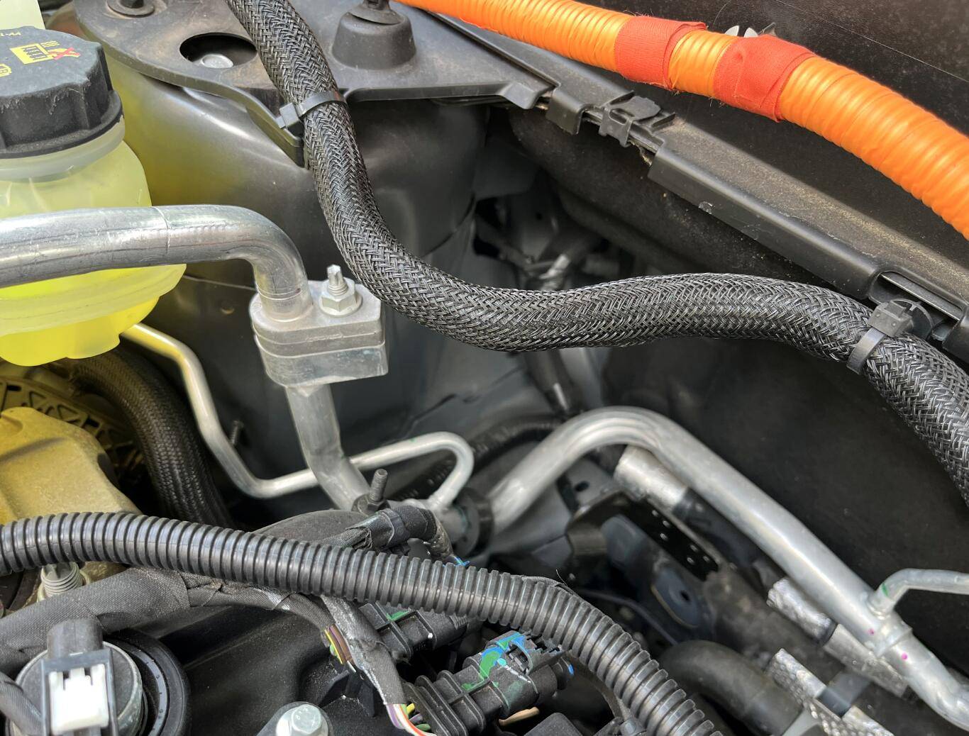

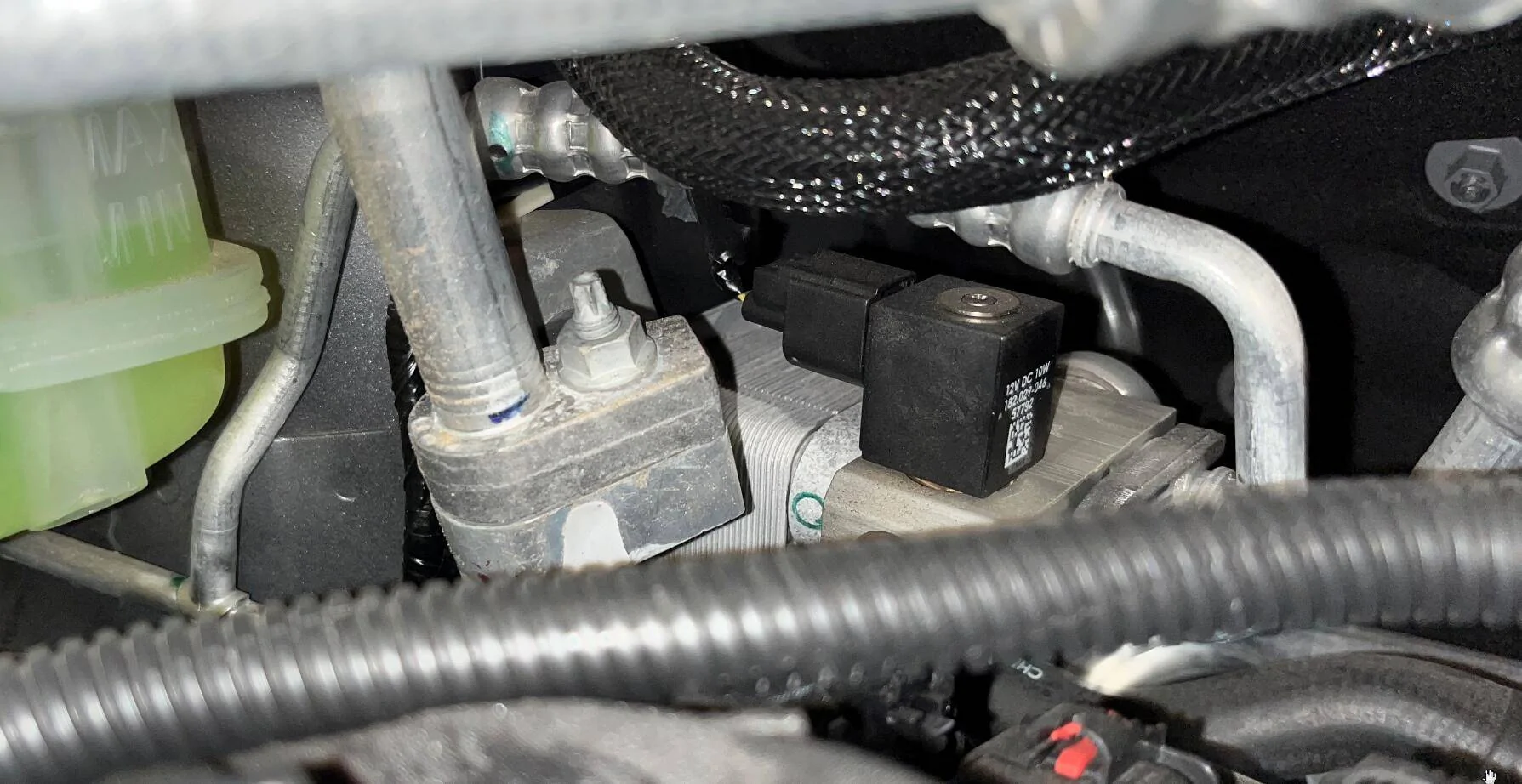

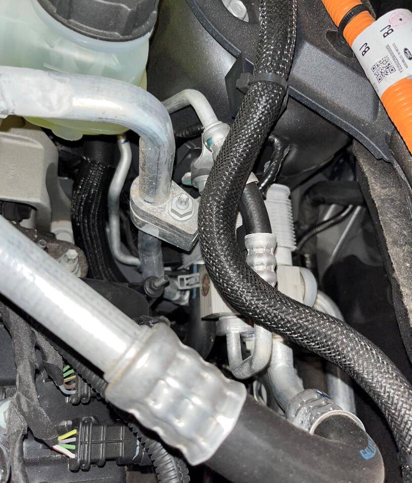

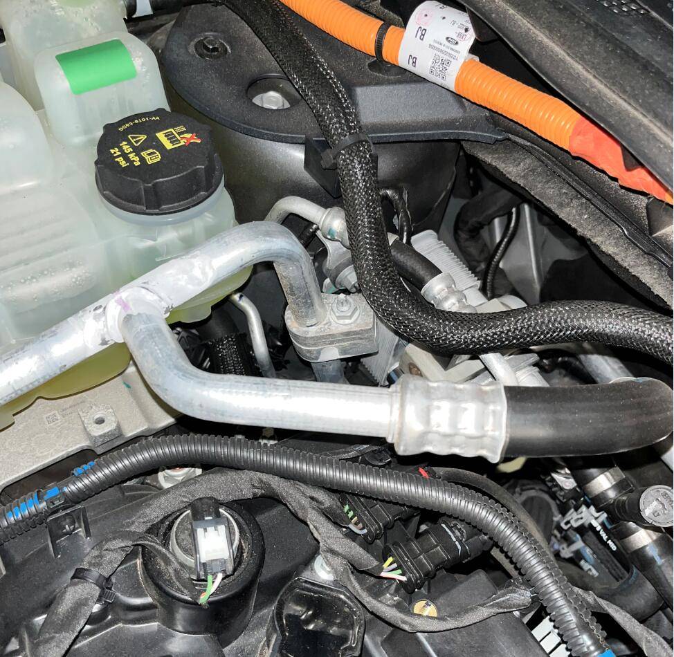

BlueSpec1
Gene
Jul 10, 2022
781
805
23 F150 XLT Powerboost, 22 Escape Plug-In, 23 Bolt EUV
My Maverick & Escape:
23 Maverick 2.5L Hybrid AC Line:
Ford Maverick Hybrid Battery Seemed to Stop Working on Drive Home Today 1750273535719-hx
22 Escape 2.5L Plug In Hybrid, High Voltage Battery Coolant Cooler (per the manual)
Ford Maverick Hybrid Battery Seemed to Stop Working on Drive Home Today 1750273577601-43
Ford Maverick Hybrid Battery Seemed to Stop Working on Drive Home Today 1750337914525-k6
Ford Maverick Hybrid Battery Seemed to Stop Working on Drive Home Today 1750273625934-t9

I'm with you but you showed a plumbing T. I agree it is evidence. Are you sure the Mav has no T somewhere else?
100% positive there is no branch refrigerant line on this truck anywhere.
MakinDoForNow
Sep 24, 2021
8,500
6,061
As I remember the exchanger was a three chamber one for the AC coolant, one for the transaxle fluid, the third for the battery coolant. Whatever proposed or built vehicle? I'm thinking it was removed for the maverick since the tech says it's not there.
Darryl
Darryl
May 9, 2025
1,611
3,611
Tallahassee Florida
2025 Maverick XLT HYBRID
I'm a tech at a Ford dealership, 1. I looked at FORD'S online repair manual. 2. I looked at the VEHICLE. I think I'd know what I'm looking at. If I didn't, I'd have no business working on vehicles. There is absolutely no connection between the battery cooling system and the AC. The lines run from the compressor to condenser, to the expansion valve, to the evaporator, back to the compressor, there are no other branches. None. There's only a connection between the two AC and battery cooling on the plug in hybrid which the Maverick does not have
Darryl
Darryl
May 9, 2025
1,611
3,611
Tallahassee Florida
It's just not there. He can ask 20 different ways, and it still won't be there😅
The Real Maverick
Jack
Jan 13, 2024
2,999
4,145
Thanks for confirming my hunch.
While 2022 Service Manuals showed it in a Maverick, it was a mis-print or copy & paste mistake.
Like I said. I've never seen evidence of active cooling via OBDII but never traced the lines in my truck. Always wanted to, just never got around to it.
