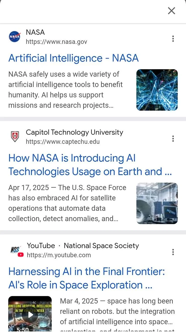

Hell NASA is using AI. NASA has even partnered with Google Technologies for AI since 2017.
AI collect hopefully related sources, which is actually keyed at the bottom of the statements.
At this point in time AI is not the end all be all, but it's on its it's way.
https://www.captechu.edu/blog/how-nasa-is-using-and-advancing-ai-on-earth-and-in-space-exploration
That AI stuff will never catch on 😂😂😂 I guess someone should tell NASA.
