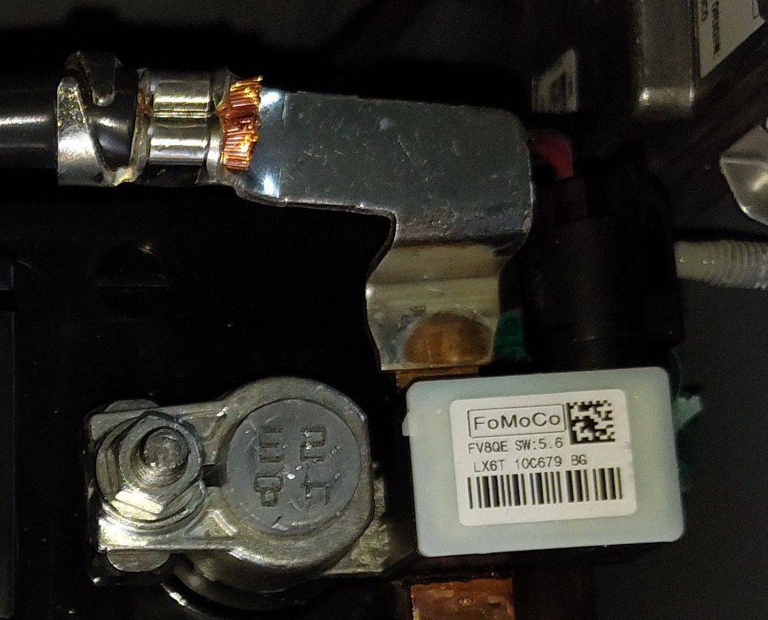

I put my battery on the tender, took 1.5 days for full charge… reset the battery monitoring, and reconnected negative cable to battery.
worked one day.
I will be jumping it to take to the dealer and leave it until it’s fixed. They say they are full for 2-3 weeks.
as soon as it’s fixed, along with the stupid parking brake failure, it’s being sold.
Was that literally the order done?
Reset BMS sequence, and then reconnect negative terminal with attached BMS?

I can't imagine that being good for the settings.
But indeed - sounds like bad battery anyway. At least a new battery to include in the sale!
This order:
1) disconnected neg terminal,
2) charged battery,
3) once fully charged, reconnected negative terminal,
4) did the bms reset,
5) started it up.
Parking brake failure still an issue. All lights worked. Drove to work with no issues. It sat at work all day, then when I got in at 5pm, all lights worked. Drove home, parked it in the driveway. Next morning it was dead as a Chinese doornail.
