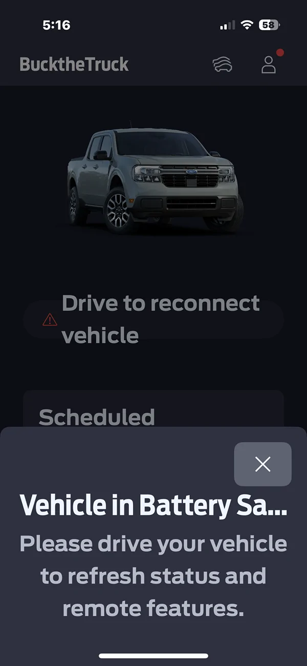

My ‘23 Lariat Hybrid had 24 FordPass Battery saver alerts over about 40 days.
Never fails to start but just an annoyance. Finally hooked it up to the NOCO charger overnight and no problems for two weeks.
I drove on the freeway to my dealer about 10 miles away for routine maint. visit and had them check the battery. No issues reported and then drove home again on freeway. Next day was in BSM again.
Everyone has different driving habits and BSM issues for vehicles not driven often is obviously common. It comes down to how much you are willing to put up with before taking matters into your own hands and replace the battery for AGM and re program the BMI using ForScan. I am at that point now having complained to two dealers several times and gotten no help.
