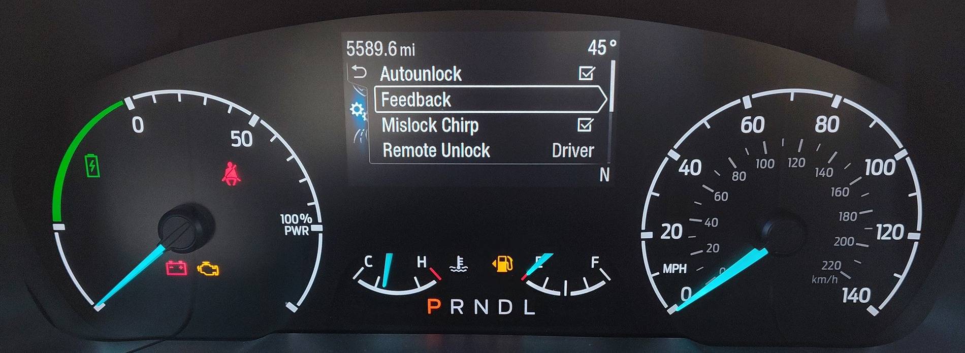

After recall for taillights I had this extra option added - Feedback. Or I didn't notice it before.
I can't find it in the online manual either. Disabled there is no honk on double-lock. And chirp can still happen when you need it on mislock.

Here’s what is up with my 2024 Hybrid.
1) Mislock is definitely off
2) press fob lock twice - beep & lights flash
3) hood open, press fob twice - nothing
Seems to me Mislock off only eliminates the beep when something is open.
Otherwise pressing twice gives the beep. Just went through those steps.
With your year/trim may have different results. I just wanted to be able to double lock to minimally reduce 12v drain without the annoying beep. And I’d rather not leave a door, hood or tailgate open.
I'm thinking the pre-24's have a mistake since many have reported disabling that mislock honk/chirp and it's disabled when they double-press.
Mine's XLT with latest BCM updated after taillight recall.
Do you have that setting on Lariat I showed in pic?
That's stopped my honk.
Can’t look right now to confirm it’s exactly the same, but definitely similar. And I unchecked the mislock.
