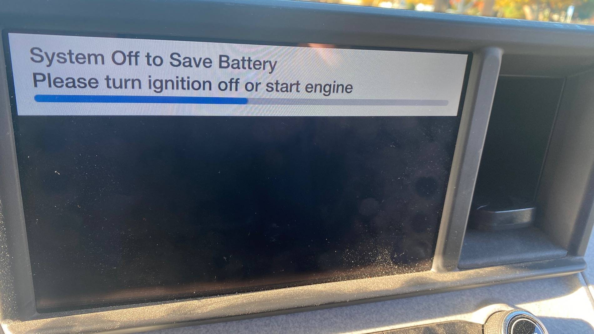

Your battery is sulphated, thanks to the BMS misprogramming that stops it from ever being fully charged. Flooded batteries need to sit at 95% charge or better to maximize their life. If all you have is a multimeter, that should look like 12.6-13.2V when parked overnight. Don't check it until it has been sitting for at least overnight, to leak off the surface charge. Checking the voltage is not the correct way to test a battery for the charge that it can hold, and the dealer should be using the correct battery tester instead. I guarantee that it would fail a normal load test. Your dealer needs to replace the battery (is it still under the 36mo warranty?), as it is now ruined.
The claim has been made that Ford is working on a software fix for this problem, due out sometime in 1Q2025. Meanwhile, keep getting new batteries. Mine lasted 13 months since manufacture, and yours is probably at 10-11 months including shipping time to the dealer.
If your dealer can't admit that the battery is damaged, get the Ford rep involved, and possibly move to a better dealer who actually trains their mechanics properly.

I have this issue from new with my 2023. I did not drive it much the first few months and thought that was the issue. When i took it to the dealer they said there is no issue.. I have drive the truck 30 miles and parked it, an hour later i get the deep sleep mode message. I hate no dome light.
I checked my app and do not see a recall for the issue. Is there a recall/ fix?

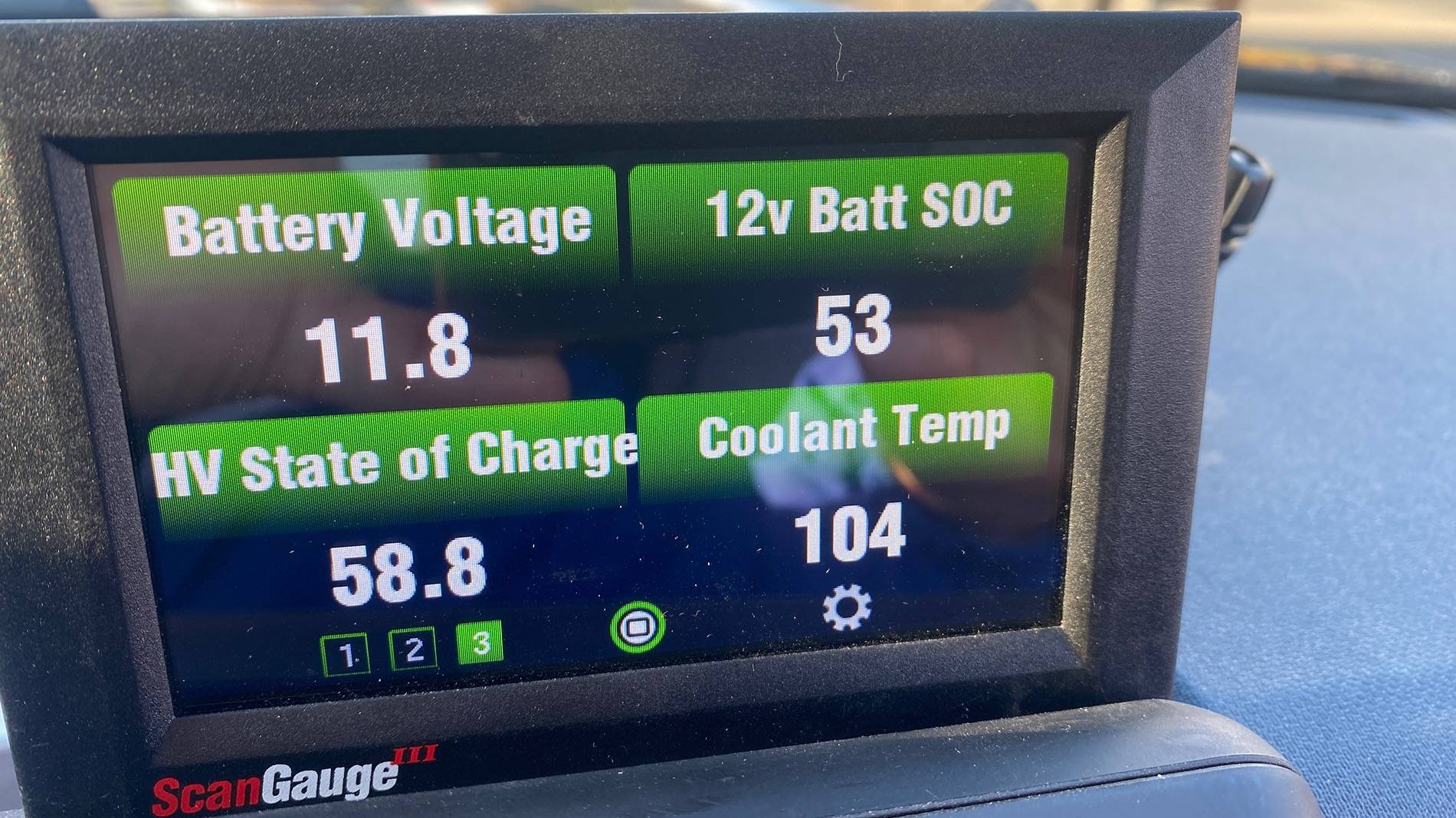

Just had my 8 month old XLT Hybrid at the dealer regarding continual App message. Truck in Battery Saver mode. Please drive to refresh. Checked battery voltage and it is at 11.82 volts and dropping each week. Dealer reset BMS and said the battery is good. Got home and 3 hours later got the message again. Called dealer and they said nothing they could do ford Engineers working on a fix. I'll just have to get used to no Dome light, heat or AC at times and no remote start, until there is a fix. I asked , what happens when the battery goes dead. Do I have to replace it. He said I don't know. This has been going on for more than 2 months First every so often to now, every day. No matter how much I drive! Good luck all of you with this problem. I think I'm done with EV's of any kind.
23 days after Ford replaced with a new battery the same crap is happening again. This is so damn frustrating!

That, in itself, will not permanently solve your problem. Hopefully, Ford's fix will be here before your problems return. Mine have taken a year without Ford Pass and fuse eleven pulled, to manifest. Now I'm having to charge the battery due to no lights on entry. Volts measured upon entry almost always below 11.9 , sometimes as low as 11.3.
