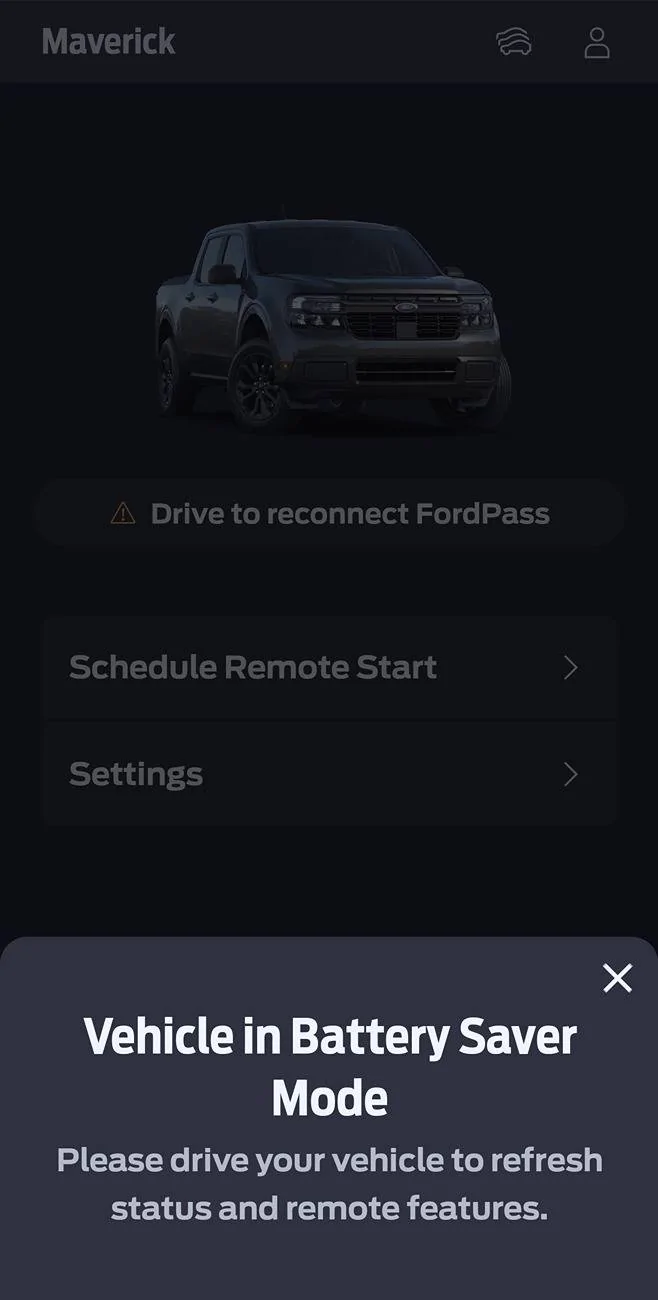

Just thought I would post this to get some feedback. So, I just got back from the dealership for an oil change for my '24 Maverick (Lariat). I then updated the software for the Ford Pass in the vehicle (not the app). A few minutes later I received a notification about the battery going to Save Mode. I don't know why when I have driven the vehicle every day for work and just drove to the dealership this morning. Now mind you I usually don't get the Battery Save Mode notification unless I have not driven the vehicle for at least a couple days.
Ford Maverick Vehicle in Battery Save Mode Screenshot

turn off your wifi and auto update in the radio setting and that should at least stopping the battery drainage. I just had my software update and that left these features on and I got a complete battery drain that required a jump. Turn off these features seemed to prevent this issue for me.
