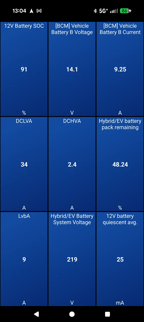

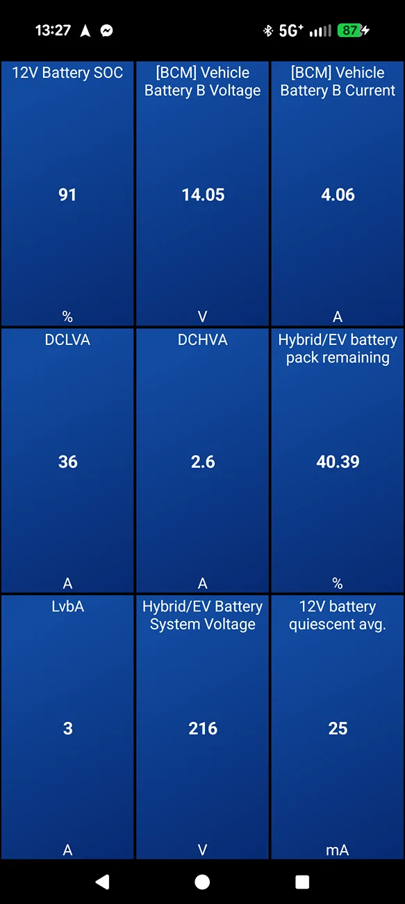

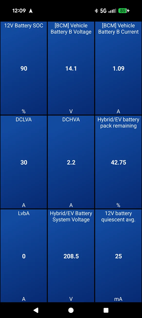

Ok here are the results from driving the 25 Fwd Hybrid today, and it's actually quite interesting to me, but also weird too!
So I have noticed from SOC 83-91% the truck will show battery at 14+ volts

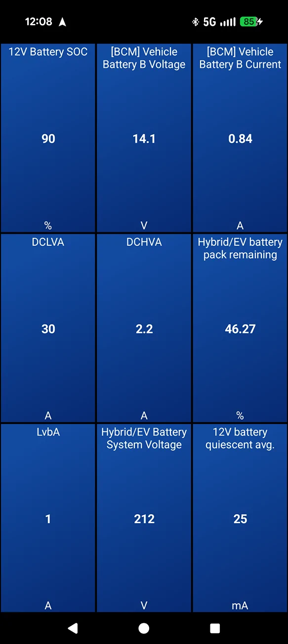

I found two places LvbA and Vehicle B Battery Current that both appear to show the amps the battery is being charged at. The B one shows two decimal places while the LvbA shows only a rounded up version. (Which is why I think MM only saw it at 1 yesterday on all my snapshots, and I believe he's right it's just trickle charging)
I did notice that every time I started the vehicle these values were between 6-10 amps, but would rapidly drop down to 1-3 amps within about 5 minutes or less. (My battery SOC all day today was between 89-92%).
I noticed that while SOC is 83-91% the truck will not ramp up the charge from 1-3 amps no matter what you do, parking lights, headlights, fan on 6 or 7, or any combination of the 3. (I don't have a trailer tail light plug to test that right now).

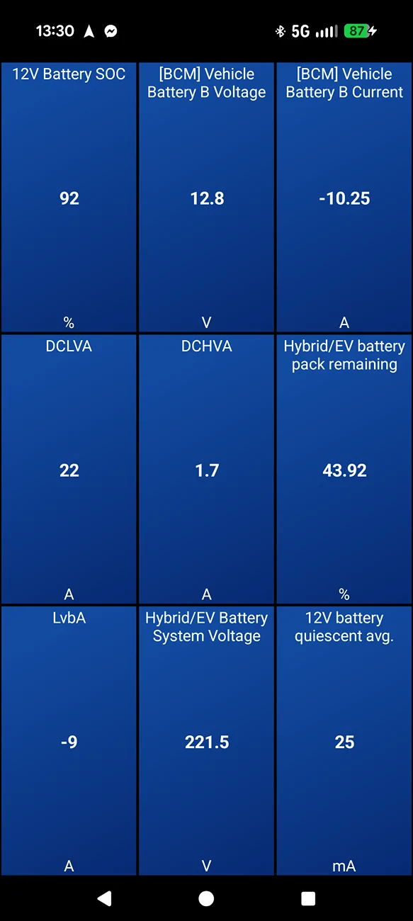

Now here is when it gets crazy to me! When the truck hits SOC of 92% the truck actually appears to start discharging the battery! The amps go into the negative numbers, and the battery drops to 12.8 volts.
It's at this time I decided let's try the headlights, and wouldn't you know it bam! The volts go back to 14.1-14.2 the Amps jump up to 5-6 and it appears that the truck is charging the battery again. I never saw the truck go above 92% SOC but I only drove about 10 miles while this happened. If I did the parking lights, headlights, or fan at 6 or 7 the truck would keep at 14+ volts and 5-6 amps. (Judging by my calculations if the amps stayed at 5-6 the battery would have been at 100% in about an hour or so like MM has stated in some of his posts).
When I got back in the truck an hour later the truck SOC at 91% the amps stayed 4-5 and this was a first time that I have seen that happen so far. I only did 3 short trips of about 5 miles each, but each time the amps stayed at 4-5.
So I don't know what to test next, or how to test next, any suggestions on where to go from here?

@rslilly76
Sounds like your 2025 is behaving the same as my 2022.
Took me a long time and a lot of watching carefully to notice:
Voltage can be high 14's and you still get little to no recharging because the current (amps) were being held back to almost nil.
If I didn't see it I would not have believed it.
Cigarette plug volt meters and OBDII volt meters don't tell you health of the 12v battery! (Because it's a false reading coming from fhe DC/DC downconverter.)
Old paradigms die hard!
